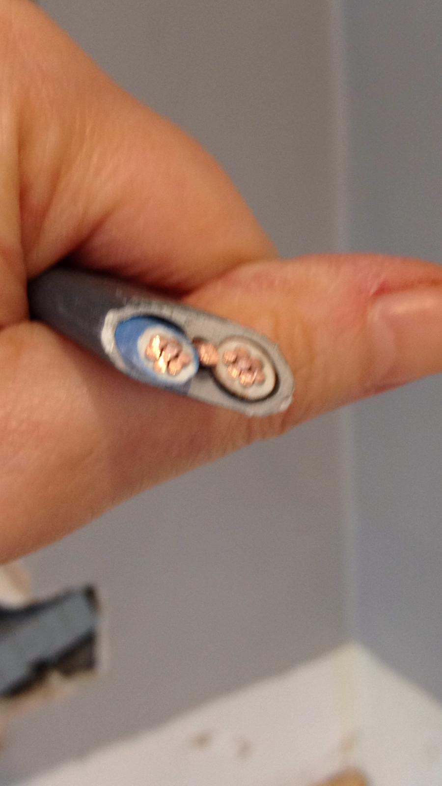

My electrician has run twin core cable up to the connection points (can’t see the earth) and wants to put a 13A plug and socket to hook them up.
He says this will be fine and while I’m sure 14.5A probably won’t blow the fuse I’m a bit worried in terms of warranty and home insurance as I can’t afford to replace them.
Should I insist they be hardwired?
show us a photo please
My mistake it does have a small earth cable.
Here’s a (bad) photo.
That's 10mm T&E isn't it? A bit overkill for a plug and socket!
