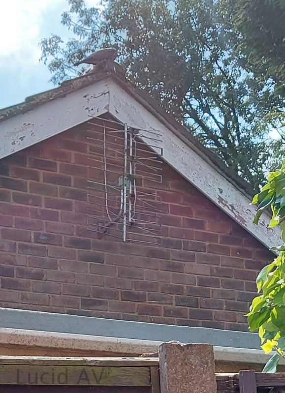

The flat design suggests that it's a grid aerial. The size of the fancy plastic cover they've put it inside means it's smaller than a standard grid. In basic terms smaller aerials gather less signal.
Here's a grid aerial on my next door neighbour's rather tired property. You can see the pigeon there for scale.

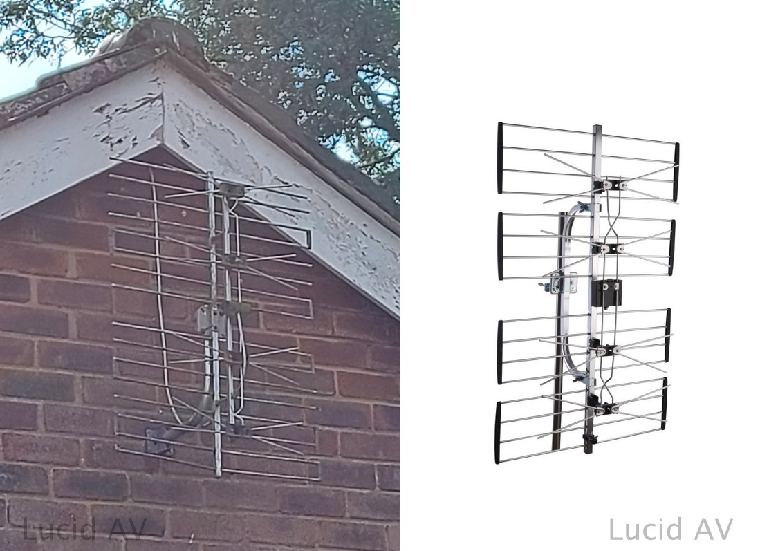

Here's a close shot of the same aerial (minus the pigeon) and I've added a marketing image of a grid so you can better see the layout. The designs are slightly different but the basic principle of operation is the same.
Grids were never that common a sight. However, in the days of analogue TV, grids were useful in cutting down the incidence of ghosting from the aerial receiving reflections of the same transmitter signal bounced off buildings which resulted in time delays causing ghosting. We don't need that so much now. Digital TV is far less prone to this.
The Achilles Heel with grids is that with so few receiving elements (the four metal crosses are the dipoles that do the reception work) these aerials are very low gain and not particularly directional either. This means they're not great compared to a standard aerial such as a Yagi or one of the newer Logs. They're going to struggle a bit in weak signal areas.
In my neighbours case, he stopped using the grid aerial more than 10 years ago. Although we are about 30 miles from the 100,000W Winter Hill transmitter, the local reception conditions here are very good., yet he can't get a reliable service off it.
