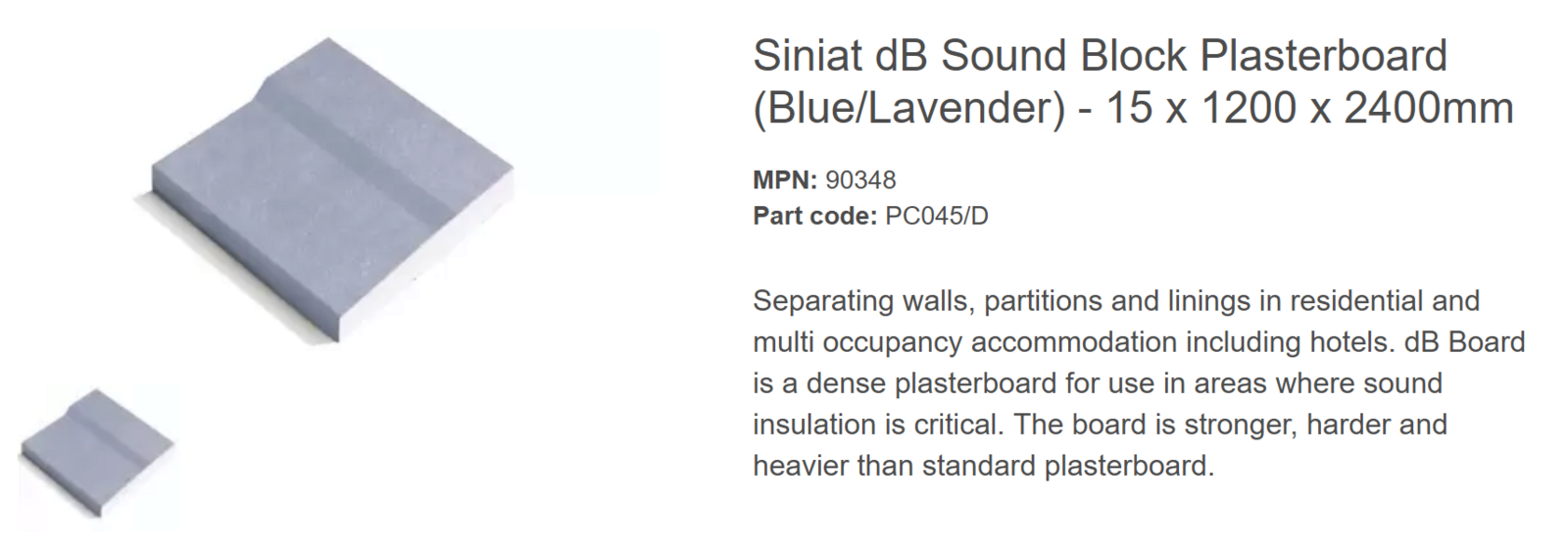

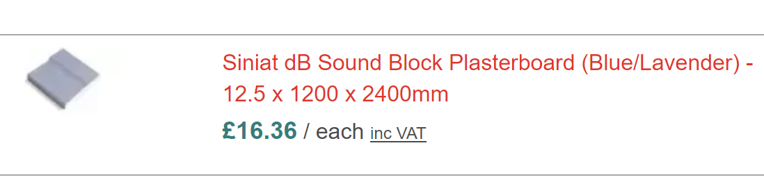

This particular plasterboard is available in 15mm which will give better soundproofing.
You'll need big arms though as it's about 37kg a sheet!

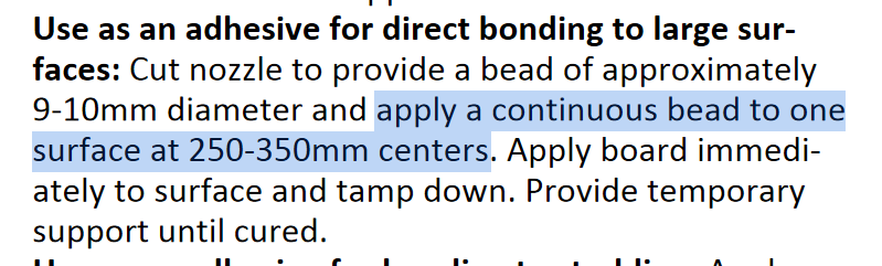

I don't suppose you could help me figure out the following bit from the AC50 manual:
What application pattern do they mean? Where would the bead start and what are the centers the manual is referring to? I've googled it and couldn't find any drawings.
The manual goes on to say that "Highly porous substrates such as new plaster should first be primed with Everbuild PVA bond diluted 1:4 with wa-
ter.
But this woulnd't apply to an existing painted plasterboard, would it?
