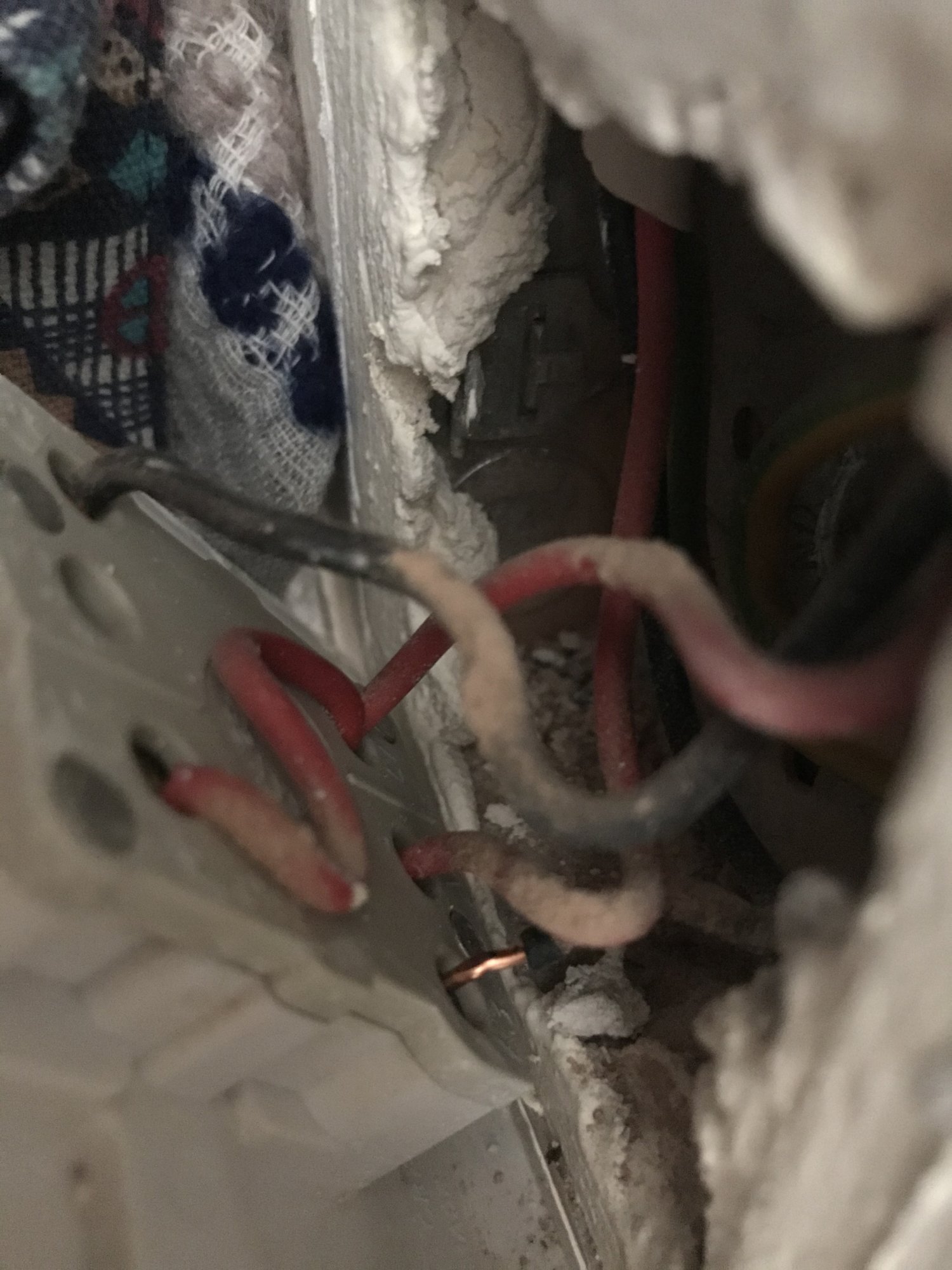

Hello,[GALLERY=media, 103478]45CBF894-86A4-4DC4-9743-360AA099D9F3 by CovBoy posted 2 Nov 2019 at 12:36 PM[/GALLERY]

I have just started the job and it seems I have assumed wrong.
Removing the spare switch upstairs has revealed lots of additional wires (see pic) including a loose black one.
Removing the switch downstairs revealed wiring in place for a double switch, albeit the black wire for the upstairs light had become disconnected. I’ve put that back in and down both sides of the downstairs switch function.
I have 2 questions....
1. Is the state of the upstairs light safe, and what should I do with all the spare wires?
Ok. Well, three wires is normal.
It looks as if the black is spare. Terminate it in a connector block and leave separate.
You need to put the black in a bit farther so there is no copper showing.
Looks alright. What do you mean "all"? You only have one spare wire. Terminate it in a connector block and leave separate.

I purchased a 1 gang 2 way 400w dimmer switch before I realised it was a two-way circuit.
Will do, thank you.
Already done. I took that picture before the fix mentioned in the OP.
There are green/yellow danglers too.

Are the earth wires connected?
Those are wooden back boxes, so I suspect there might not be earth continuity to the fittings and switches. I can see you have a metal switch box downstairs, so mayb e not all of them are made of wood.
Are any of the switches and light fittings metal?
Also, it looks like you may a lighting wiring system called borrowed neutrals, which is not ideal.
It might be alright.
Although from downstairs it will only come on at whatever level the dimmer is set.
