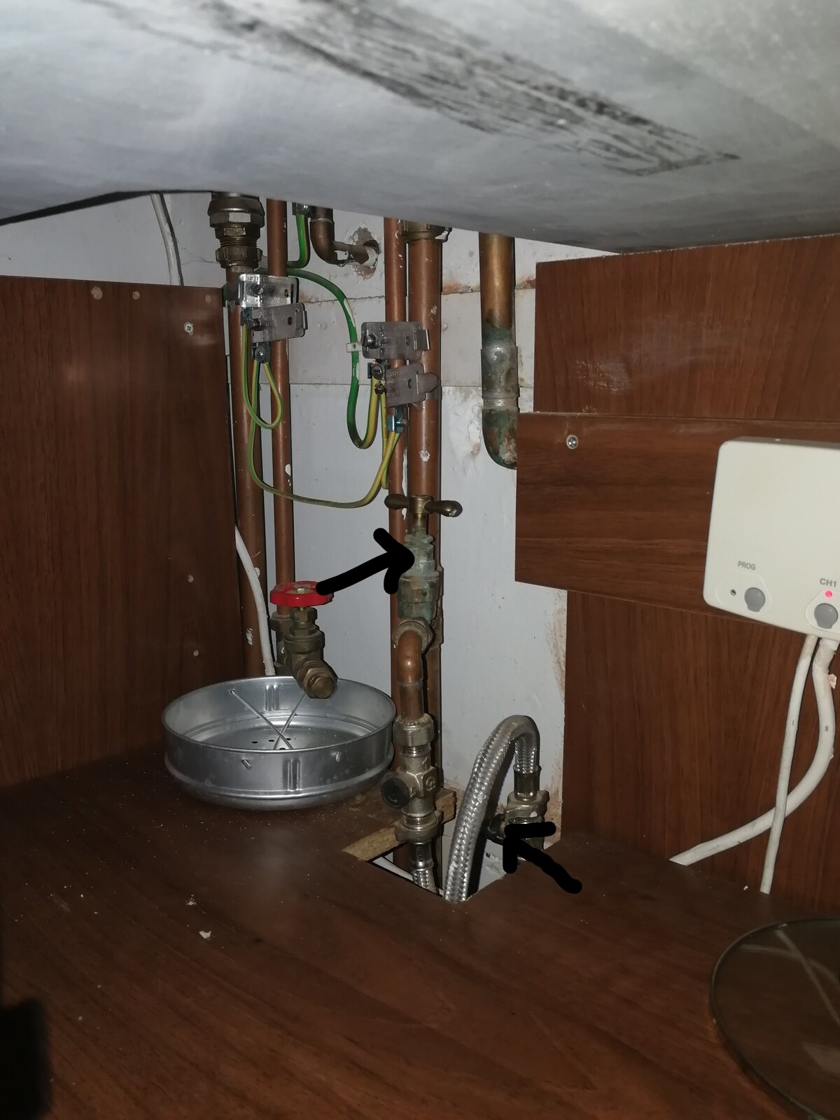

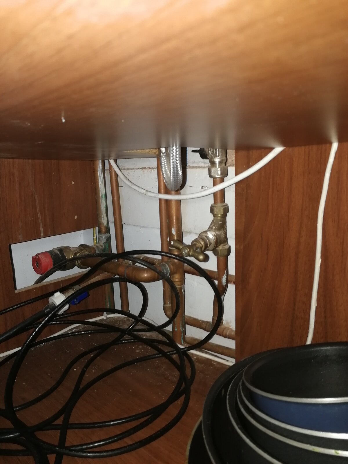

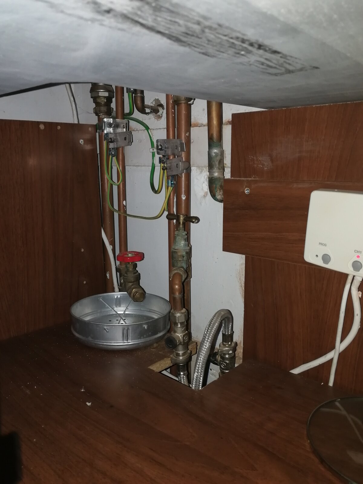

Hello, I have a Valliant 182e boiler which I need to top up with water as pressure is too low. I cannot find the 2 valves on the filling loop though. Maybe there's another way to do this, but I am afraid to break something. These photos show the pipes bottom to top. Please help!
Only one valve to open ,on the right hand side of your pic is the braided ,flexible ,hose with a black lever
( Partially obscured) that's what you turn.
Sorry terryplumb, nothing happens...
As said above the other tap may be closed ,so open that anticlockwise.
I tried ever combination, clockwise or anticlockwise, lever horizontal and vertical. No chance
The black lever may be cracked( common problem) and not turning the spindle below it . Remove the lever and examine ,spindle can be turned with a spanner.
It's stiff as hell. There's a screw in the middle. Does it need to be loosened? I am kind of scared of flooding the flat :unsure:
No don't touch the screw ,turning the handle anti clockwise opens it.
