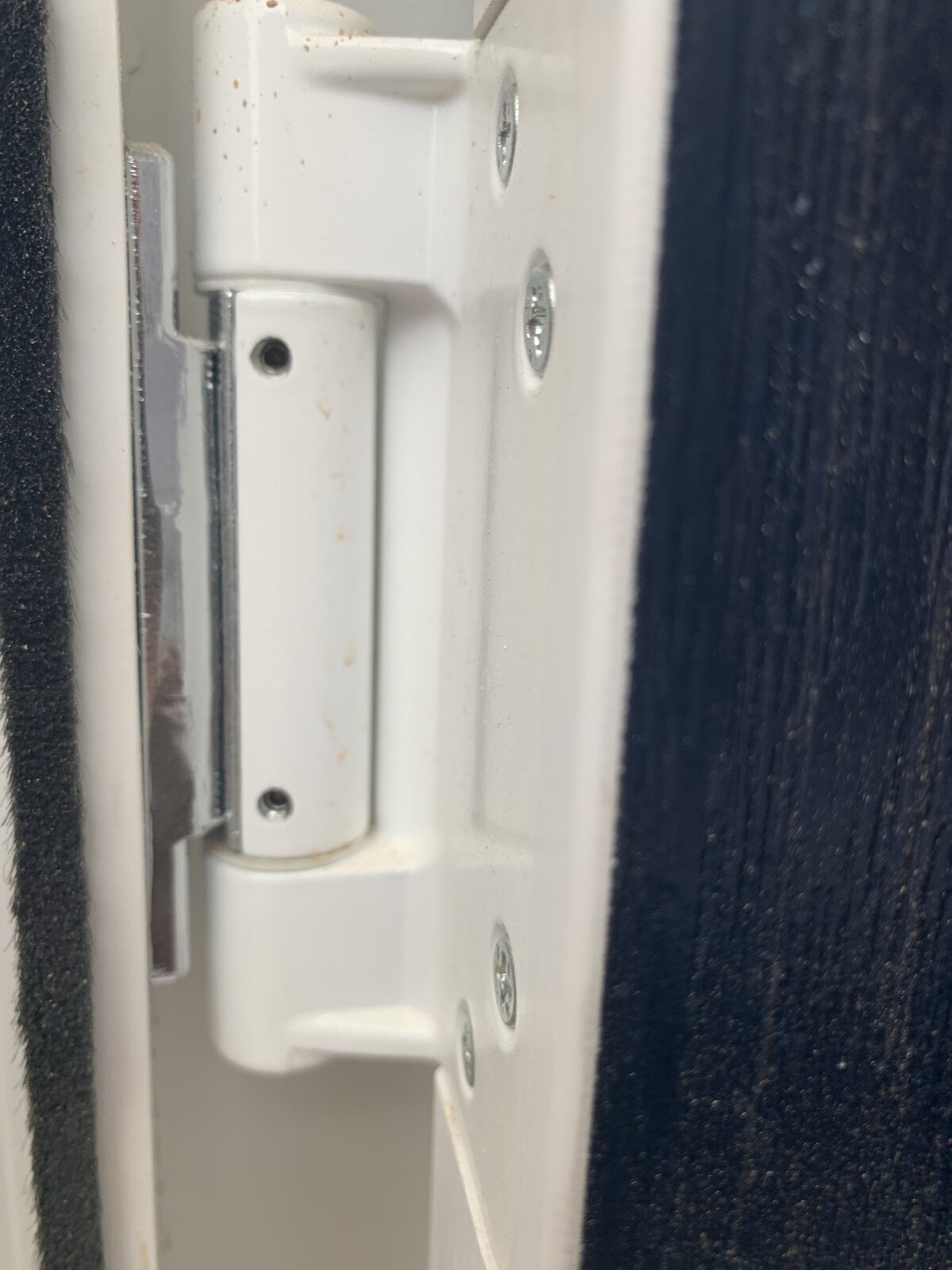

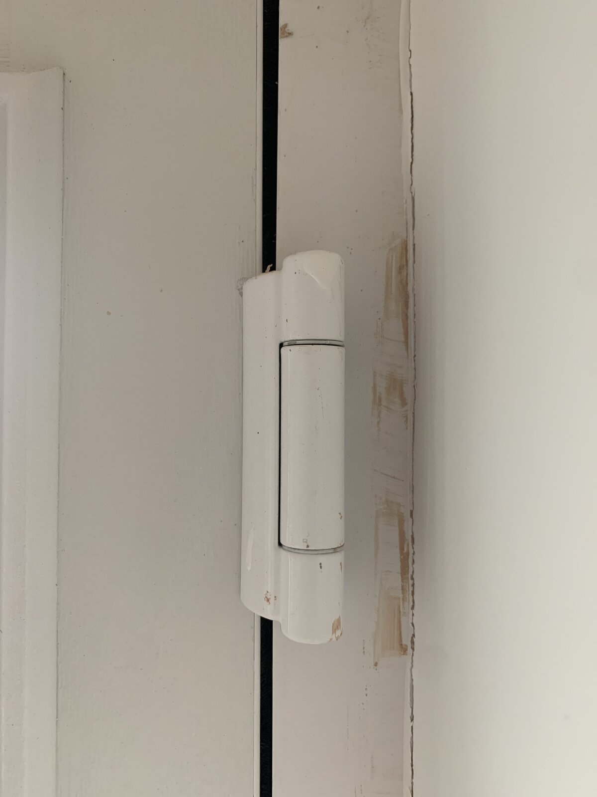

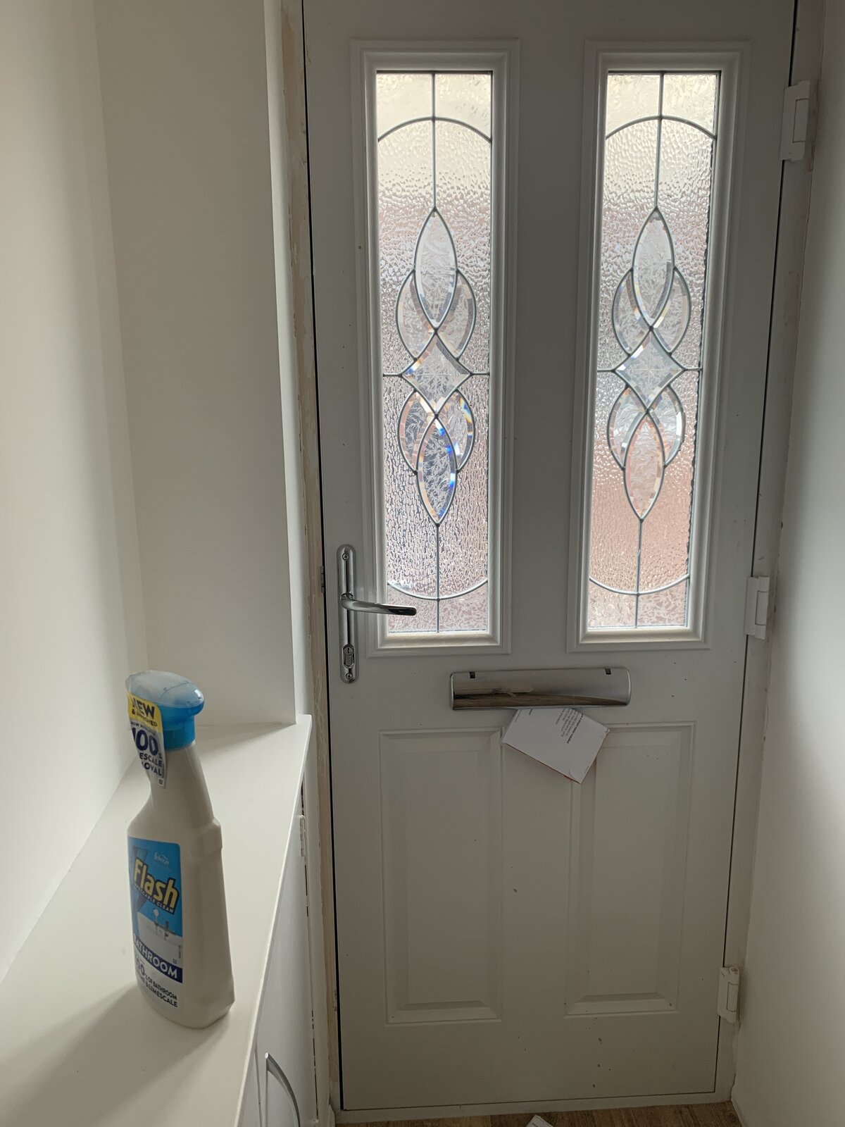

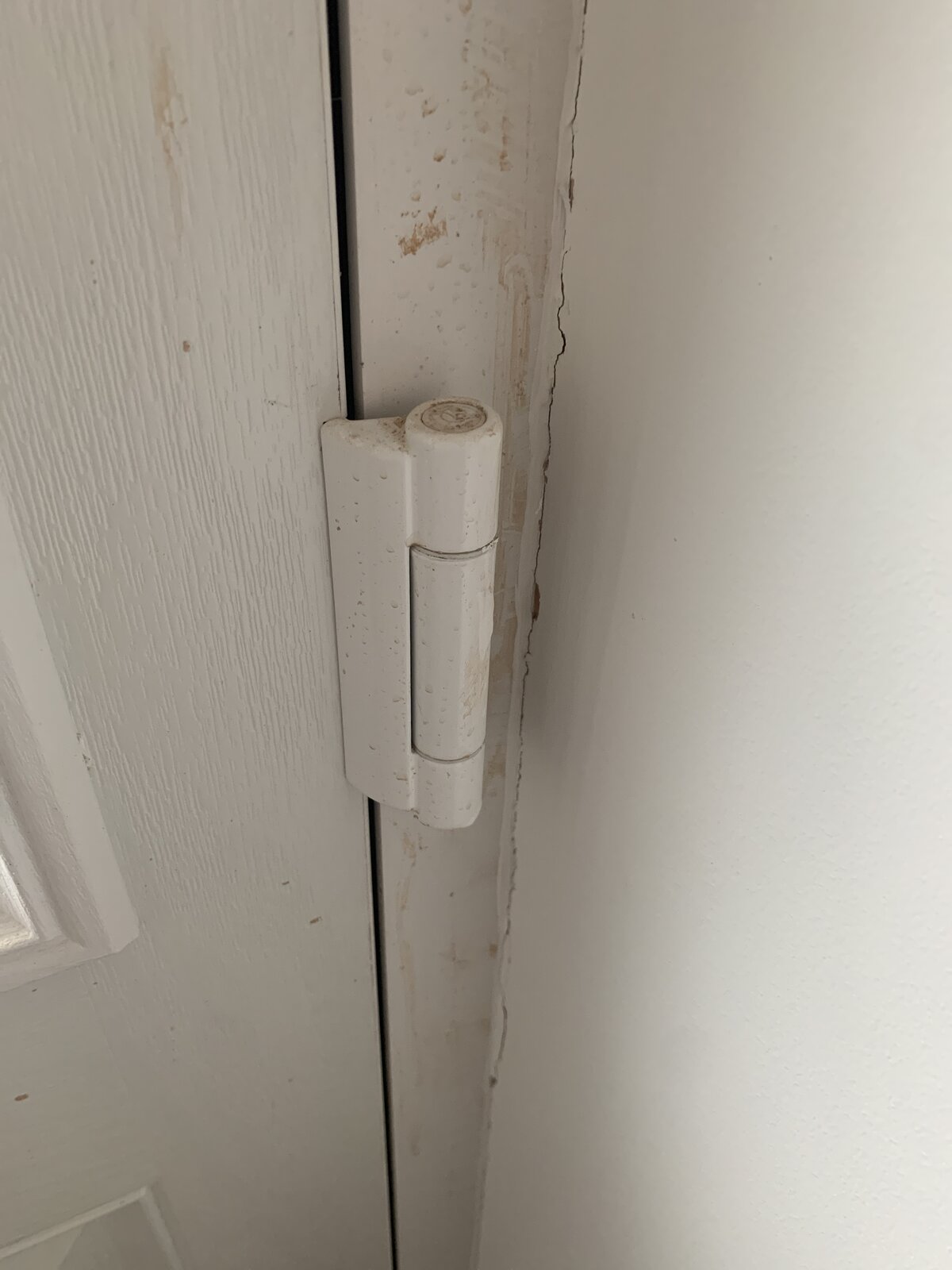

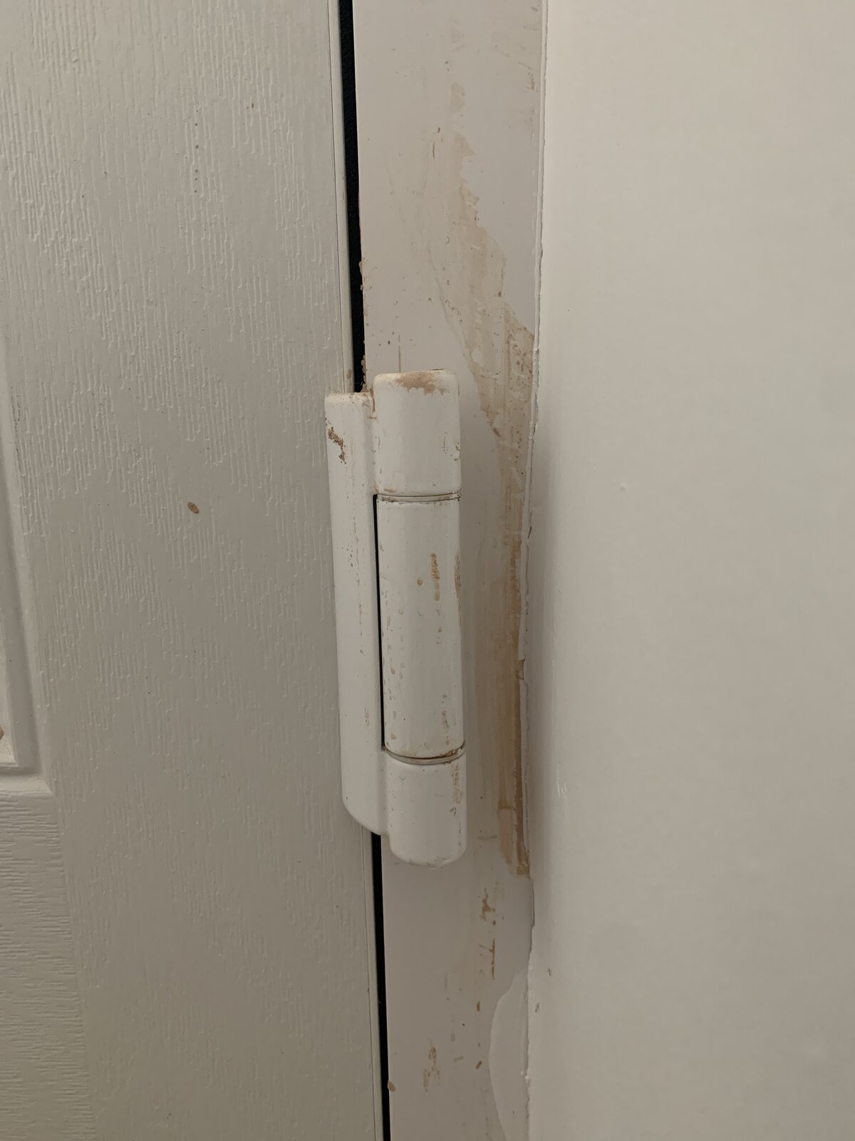

Yanni Joined 30 Apr 2008 Messages 278 Reaction score 9 Location Manchester Country 23 Jun 2023 #1 How do you adjust these hinges on this composite door. The door has slightly tilted and needs force to close as it catches up on the metal hardware of the frame. I need to Tilt it up. Attachments image.jpg 184.5 KB · Views: 97 image.jpg 114.9 KB · Views: 89 image.jpg 178.7 KB · Views: 91 image.jpg 122.2 KB · Views: 86 image.jpg 83.4 KB · Views: 86

O opps Joined 16 Jun 2006 Messages 10,632 Reaction score 2,366 Location London Country 23 Jun 2023 #2 I may well be wrong... I believe that you need Allen keys in the top and bottom of each hinge (individually). I suspect that someone like @crank39 might be able to help you

C crank39 Joined 1 Dec 2009 Messages 5,851 Reaction score 1,334 Location Nationwide Country 23 Jun 2023 #3 Trojan Athena hinges, I suspect you just have the 2D version but there is a 3D version too, watch this video for pointers
