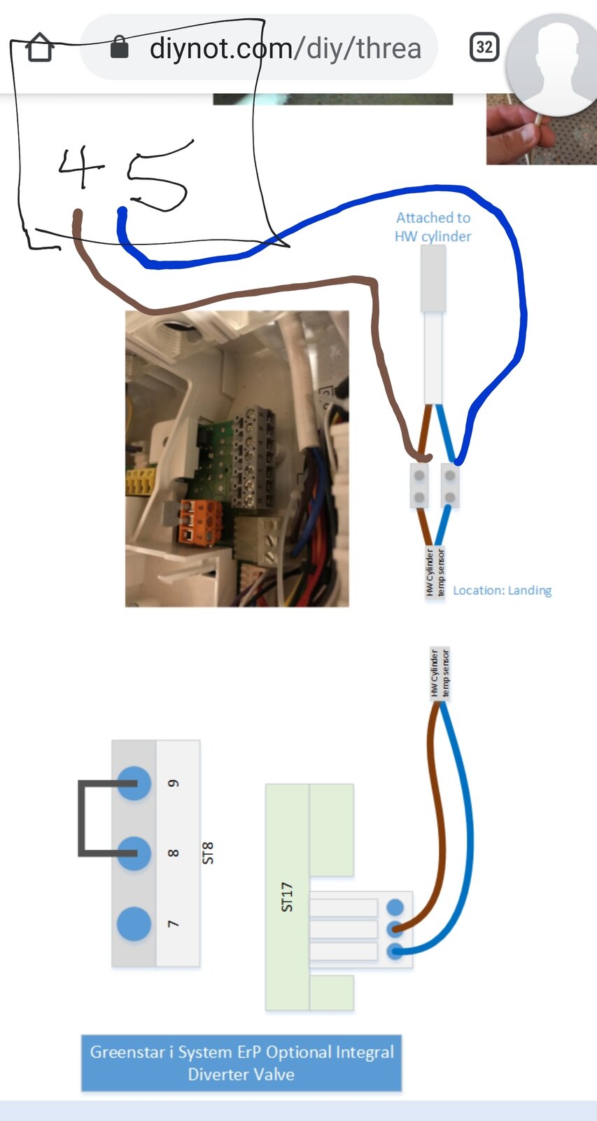

You'd be better off keeping the cylinder sensor. You can wire it in parallel with terminals 4 & 5 on the Heat Link to provide time control of the hot water (DO NOT link the mains Live to 5).
Your description of the heating side is correct
Thanks for your reply Muggles, so you what you are saying is, its not worth adding the HW thermostat and I should just do the following and keep my existing HW compoents?
1. Turn off boiler
2. Switched off power to boiler
3. Looking at the boiler, amend wire configuration as per below:
a. ST10:Lr – remove wire and move to Nest:T1
b. ST10:Lr – connect new wire to Nest:3
c. ST10:Ls – remove wire and move to Nest:T2
d. ST10:Ls – connect new wire to Nest:2
e. ST17:brown - connect to new wire to Nest:4
f. ST17:blue - connect to new wire to Nest:5​
4. Looking at the Nest Heatlink, amend wire configuration as per below:
a. Nest:N – connect mains N
b. Nest:L – connect mains L
c. Nest:E – connect mains E​
5. Looking at the Nest Heatlink, confirm the wire configuration as per below:
N: from mains N
L: from mains L
1: N/A
2: from ST10:Lr
3: from ST10:Ls
4: from ST17:brown
5: from ST17:blue
6: N/A
OT1: N/A
OT2: N/A
Earth: from mains E
T1: from old room stat (black)
T2: from old room stat (red)​
6. Remove DT20 timer from boiler and insert blanking plate
7. Switch on power to boiler
8. Turn on boiler
9. Configure Nest and confirm Heating & Hot Water
Yep, you've got it. You might need to insert a link somewhere to provide continuity once the DT20 is removed, but you'll soon know if it doesn't work without one!

Hi Guys,
Just finished installing the Nest and my system boiler is flashing a blue light and displaying the code "Ad"?
The nest is connected OK and I am calling for heat and the radiators are getting hot.
Cheers
James
You might have discovered a new code there, don't think that's in the book :LOL: is your cylinder heating OK?
Its all sorted now... :)
As soon as I told the Nest I wanted to control the Hot water, that code went away and the temperature was then displayed on the boiler :D.
For others that have this issue, I did the following on the Nest dial:
1. Settings
2. Equipment
3. Pro setup
4. System Boiler
5. Hot Water, switch to On/Off.
6. Done.

Just came back from a walk and the error message has re-appeared :-(
If I turn the hot water on via Nest, the error message goes away and the boiler status is normal.
If I just have the heating on, the error message appears.
I can't leave the hot water on all the time, as it takes piority over the heating.
I am safe to leave the message on the boiler as I know it works or do I need to change the wiring?
