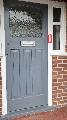

Novice here and would appreciate any advice, please.
I need to drill a hole for a mains adapter for a video doorbell and would ideally like to make the hole within the red square on the jamb in the pic. I would really appreciate advice on whether this is a sensible idea and what kind of drill might be needed.
Thanks in advance!

Should be ok as it appears to be wood, use a wood or hss steel bit. You can clamp sacrificial pieces of timber where the drill bit emerges to reduce tear out. If you don't own a cordless drill this is the ideal opportunity to get one.
Blup
General tips for drilling holes in wall-like things between inside and outside: Drill on a slight angle so the hole runs downhill from inside to outside. When mounting the external thing apply sealant to the top and sides, but not the bottom. If the cable is to be visible and runs down the outside of the wall before passing through the wall, it helps to take it lower than the point of entry then back up to create a small U. When applying silicone sealant, pull the wire out to the outside slightly, apply sealant and then push the wire into position, taking sealant into the hole with the wire helping prevent that "splurged out" look
These tips are all intended to help prevent water from entering the property
Brilliant, thanks guys. The aim is for the cable to not be visible and just feed through the hole that will be covered by the mounted doorbell. As for protection from water, the doorway is set back under cover, so that shouldn't be an issue.
I will be getting a cordless drill for this - any minimum torque requirements for going through the wooden jamb?
