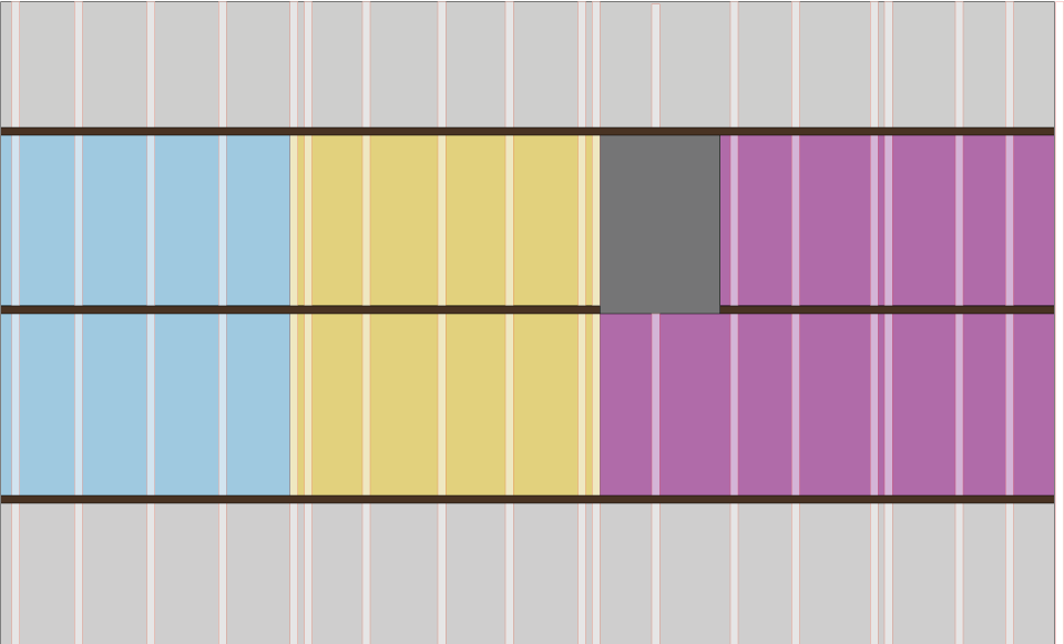

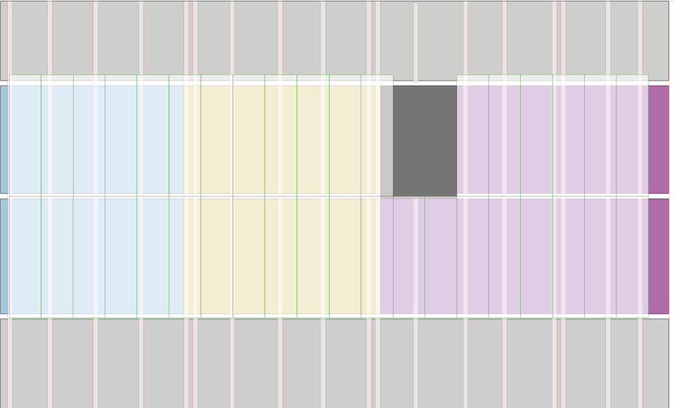

Hi I'm looking into flooring my loft and looking for a bit of advice on how people with a bit more knowledge think I should go with it. I did some measurements and drew up a plan of what's there already. It's an old style house, built around 1969.
The dark grey part is the hatch. The horizontal lines are the joists (correct me if I get the terminology wrong/mixed up) and the brown vertical lines are what I believe, from my research, to be binders. The middle binder was cut when I got someone to install a bigger hatch. The pink area on the right hasn't been floored at all, the yellow in the middle has been floored with regular wood planks, but directly on the joists and the insulation under is a bit squashed and the the blue area on the left has been floored over the binders with chipboard, but I don't think it's proper flooring chipboard and it's a bit flimsy to stand on anywhere other than the middle or sides where the binders are supporting it. The light grey areas are the eaves, which do go further than the area I have drawn.

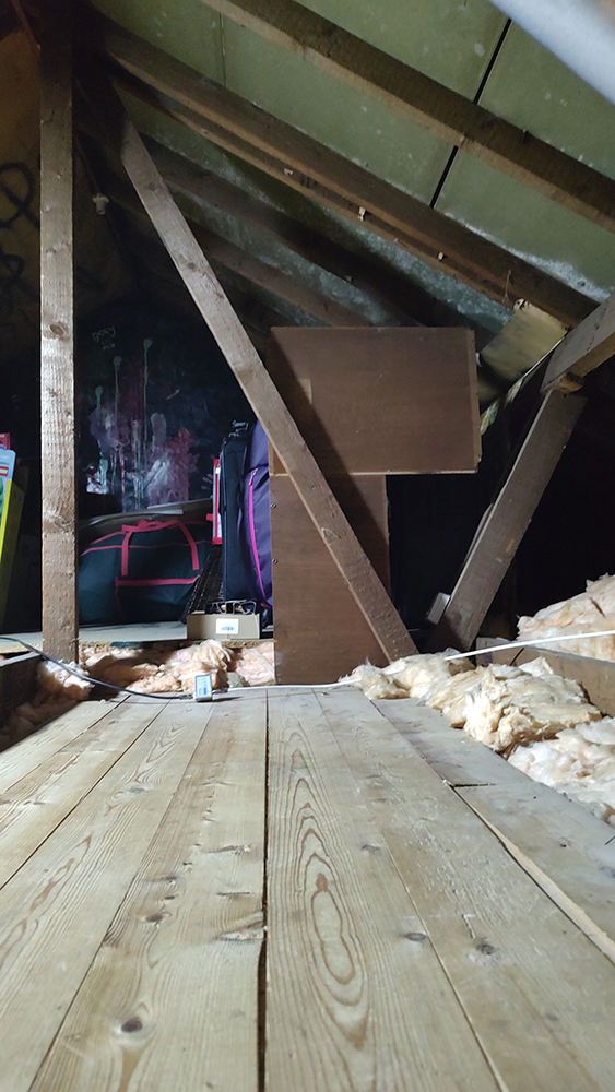

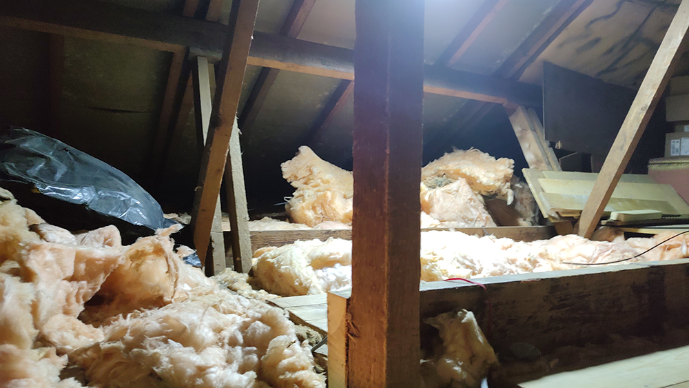

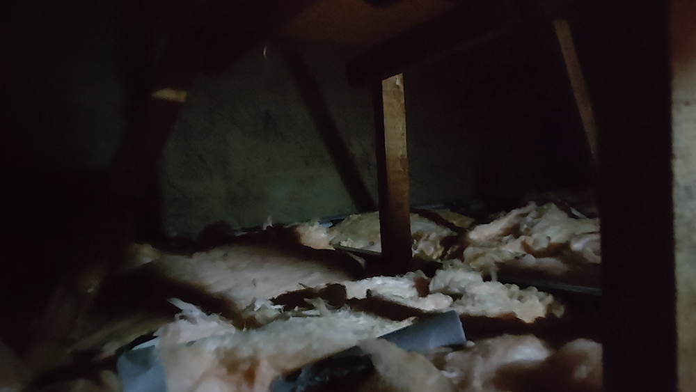

Here are some photos taken from the hatch to get an idea of the different areas:
My original thoughts are to remove the flooring that is already there, floor the middle three coloured areas and then a little out into the eaves for storage. Of course I would tidy up the insulation properly under the new boards as I went.
I was looking at standard loft boards that are around 122x31cm. One thought I had was to utilise the binders similar to the way that has been done in the blue area above. Here's something I drew up to show this, obviously the part that covers the hatch would need to be shaped round it:
It turns out that those boards would sit nicely sized across the binders. If I did this I was considering working out some raised platforms in the eaves for storage rather than going full flooring since that area wouldn't need to be walked on anyway. A few questions about the flooring area though:
The other option I was thinking of was rotating the loft boards 90 degrees from the idea above and installing them on the joists with loft legs, as seems to be the main suggestion I've read about. I started putting a drawing together to show how this would maybe work, though I didn't finish filling in the whole floor area, yet:
I read that staggering them is better. To me, however, this seems like a lot more work, cost and would leave quite a bit more waste. I would need to cut every board so that it didn't overhang from the joist leg supports, there would be lots of small cut offs I couldn't do much with and I'd need to invest in a lot more legs. If I did it this way I would probably just extend the flooring out into the eaves for the storage space too.
what are peoples thoughts about this? If I can get the first option to work then I think that might be the best option, but everything I'm reading seems to suggest that I should do it the second way.

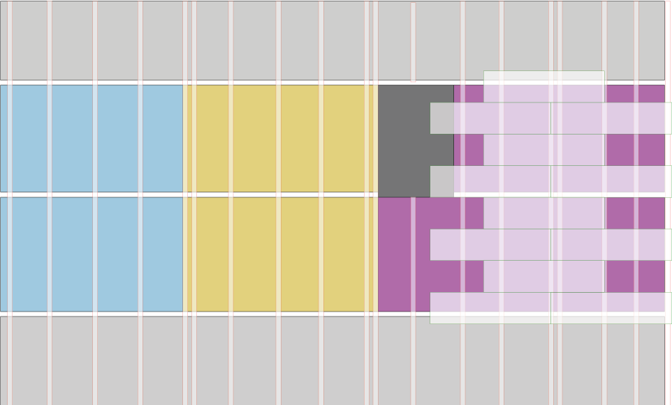

- Are binders acceptable supports for flooring?
- I assume that I would need at least one support in the middle of each board?
- I thought that I could maybe use loft legs/stilts as supports in the middle, but the smallest I can find raise the floor by about 20.5cm and the difference in height between the joists and binders is about 13cm.
- Are there any smaller loft legs available?
- Could I use wood cut to size rather than loft legs?
- Could I extend the height of the binders to line up with the height of loft legs in the middle?
- If there's a solution for the above points there's still an issue with boards that don't cover joists for the extra support, such as the one 4th from the left or the one 7th from the left where it not only isn't above a joist, it also isn't above a middle binder since it was cut for the hatch installation. Would crossbeams such as these: https://www.loftzone.co.uk/loft-storefloor/ be useful for these bits?

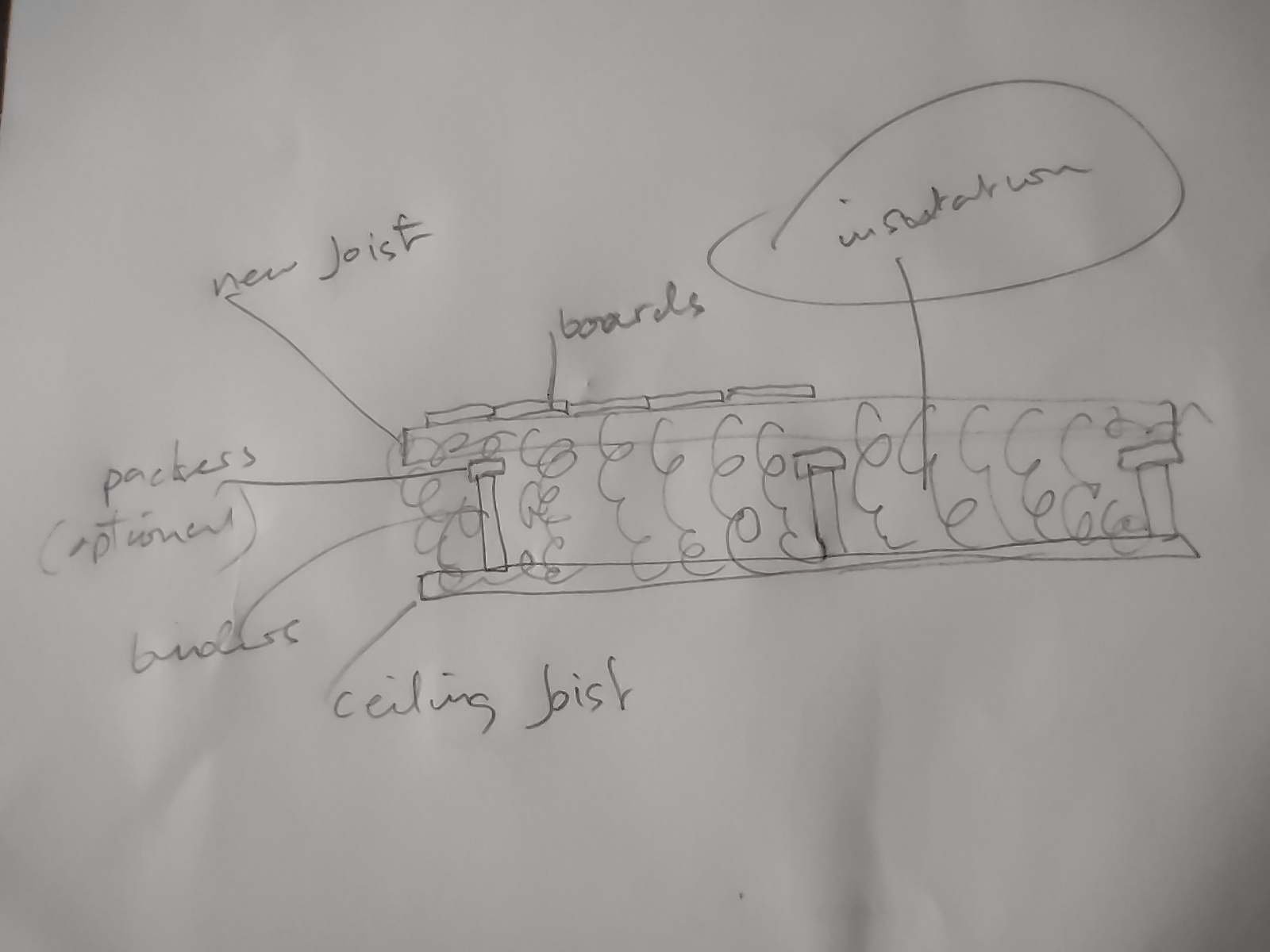

- Instead of loft legs/crossbeams for the middle support could I just add some more beams of wood across the middle of the joists, effectively adding more binders?
