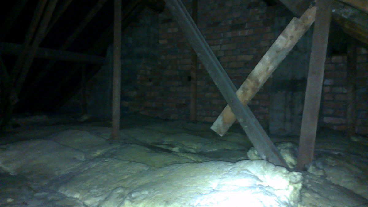

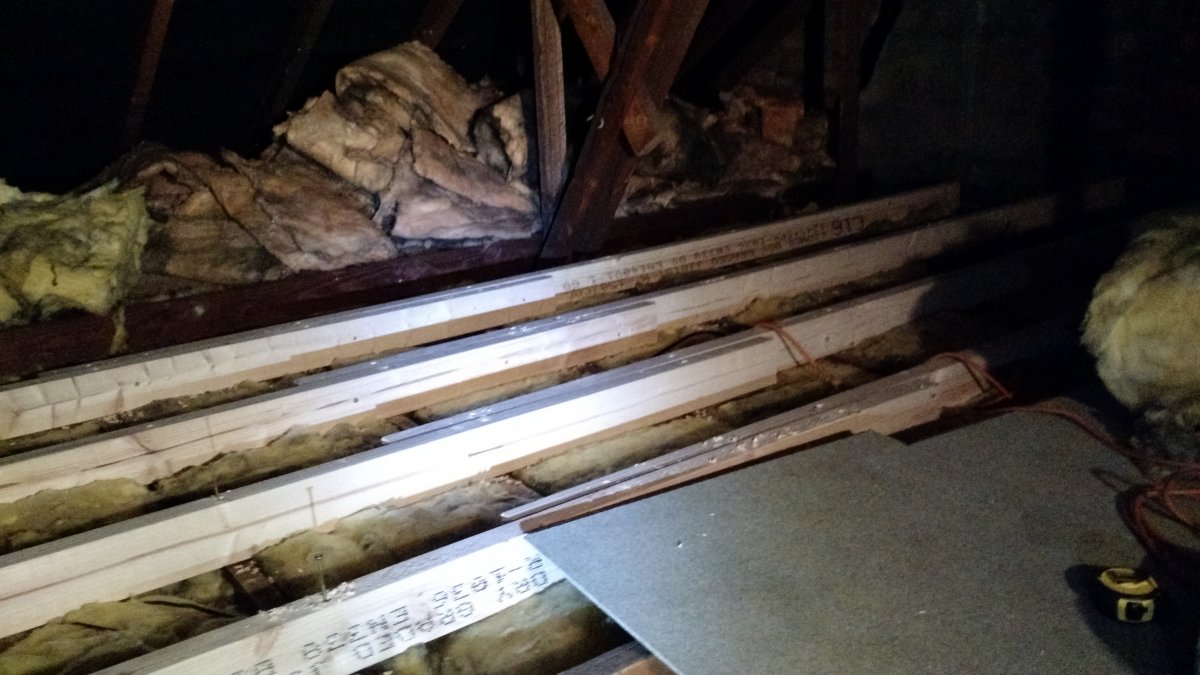

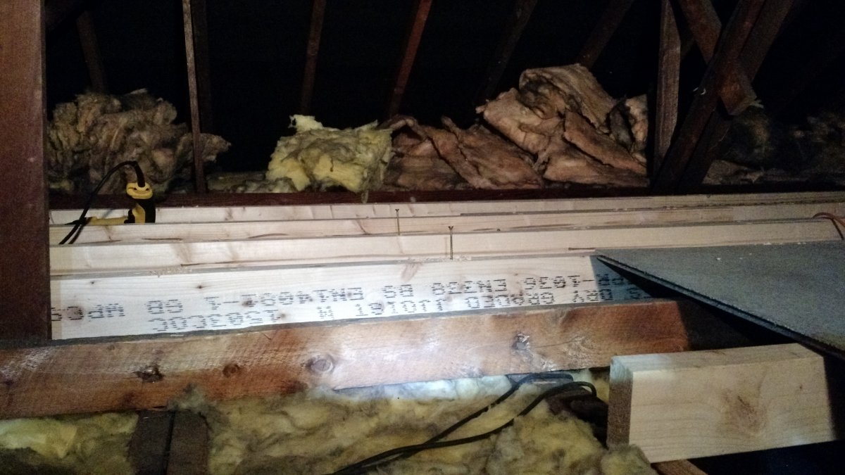

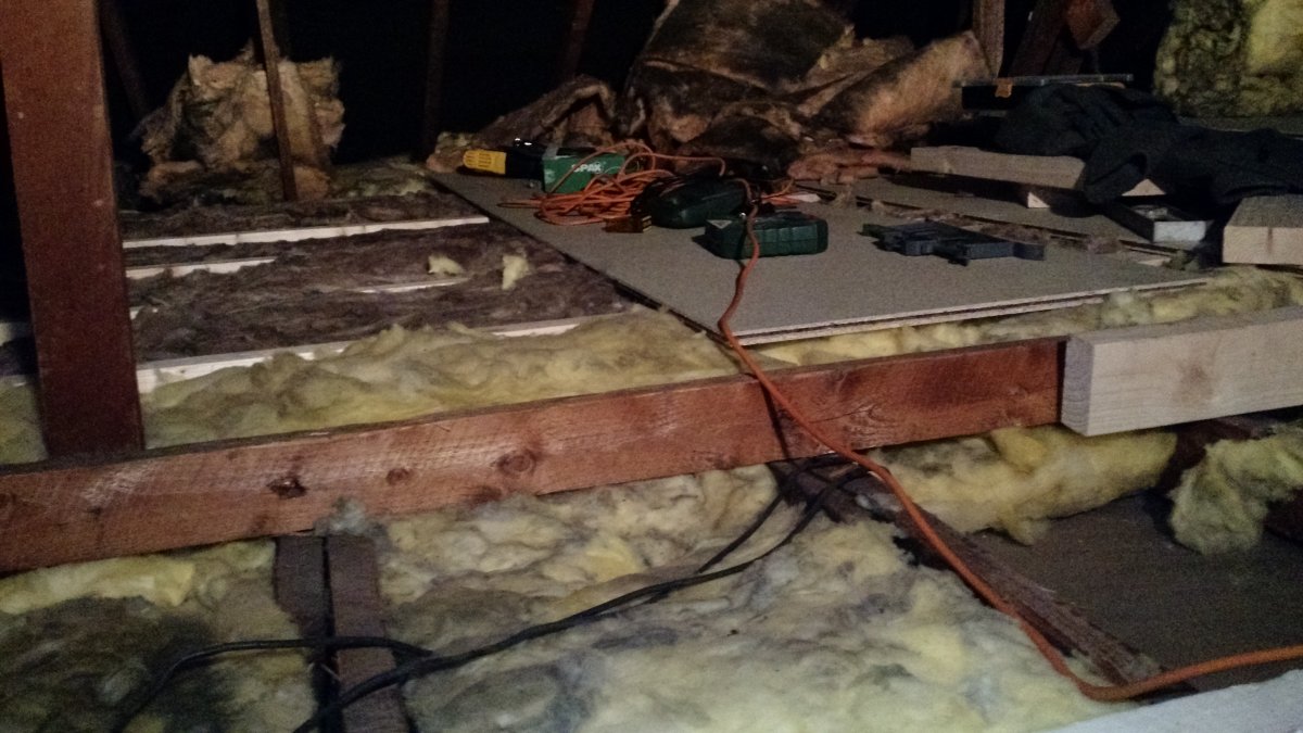

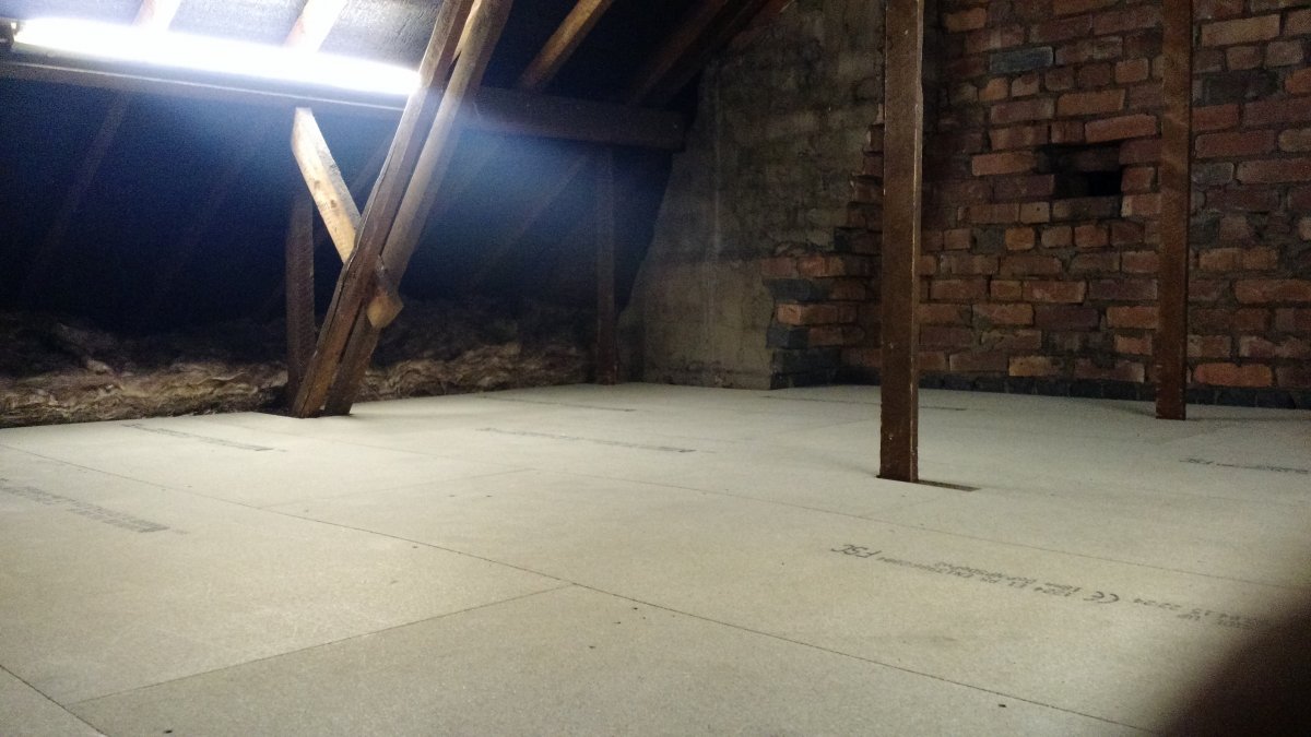

if this post works it should have some pics as to how i raised the floor level in my loft and doubled the insulation thickness, If you click the little white up arrow next to "deadbeat said:" below, it will take you to the origional post where the photos are expanded
The Third big project was to re insulate and floor the loft space so we could move stuff into the loft and out of the way
View attachment 88239 View attachment 88240 View attachment 88241View attachment 88244 View attachment 88246 View attachment 88247 View attachment 88248 View attachment 88249
Thats great, thanks Deadbeat.
