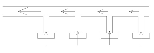

It sounds OK to me if I understand your description correctly, in that the 150mm duct is carrying the air from all four cubicles, whereas the 100mm spigots will only be carrying the air flow from one cubicle......
......like slip roads joining a motorway, the slip roads don't have the same capacity as the motorway because they are not handling the full amount of motorway traffic. :)
Reducing the diameter also assists with balancing. If the spigots were all 150mm the same as the duct, most of the air would flow in via the first grille, leaving little or nothing for the other three.
I would suspect it's more likely that the fan is undersized either for the required design criteria, or the design of the duct (length & number of bends) is imposing too much air resistance.

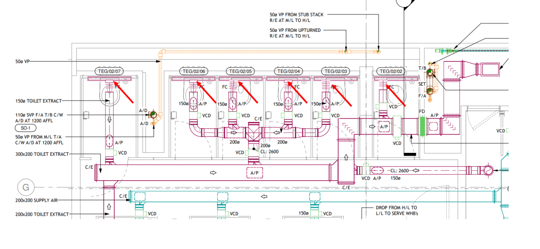

Hi Stem
Thanks for taking the time. It probably have been easier if I used an extract as below. Red arrows point out the 100mm diameter spigots, and its probably worth noting that the VCD's are not installed. I'm told that they can adjust on the linear grills!!
Would your view remain the same? reduced spigots not an issue?
Thanks in advance.
The principle would be the same. The duct is stepped down at various places along the system to suit the airflow at that point.
