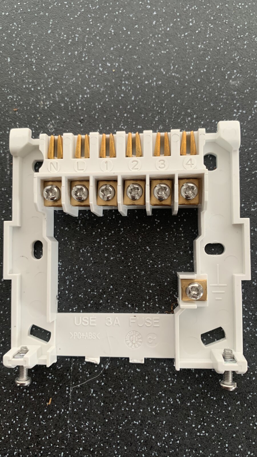

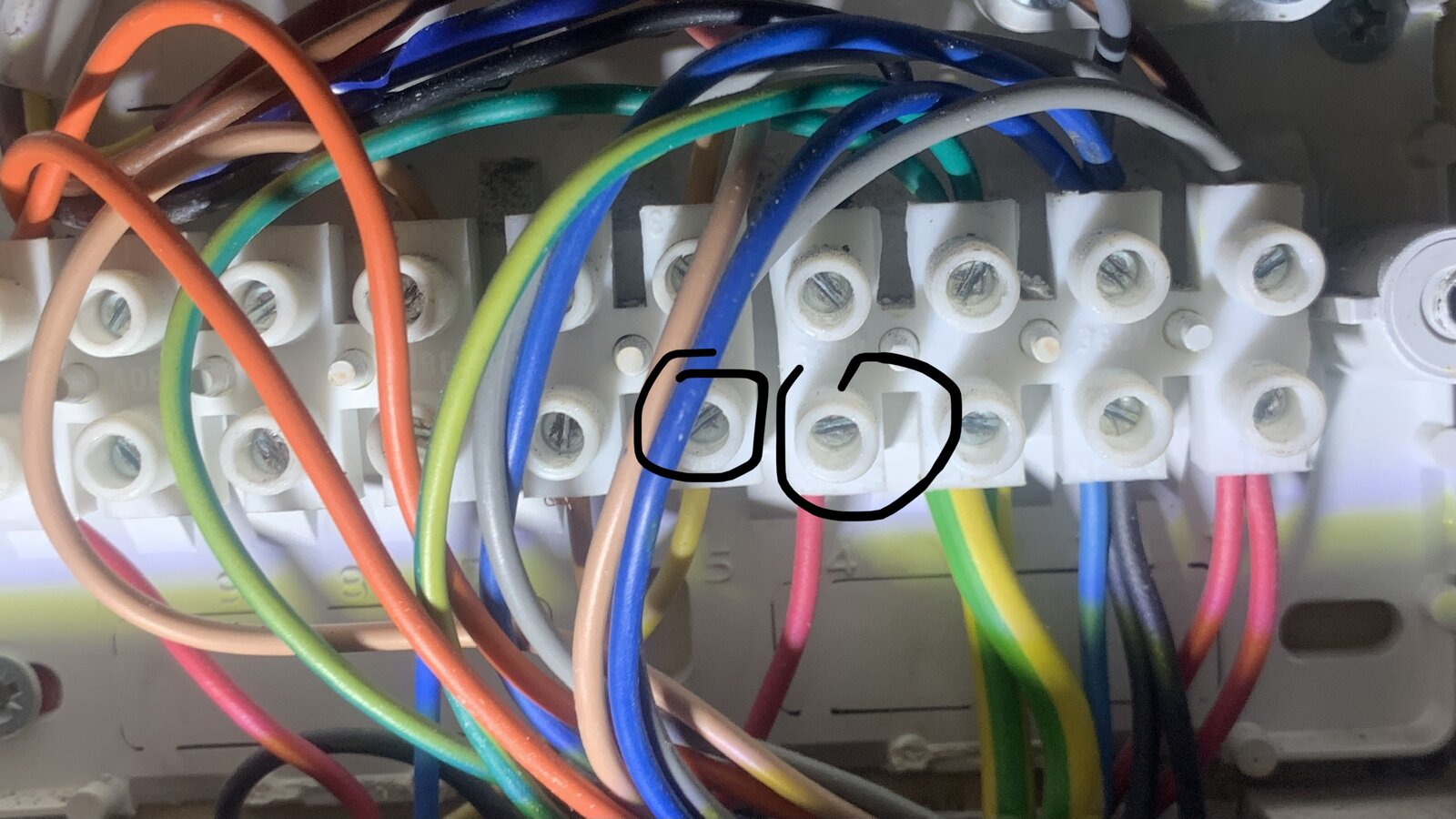

Iv gone and brought the self install hive theromostat kit to place the honeywell heating system.
Now going by the install videos on youtube i thourght it would be just a case of a straight swap another reson why i brought the dam thing.
So i replaced the honeywell programmer with the hive reciver.. Now i have 4 wires a blue for neutral, brown= live a black and a earth wire with brown tape, now im firstly shocked that someone has used the earth connductor as possably as a switch live but ok.
So with the honeywell wiring its blue for neutral, brown for live, earth with brown tape in 3 and black in 4.
I also disconnected the theromostat in which has a earth, blue, yellow & red.
After the hive setup even by turn up the heating to max 32 the radiators are still cold, im not hearing the bolier fire up but do have hot water from cold to hot in a space of a minute where as with the honeywell system the water was hot straight away.
Iv contacted hive and after fannying around trying to re-pair the hive kit still the same problem but under the honeywell programmer is what looks like a big junstion box with 10 terminal connecters (sorry dont know the technical name for it ) would any changers be need to that? as iv just found another video explaining that but need to be sure.
