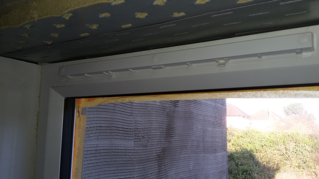

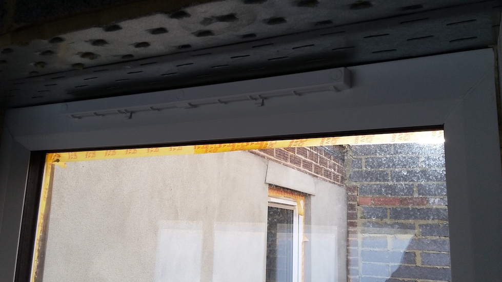

Are these trickle vents too high for plastering?
r_c
19 Jun 2016
269
5
Our builder has told us that the placement of a number of trickle vents will cause problems for the plasterer. He says they are not centred, too close to the top, and too close to the lintel resulting in not enough room for plasterboard.
Below are some photos. Do the windows need replacing or can they be remedied? (We already have a long snag list regarding the windows and have withheld final payment.)
Thank you.
Here are some photos of one window's trickle vent, including one with a bit of plasterboard to show how much of a gap there is.
[GALLERY=media, 99154]Rear Window - Is Trickle Vent Too High To Fit Plasterboard? by r_c posted 22 Jan 2017 at 4:30 PM[/GALLERY][GALLERY=media, 99155]Rear Window Showing With Plasterboard by r_c posted 22 Jan 2017 at 4:30 PM[/GALLERY]
This photo (I couldn't get my damn flash to work) shows one window without enough space for plasterboard. Click on it to see a bigger version.
[GALLERY=media, 99156]trickle vent too high for plastering by r_c posted 22 Jan 2017 at 4:30 PM[/GALLERY]
Ideally the windows should of been surveyed to include something like a 15mm add-on to the head to allow room for the vent, some companies even fit the vent in the add-on. I think you'll be OK to remove the vent, tape over the slot and get it plastered, once dry you can put the vents back on, a few mm lower won't hurt

We did exactly as Crank suggests, had no option on one window which was a replacement the original head had a step in it which was not apparent until removed leaving zero space for trickle vents, just routed a slot lower down and refitted.

Thank you both. So it sounds like trickle vents can be moved down a few mm. But I think this one will require the vents to be moved about 10mm down. I guess the trickle vents cut into the window will then be visible?

If you run into trouble moving the vents you could alternatively use a bit of thin ply to board above the windows, instead of plasterboard.

I thought the vent cover was centered over the vent meaning it could not move down much. On closer inspection the cover was in fact very high in relation to the vent, and the vent is located in the right place. So it can come down a lot more than I expected and the builder now says it will be fine.
