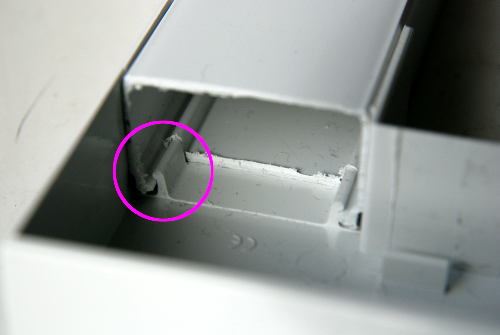

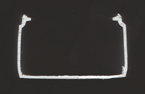

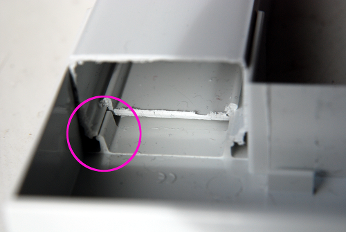

I refer to stuff like this. It looks like typical trunking.
Thing is, I don't know how to use it! I don't consider myself uneducated, but I can't figure out how to put together a run with corner and tee connectors. The only way I can assemble a run is to attach it piece by piece as I go along. So attach back channel. Clip on front. Slide on corner connector and repeat. Since the front covers go under the corner fittings, and the corner fittings have to slide onto the back channel (they do not clip on from the front) you just end up creating a closed conduit.
And that all means that it cannot be opened up again later somewhere, without disassembling the whole run.
If the corner and tee fittings clipped on from the front like other ranges, it would all be fine and dandy. Since 38 reviewers gave this weird stuff 4 /5 stars, I must be missing a trick.
I'm probably having a brain fart, but really need help.
