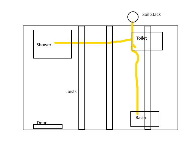

Just wondering if I can get some advice. I have removed the old toilet, shower and wash basin and the lead soil pipe that ran under the floorboards and out to the soil stack on the exterior. I have cut the soil stack using an angle grinder and know that I need a rubber connector for the old pipe to new plastic 110mm piping but not too sure how to configure the new stack. Would this work?
Lead stack - rubber connector - length of 110mm pipe - access branch adjacent to brickwork opening - length of 110mm pipe up to roof for venting
Once I branch off into the bathroom under the floorboards, where should the connection for the toilet be? The joists are already notched for the shower waste so should I use a mechanical pipe boss connection into the 110mm pipework?
