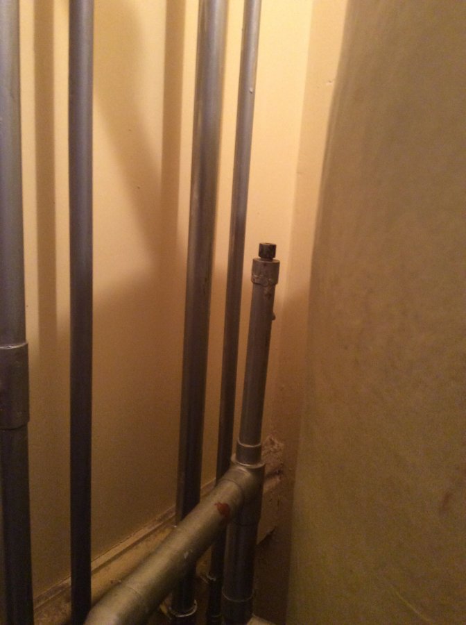

Is their an air vent on the flow pipe, normally at high level alongside the cylinder?
Can you post a pic of the airing cupboard installetion?
Hi,
Yes there is an air vent next to the tank. I have opened this and it does not appear blocked as the water is flowing. Is this the one you are referring to?
Many thanks.
Problem resolved today by engineer in 30 minutes.
The overheat stat had gone so new one now fitted and I have a nice warm house :)
Pump is ok however will be replacing it with a Grundfos so that it is more efficient.
Many thanks.
