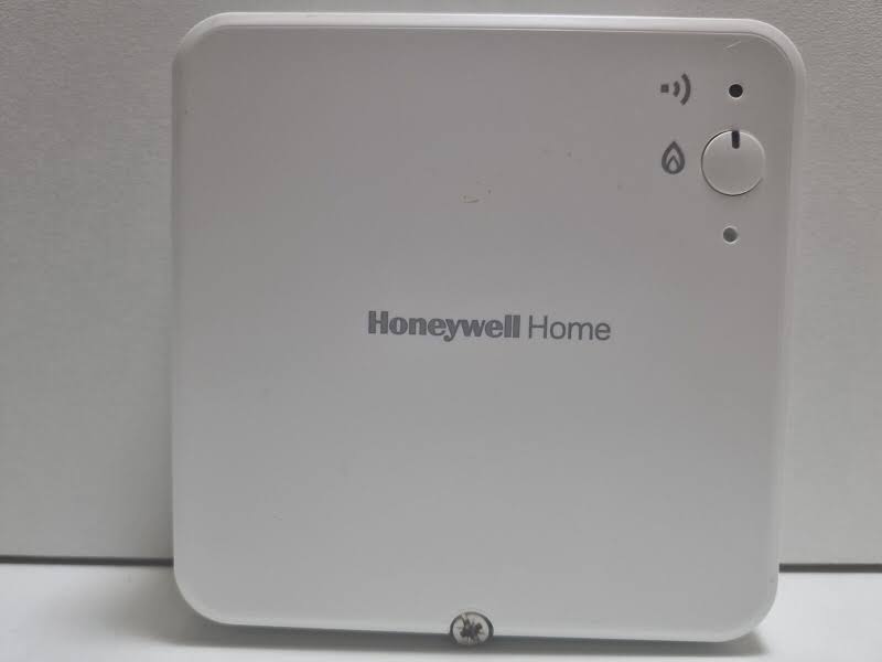

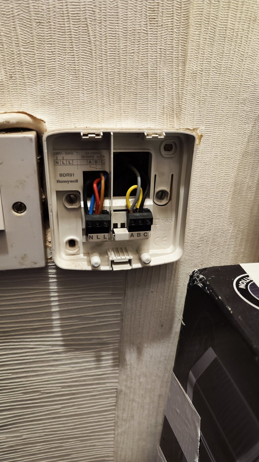

Hi everyone, i need some help with the Honeywell BDR91 relay wiring that i am trying to get working but have no idea what to do.
This was originally paired with a CM921 thermostat but the screen on it stopped working. An engineer came out and said he has "disconnected it" so the boiler has been used manually ever since.
What do i need to do to get the relay working again so i can pair a T3R thermostat to it?
The relay has power but once i pair the relay and thermostat it doesnt have a solid green light.
Any help is appreciated.
I removed the yellow link wire and it still didnt work so i think this relay box isnt compatible with the T3R and i need to change it to a newer honeywell home relay.

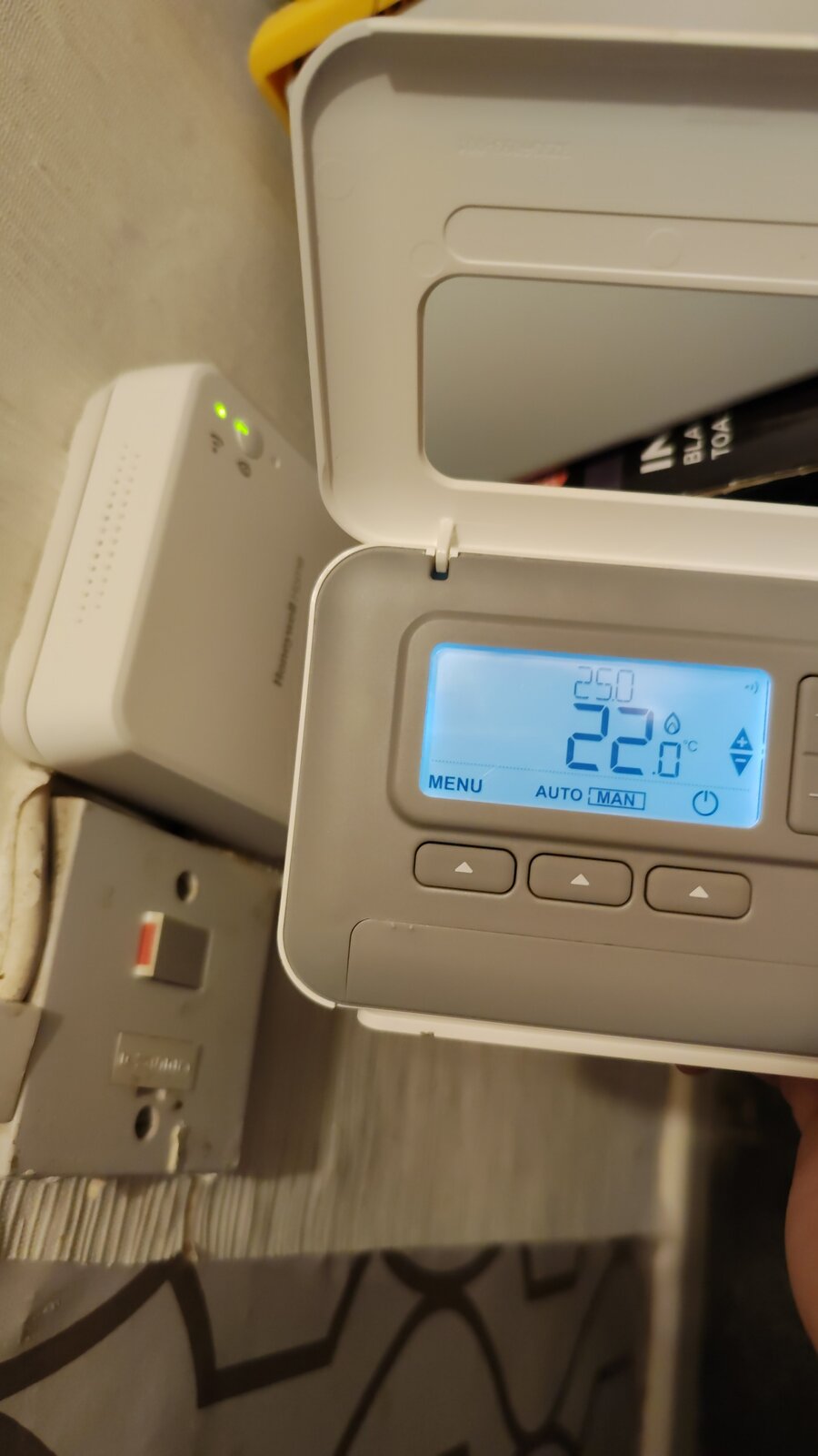

Yep did exactly that a few times but still no luck. There was no wireless signal logo on the thermostat once i did the binding steps and the relay didnt go solid green. The relay red flashing light turns off and doesnt do anything when i increase the temp on the thermostat. I've ordered this new relay that is meant to go with the T3R now so i will try that and see if it works. I'm sure i read online somewhere that you can't actually use the T3R with the BDR91 relay but it was worth a shot.
Strange, as Honeywell struggled to get the bigger receiver out (microchip shortage), so they sent bdr91’s, unless they were changed inside on the circuitry to allow it? :unsure:
Whether true or not, web folklore suggests that newer T3R had a firmware version that added encryption to the wireless link, and killed compatibility with the BDR91....

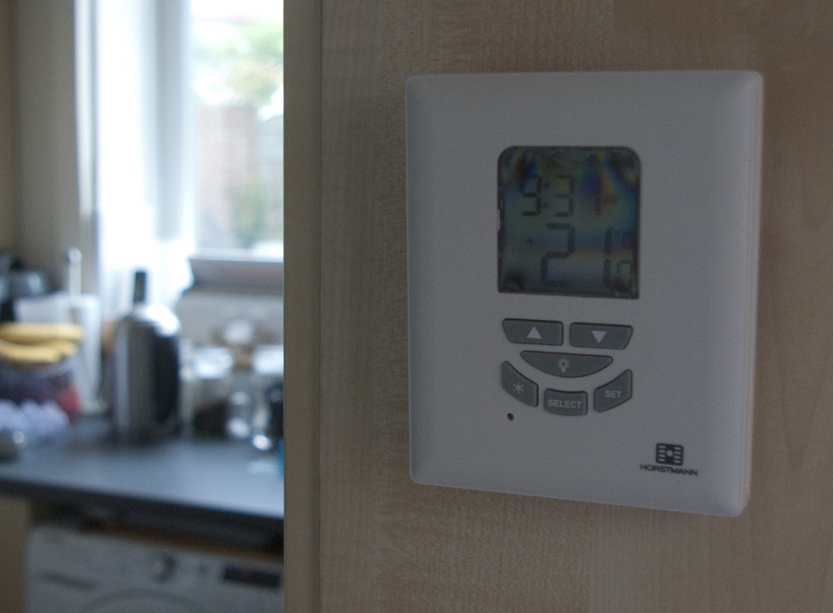

With my mothers old house in North Wales I had a problem, this thermostat IMGP8037.jpg would loose connection and the heating would fail to switch off, I tried to find the frequency used and to see what was causing the interference, I failed, unlike the other thermostat there was no safety system to turn off heating if signal was lost.
Our homes today have so many radio devices, and we need to expect the spectrum to become flooded. So we need to buy devices as a pair, and not try to use old with new.
