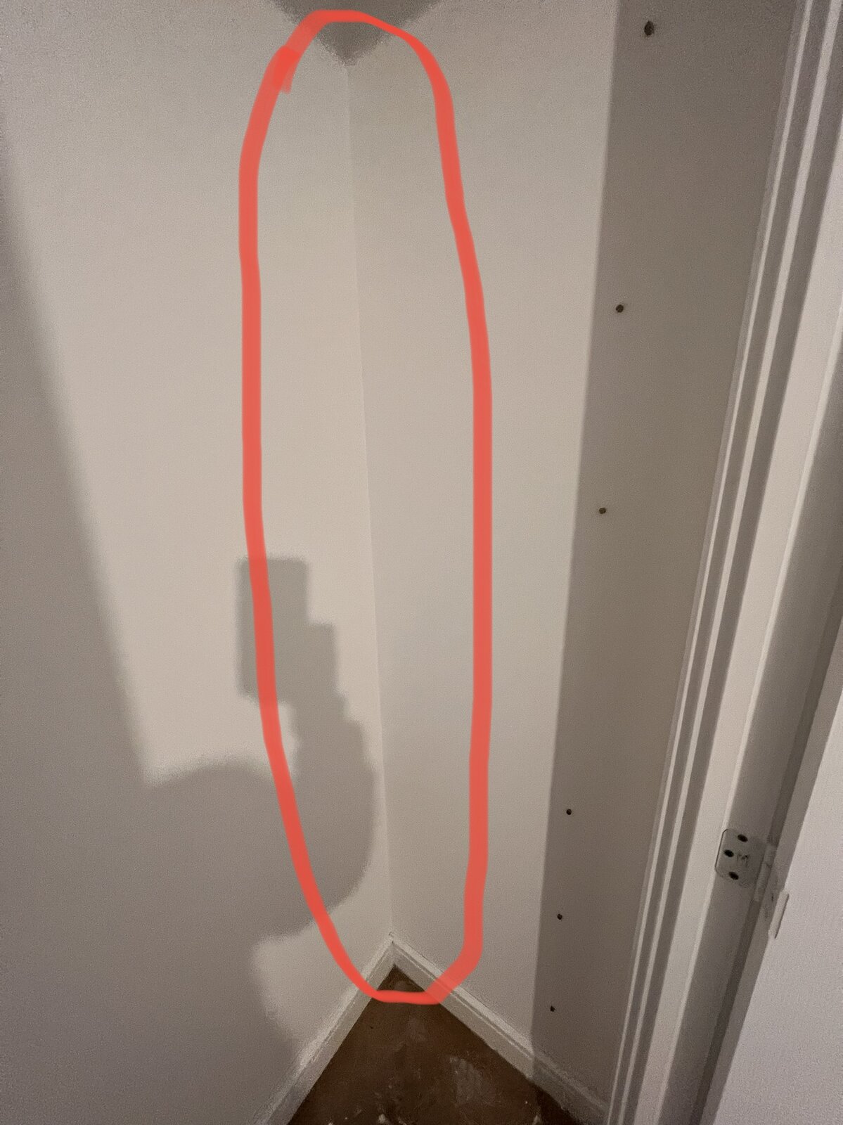

Hi,
I have a small wardrobe space as seen in the pic below and am looking to install couple clothes rails. The problem is there is not stud either side where I want to fit the rail. I can use strong plasterboard fixings but I suspect these will eventually fail given the weight and constant use of the rails.
Any thoughts? Many thanks.

If you actually want the rail mounted on the wall rather than on legs, I would say the most important consideration so as to avoid the fixings being pulled out is to ensure that the rail be totally rigid. If it bows in the middle and it is attached or held firmly at the end then it will tend to lever the screws out, whereas if it is rigid the weight will act directly down at the ends and you may even be all right with normal wall plugs, so long as you take great care to avoid shattering the plasterboard during the drilling, plugging and screwing. I.e. drill slowly with a round bit (not a masonry bit), do not force the plug into the hole, don't use an over sized screw.
Folks- I was trying to find out where the studs were in this alcove so I used magnets as seen in the pic. However, I also ran a stud finder/metal detector along the wall, every corner of this alcove sets off the metal detector. It is the full corner section in each of the four areas of the alcove. I have highlighted one such area in red. Does anyone know why this would be? Surely there can’t be pipes in every corner… thanks
There could be metal stud, or your stud finder could simply be fibbing to you (sorry, I reckon they are more trouble than they are worth)
Strip of timber up both sides with holes drilled to accept pole , all force then transmitted down thru timber giving a strong support . 2x1” should do it.
whilst 2x1 will work i find 4x1" gives a much more pleasing appearance more chunky more pleasing and gives a platform above to be used for a shelf whilst leaving enough room to hang a hanger on the rail
I meant a vertical timber , not horizontal .
Found out today that it is likely to be metal studs as there are no pipes that run in the alcove.
