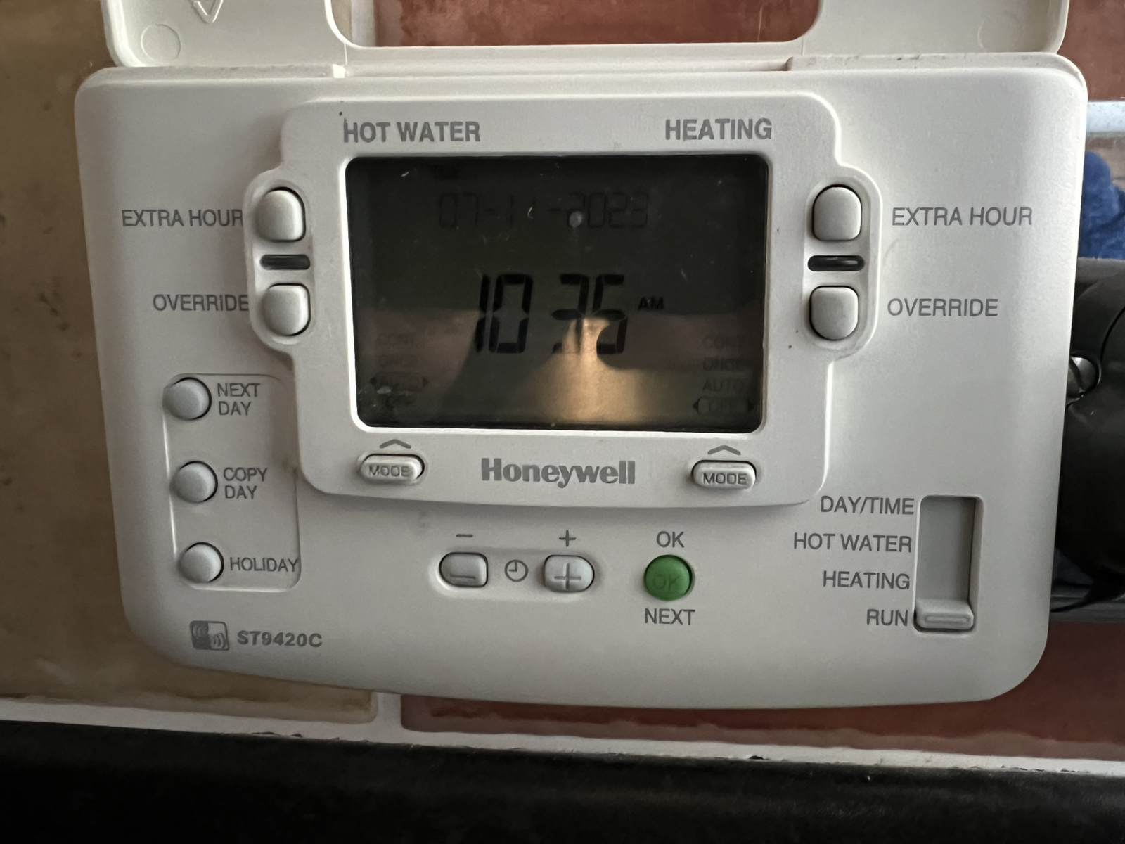

What timer or programmer do you have ? And are you setting it for domestic hot water only to come on in the morning or central heating as well ?

The programmer is the Honeywell ST9420C (picture attached). It is set for domestic hot water only for 20 minutes (no central heating)... It's been set this way for the last ten years and up until recently has worked without issue providing piping hot water...
