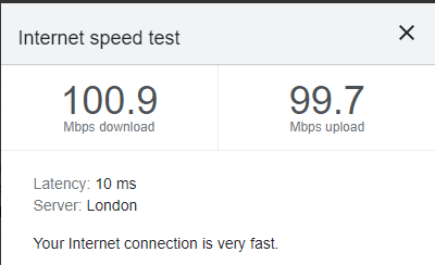

Hi
We just changed our office broadband to a full fibre connection and the contract states an 'Assured Symmetrical speed 300 - 1000Mbit/s; Max Contention 50:1'.
When I run a speed test we get 100mbps download and 100mbs download. This is plenty fast enough for what we do but should we be getting at least 300mbps up and down?
Thanks.

I tested on a wired PC using Chrome and the Google tool that comes up when you search 'speed test'. There are other PC's and phones connected. This is what we get:

To be pegged at 100, could suggest a hardware limitation somewhere on your side, rather than with your ISP.

No, your contract and speed test are both Mbps - Megabits per second.
And a 1 decimal place change wouldn't work - this is the world of binary, 8 Bits to a Byte! :)
Many network cards and switches were 100 Mbit/s until fairly recently. Your PC may be old school?
Check out the installed network card's Hardware Device details to check if that is limiting you on that PC?
May be worth trying a different Ethernet cable if it is a Giga bit card installed?
Note that, while Wi-Fi speed tests may not be as accurate as wired, some devices such as tablets or phones can at least show if the connection is faster than you have so far tested.
NB the speed test image you have posted is for Mega bits per second not Bytes

If I use my iPhone on Wi-Fi I get 93 down and 69 up. If I plug a 3 month old Windows 11 PC direct into the router with a 2 metre CAT6 cable I still get 100 up and 100 down. There are other devices using the network at the moment so will test again when I can unplug other users but I am surprised I can never get over 100 when the lowest is meant to be 300.
I have just emailed support with the supplier to ask for the engineers readings he took when installing.
Also just checked the info they sent about the Wi-Fi router as it says 'We use WiFi6. This is the latest standard for WiFi and provides many of the same features as 5G mobile. With WiFi6, and with the right device, speeds of more than 800Mbit/s can be achieved over a wireless connection with your Gigabit service.'. That would mean I should get more than 100 on my iPhone 12.
Its looking like we have been limited to 100Mbps instead of the contracted 300 to 1000Mbps.
