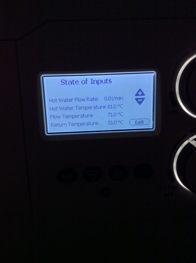

Hi I have an opentherm compatible boiler and controller / room stat.
Question is when setting up the stat I am prompted to enter max flow temperature for CH. (this can also be done directly on the boiler )
Boiler is capable to going up 80c
I set it to 70c with the following thinking
1) my boiler will never run at full throttle (protect components)
2) running at 70c greater chances of return flow being closer to 55c for condensing purposes
3) it's a 26kw combi and my house isn't a mansion further more we've not seen artic temps yet. E.g. -10
4) the boiler does modulate from 70c down all the way 30c when much heat is not required
5) on the whole my lounge where the stat is holds 14c when standing cold overnight. So not much of jump required to get to 19c
Is my thinking and setting to 70c best course of action or does anyone beg to differ and importantly why ?
Thoughts answers theory all welcomed
