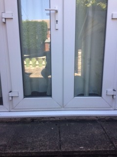

We have a small wooden strip below our French doors on the outside which has rotted with small holes appearing. This strip is approx. 9cm tall. Behind it is an open gap underneath our floorboards.Can I strip this wood out and replace it with air bricks? Or we have some leftover black PVC panels (left over from our mock tudor panelling), can we cut these down to size and drill air holes in them?
