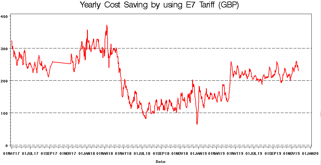

However, as I've reported here a number of times, one now has to look around more carefully. Whether intentionally or the result of a mistake on their part, the E7 deal I got (fixed for 2 years) when I swapped to ESB earlier this year has even the daytime rate lower (albeit only very slightly lower) than their non-E7 rate, which means that having E7 is a no-brainer - with this E7 rate, even if I used NO electricity at cheap rate, my bills would be no higher (in fact, slightly lower) than without E7.

Much of that is true, but I think it would be worth you at least going through the exercise of doing the sums, since E7 savings can be appreciable (albeit less than they used to be (see below) - as you will see, even without storage hetaers, I'm currently saving £200-£250 pa by having E7.

See the graph below, which shows my experience over the past 2½ years, albeit our position (as regards electricity usage) is probably pretty unusual. I do not have any storage heaters, but I do use electricity for (night-time) water heating (which amounts for nearly half of our electricity usage - so maybe comparable with one storage heater), and we run many of our 'utility room appliances' at cheap rate. We had had E7 with E.ON for years, and until April 2018, the benefit of E7 had remained roughly unchanged for us, resulting in a saving of £250-£300 p.a. (in comparison with a standard single-rate tariff). In April 2018 they changed their E7 tariff such as to dramatically reduce the advantage of E7, with our saving falling to little over £100 pa. Since we changed to ESB in April of this year (2019), we've been enjoying a saving of £200-£250 pa. To put these savings into perspective, our total bill, with E7, is just a little over £1,000 (and a night-time usage of 45% or so of the total) - so, for us, the saving is currently 20% or so.
Kind Regards, John
