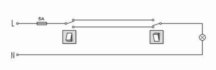

Hello Everyone,
I hope someone out there can help please.
Basically I have two way switching for my top landing light which can be controlled from the switch downstairs, and can be controlled from upstairs. The switch has become ancient and I have managed to change all my switches upstairs and downstairs to smart switches (RF) except for these two way switched ones as I'm unsure how to wire it up as its in bit of a mess already.
I say mess, because I can't for the life of me find a diagram that matches my two way system against ones online, each switch only has single wires connected, and upstairs seems to have an issue of not having a permanent live by the looks of things so I'm not sure how would I go about wiring a smart switch in? Its Lightwave so no neutral required, it just shows it needs a live wire, signal wire (low voltage), and switched live so how would I go about doing this. I'm dreading the the thought of having to get the switches rewired if I wanted smart switching so any alternative advice would be appreciated.
I've taken off the switches from the wall and they are wired in this configuration

COM - 1 Red Wire
L1 - 1 Black Wire with red sleeving (Switched i'm guessing)
L2 - 1 Red Wire
[GALLERY=media, 105669]Upstairs Switch by jake.evans posted 10 Dec 2020 at 4:16 PM[/GALLERY]
Upstairs Switch (Mounted Wrong Way Up)
COM - 1 Red Wire
L2 - 1 Red Wire
Even though upstairs mounted the wrong way up, here's how its working at the moment:
If both switches are up, the lights are off
If one switch is up, other is down, the lights are on
If both switches are down, the lights are off
For the purpose of diagnosing, this is what happens in terms of the wiring being on/off:
[DOWNSTAIRS SWITCH]
If the downstairs switch is "up-off" and upstairs switch is "up-off" (remembering its the opp way mounted)
Then
COM - LIVE
L2 - LIVE
L1 - OFF (Black Wire/Red Sleeved switched)
If the downstairs switch is "down-on" and upstairs switch is "down-on" (remembering its the opp way mounted)
Then
COM - LIVE
L2 - OFF
L1 - ON (Black Wire/Red Sleeved switched)
If the downstairs switch is "up-off" and upstairs switch is "down-on" (remembering its the opp way mounted)
Then
COM - LIVE
L2 - LIVE
[UPSTAIRS SWITCH]
Then
COM - OFF
L2 - LIVE
Then
COM - OFF
L2 - OFF
Then
COM - LIVE
L2 - LIVE
I would really appreciate the help.
