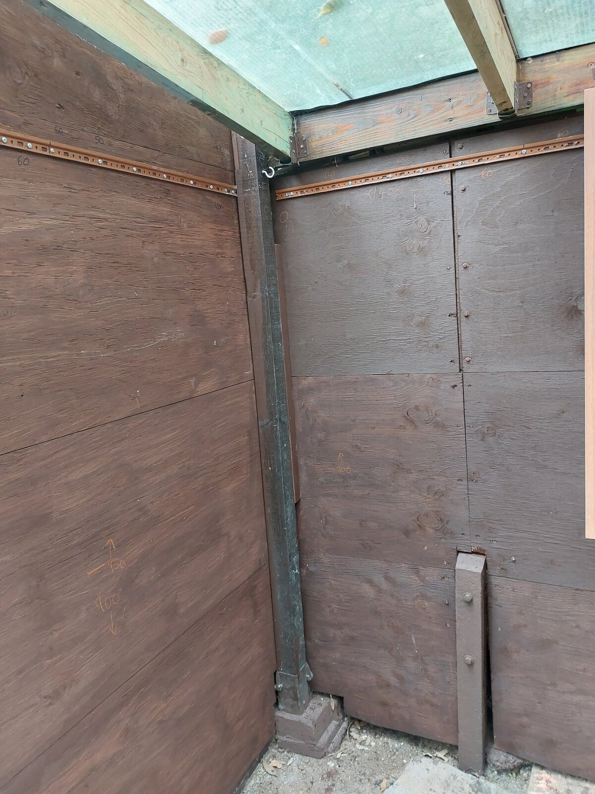

In this job, I strongly recommend a concrete pad cast into the ground, with a steel shoe, and the post fixed into the shoe above ground.
Buried timber will always rot, and eventually snap just above ground where the ideal combination of damp and air content occur.
You can make a simple box form around the top of the pad so the visible part looks small and neat. Slightly sloped or domed to throw off rain.
Example in the left corner of this lean-to shed.
Unlike a fence, a shed is not subject to strong sideways forces from winds trying to blow it over.
The concrete spur you can see is to raise a pre-existing fencepost off the ground, I incorporated it into the shed.
The reason the posts snap at the top is because they have been set into the concrete, as opposed to through the concrete and into hardcore,which is the way they should be done.
