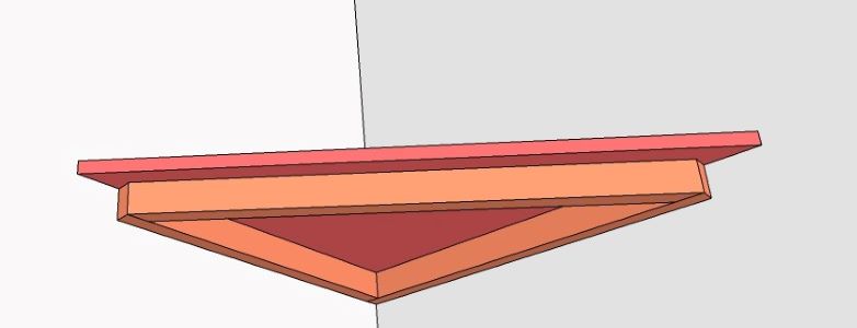

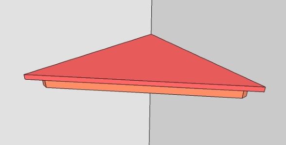

2" x 1" Battens screwed to the two walls to form a right angle in the corner. Then screw a front bracing piece to form a triangle.
Fit triangular shelf of plywood of desired thickness, (9mm, 12mm 18mm ), and screw down into support battens to secure.
Paint/varnish shelf and supports in desired colour.
Cheers. I had seen this online but was worried about the load it needed to carry. Sorry for the daft question but can you explain what you mean by a front bracing piece?

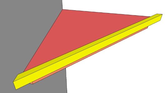

The bracing piece can go across between the frames as above, or be attached to the front of the shelf as a lipping, which can either create an upwards lip at the front:

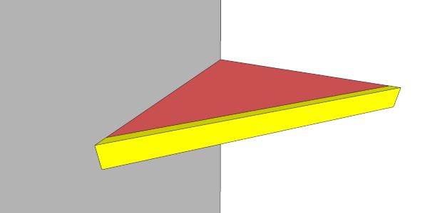

or a downwards lipping:
