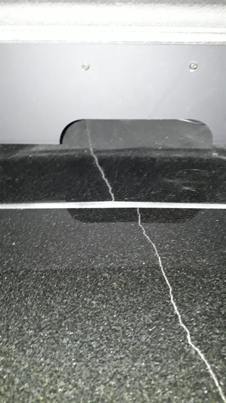

In Oct 18, I paid a fair whack to what I thought was a reputable company, to have a gas stove fitted. They knocked a big hole in the fireplace to sit the stove in, a wood beam was put up on wall with granite base for fire, and granite hearth and heat resistant slate effect back and sides. Last Sept I noticed both pieces of granite had cracked directly down the middle. Can anyone advise why this might happen? I have been point blank refused a free replacement granite by the company, who say there must have been subsidence or rising damp under the granite. My house is about 130 years old and the previous marble hearth was fine and down about 20 years! Im looking at taking them to a small claims court but thought I would ask about this here, first.

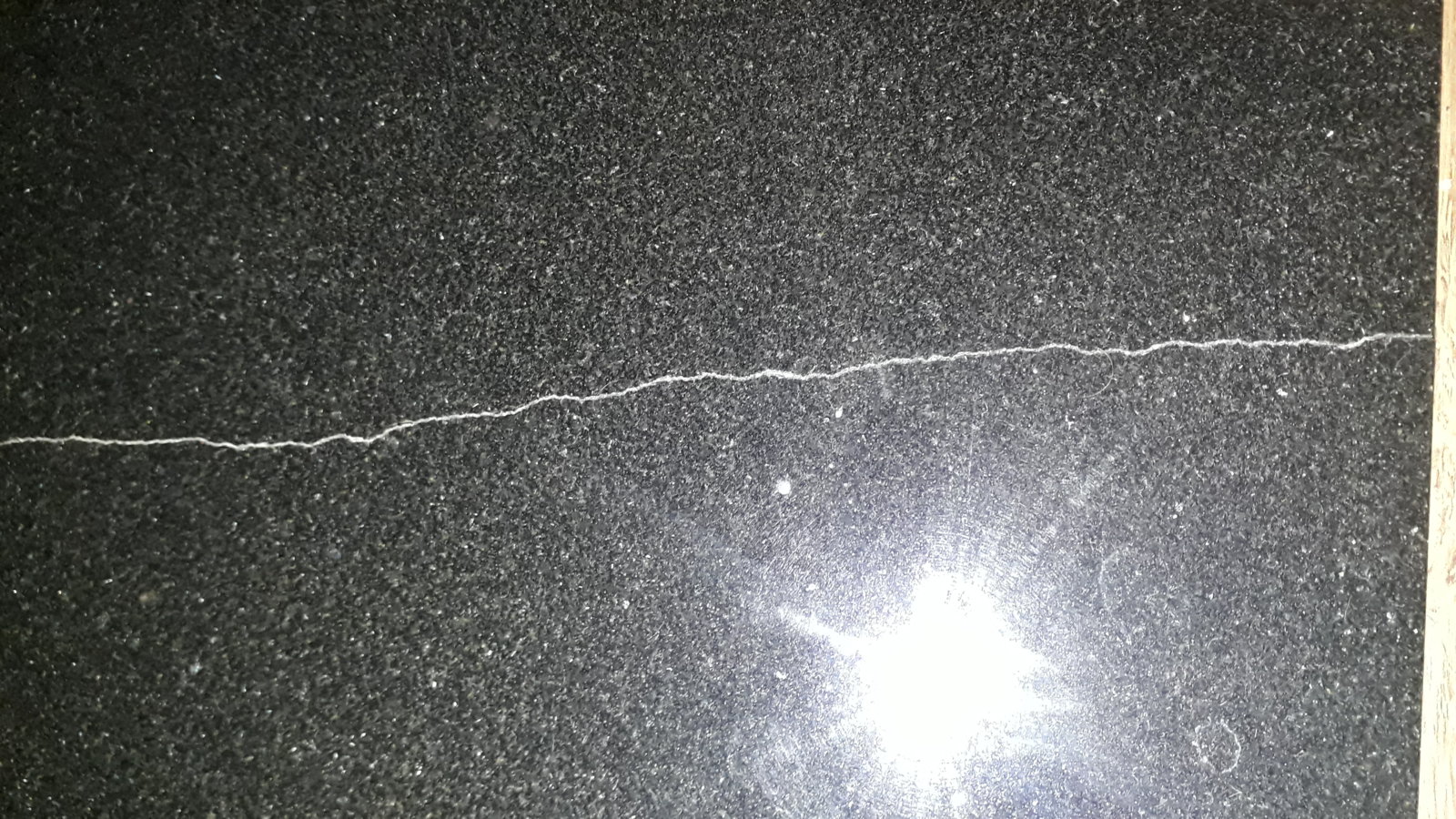

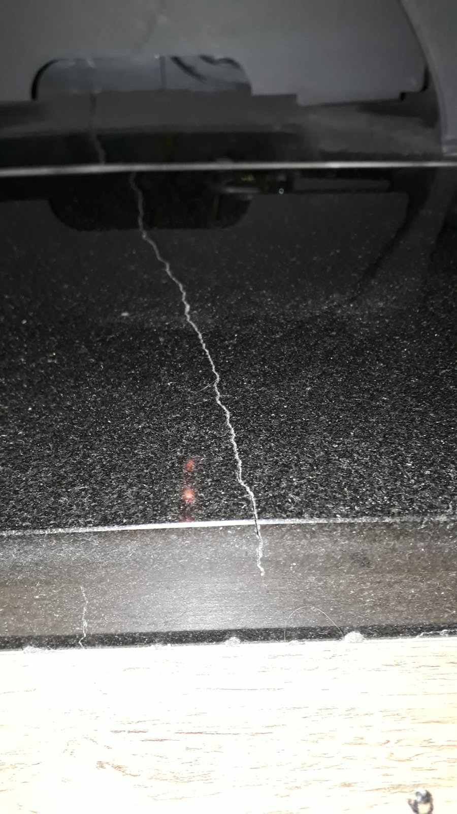

Your second photo looks like your hearth is made from 2 thin slabs bonded together. Both slabs are cracked - the upper one from the top down to the joint line and the lower from the bottom up to the joint line. Rising damp cracks granite :ROFLMAO::ROFLMAO:
Well spotted- and really? Do explain
It appears it's the base that's cracked, it's cracked because it's insufficiently supported across its width. From the info supplied I'd guess it's a bodged job.
Those stoves can be quite heavy ....marble ....slate ....stone have no fkexability and will crack if unsuported. I used to fit fireplaces.
I'd guess they haven't put compo ( mortar) under the slips in the centre of the hearth. That's why I'd call it a bodged job.
In the first instance contact gas safe and request them to carry out an inspection ( it's free) don't mess about with the installers. It could be argued that the hearth is part of the installation and the stove is not fitted to manufacturers instructions on an adequate hearth.
If that's deemed to be the case ' not fitted to manufacturers instructions ' ( don't underestimate the power of that phrase regarding gas workwork it's paramount ! ) you've got them. Gas Safe is now your next step no ifs or buts.
