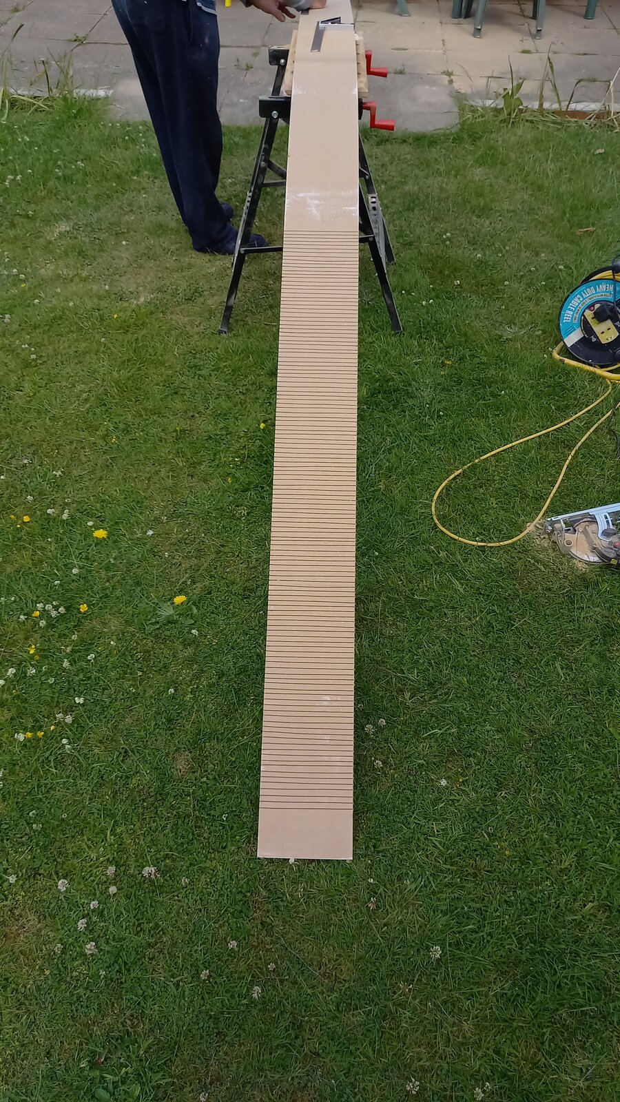

Following the first attempt I then decided to kerf cut the back board. Most information I saw on this recommended to cut the front of the board and fill, but I thought I would get a better finish filling the top edge of the board rather than cuts on the front face.
I set my circular saw depth to be just shy of the width of the top edge of the board. Using a square I then marked off at approximately 10mm intervals along the back of the board with pencil marks.
I then cut the board at the set depth along these lines. I didn't really bother to do neat job, for example running the circular saw against a straight edge for each cut. This took quite a long time but it did result in a very flexible board which could be matched more or less to the curve of the bay window.

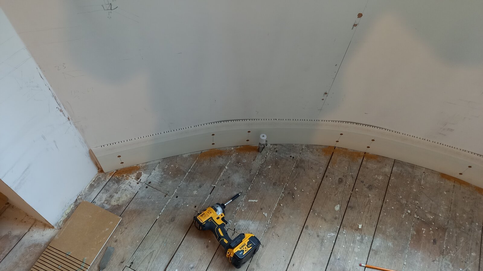

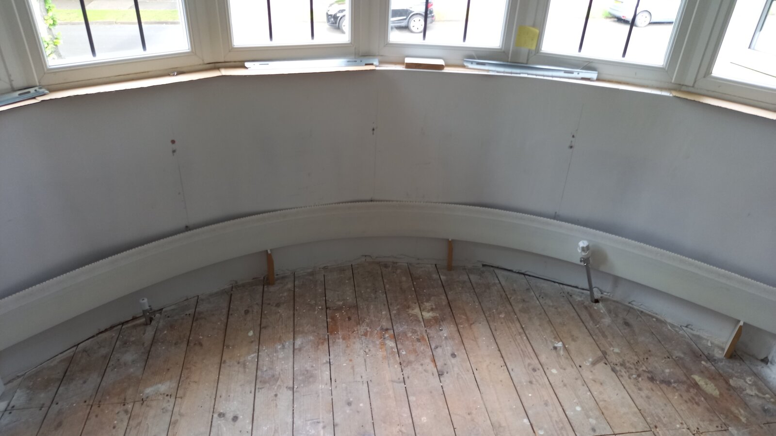

Here is how it looks when screwed into position. The hardest part from here was getting it cut to the correct length. I had to keep trimming a bit off one end with a 45 deg. mitre and offering it back up to the wall. I was convinced it would snap again but it didn't. Likewise, I was concerned I would end up taking too much off the board leaving it too short for the curve.
I was a bit worried about the gaps against the wall in the top of of the board but it was easy to fill these in, and the kerf cuts using wood filler and finishing off with decorators caulk.
The next hardest part was cutting the smaller boards (left of the curved board on the above picture), and mitring the edge to fit. This was just trial and error on a piece of scrap until I had the saw set correctly.

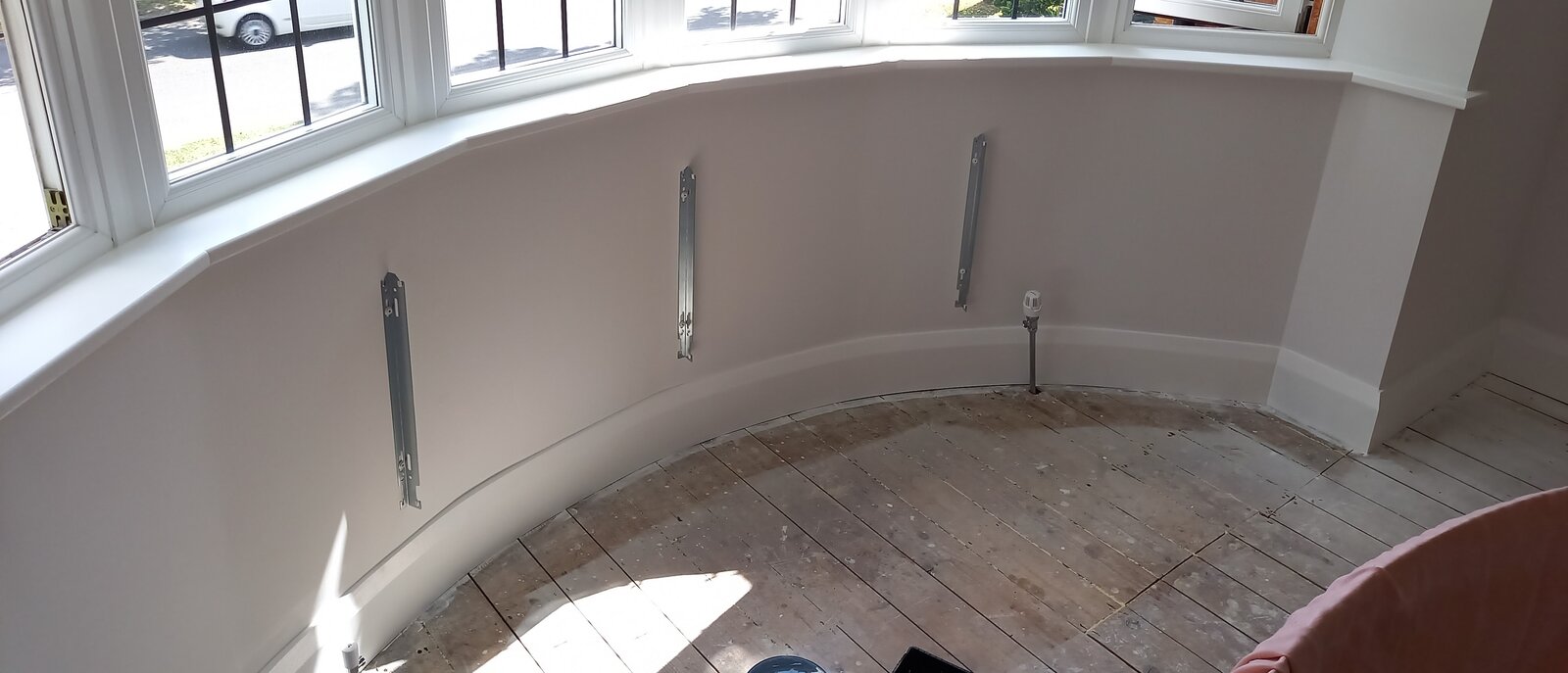

Here is how the finished result looked after filling and painting.
I used a combination of 2 pack wood filler and fine surface filler. I used the wood filler to fill the deeper parts of the kerf cuts and where I had counter sunk the screws. I then finished off with a fine surface filler as I personally find this easier to sand down.
I was slightly worried the not exactly perfect curve would be noticeable, however now the radiator is hung and carpet fitted your eye is not drawn to it. I finished off the top of the bay with a ledge also from MDF.
