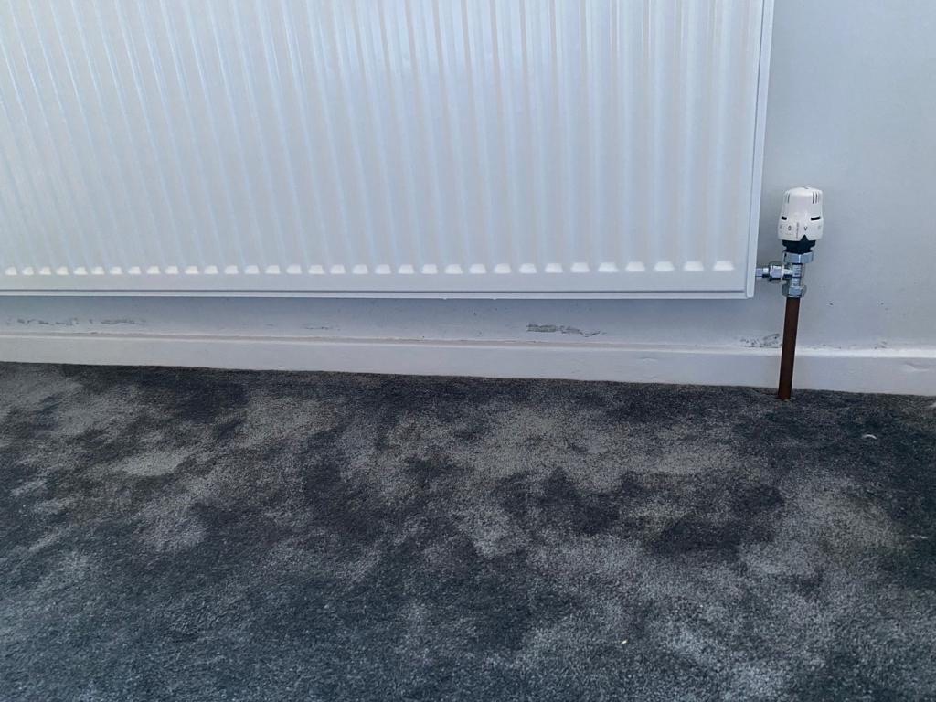

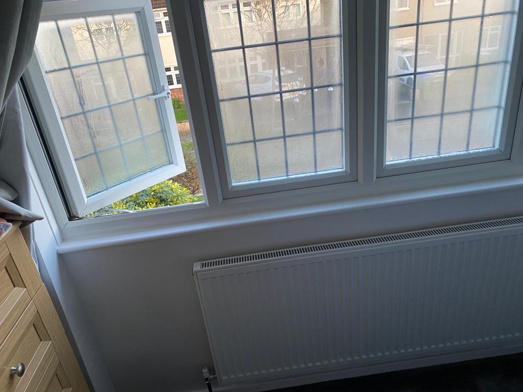

Hi all,
Looking for some advice on this as it's frustrating to say the least!
North facing bedroom. House is a 1950's built semi. Been here 15 years. No major issues with damp in that bedroom during this time apart from tiny (and I mean tiny) mould spots appearing over the coldest of winters in the corner of the bay.
Had a rear house extension in 2022 so moved out to new bedroom and daughter switched rooms into our old bedroom. Queue the madness. Redecorated the room in the summer of '23. Used Dulux Damp Seal undercoat on the plastered walls (and obviously painted over the top with normal Dulux Fluffy Clouds or whatever :rolleyes:
Now, as soon as it gets to below about 10 degrees, we're met with steamed windows and dripping walls - just in that room. Bedroom 4 (north facing and adjoining) is clear.

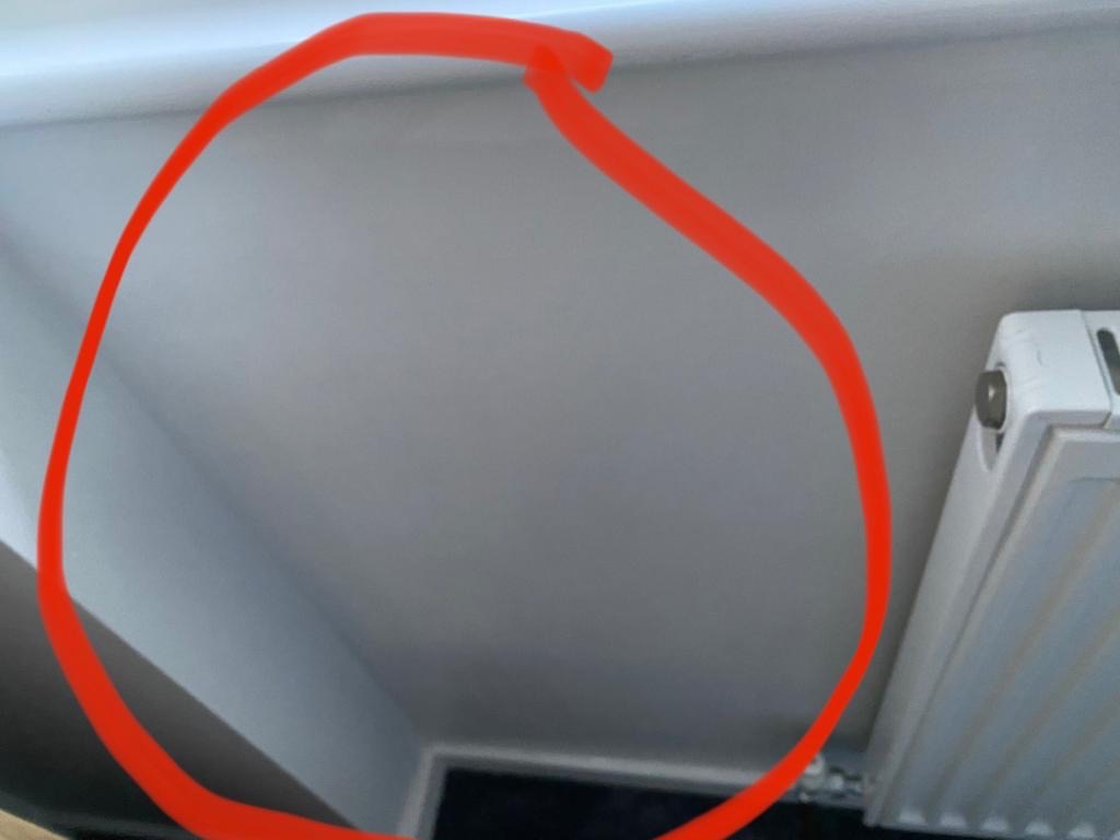

3rd image shows the bay where I painted the 'return' in the damp paint as that's where we used to get the smallest amount of mould in the bottom corner on the skirting in the winters but you can see (just) where it's circled (in images 3 and 4) that's where the wall is actually dripping wet and mould is appearing all under the radiator.
Outside wall was originally pebble dashed and has since been flat rendered over the top of that since about 2013 with no issues or cracks. Windows were done in about 2011. There have never been any air-bricks etc in the room.
Any ideas?! Got a dehumidifier running in there and to be fair, it clears pretty quickly on it's own anyway but it's odd!
Thanks in advance.

The madness is an example of how tiny changes in conditions can significantly worsen condensation. The wall breathes less because of the sealing effect of the undercoat and the external render, so the damp that is typically found in bays is trapped, keeps the walls colder and the dew point is reached more quickly. Look at chopping out the plaster internally under the windows and replacing with breathable lime based plaster. Likewise removing the external render around the bay, letting the brick dry out and re render appropriately. But from what you describe natural ventilation and the humidifier are acceptable medium term solutions, the radiator under the window should help too.

Thanks for the replies. Lifestyle change is literally us (parents) moving out of the room and eldest daughter (21) shifting from one room to another. No clothes or wet towels are ever hung over the radiator. The damp seal paint was only used on the angled wall. I've just checked up there and the walls are bone dry now after 3(ish) hours of having the windows 'locked' open but just a little bit of residue on the windows still.
