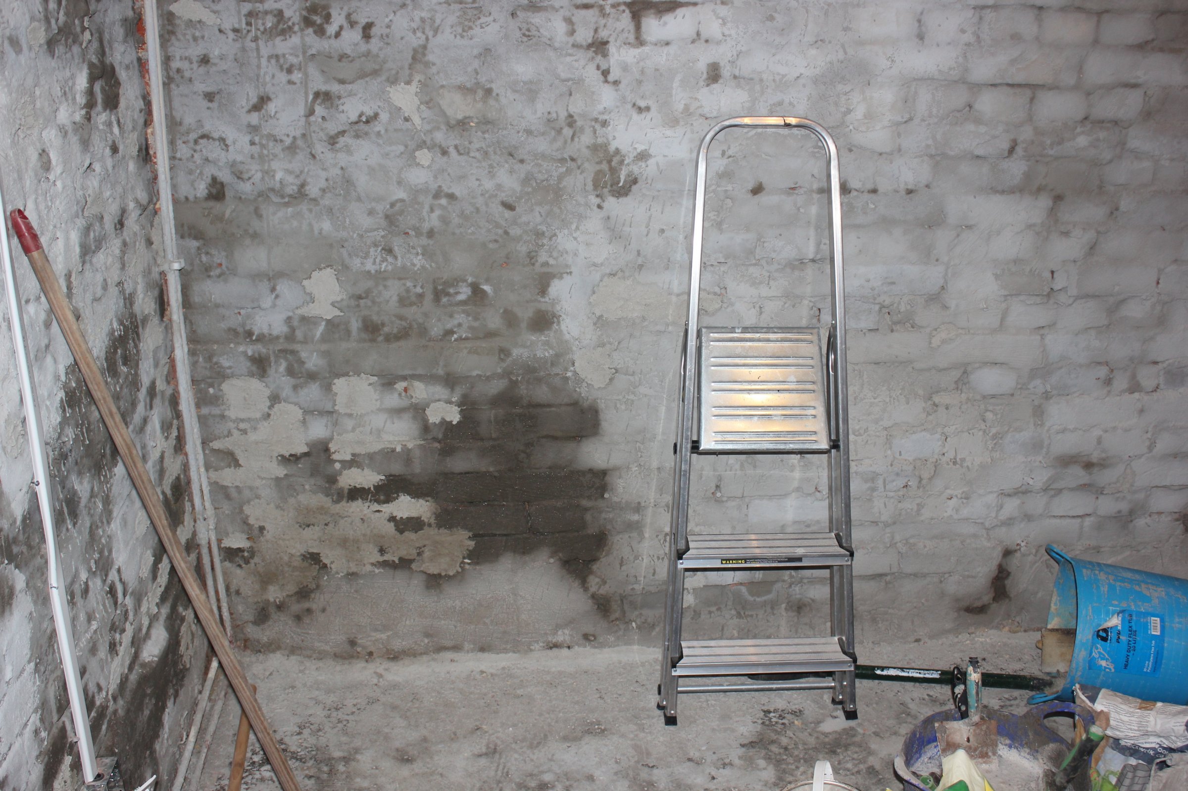

The front room of our house has had damp issues since we bought it in early 2012. We then had an large extension later that year, although the front room with damp problems was not touched back then due to finances at the time.
Our place was originally a cow shed that was converted into a two bed bungalow in the late 60's and as such the foundations on the old part of our house (aka The room in question) is only around 6 inchs thick if memory serves me correct.
Now I am not exactly sure of the damp type (i.e. rising vs. penetrative) that affected the room in question as I have not personally been dealing with it, but last May we got a plasterer in who claims to have 25 years of experience in the industry including that of diagnosing and repairing damp issues. Haven chose him, we then consequently ripped all the plaster/plaster board off to expose the bricks and then had holes spaced 4 inches apart drilled into the bottom of the walls outside what were injected with some sort of sealant/liquid or gel based damp course. This was done back in May.
Now a couple of weeks ago we had the room tanked inside after waiting a long time (many months) for the room to dry to a sufficient level to apply the tanking solution. Now this was done to a poor standard with the tanking solution mixed up incorrectly (to thick IIRC) on the first day, so they had to come back the next day to re-do it. They were only here on the second day for 3 and half hours. We also had to fill in the gaps in ourselves that the labourers missed.
We complained to the main plaster two weeks ago when the taking was done regarding the poor job his labourers had done and the general messy state that they left our room in. Now he should have been coming around later that same week to check on the progresses of the taking solution drying (what he said should only take a few days) and doing whatever is needed next in preparation for the dob-and-dab plasterboard to be applied to the walls.
We have tried phoning him regularly, but the last we heard was the beginning of last week when he said he had the flu and would be in touch. We have heard nothing since.
Also suppressing given that is Check-A-Trade rating on all four scoreable categories is over 9.9 and that all reviews he has got on CheckAtrade is also rated over 9.

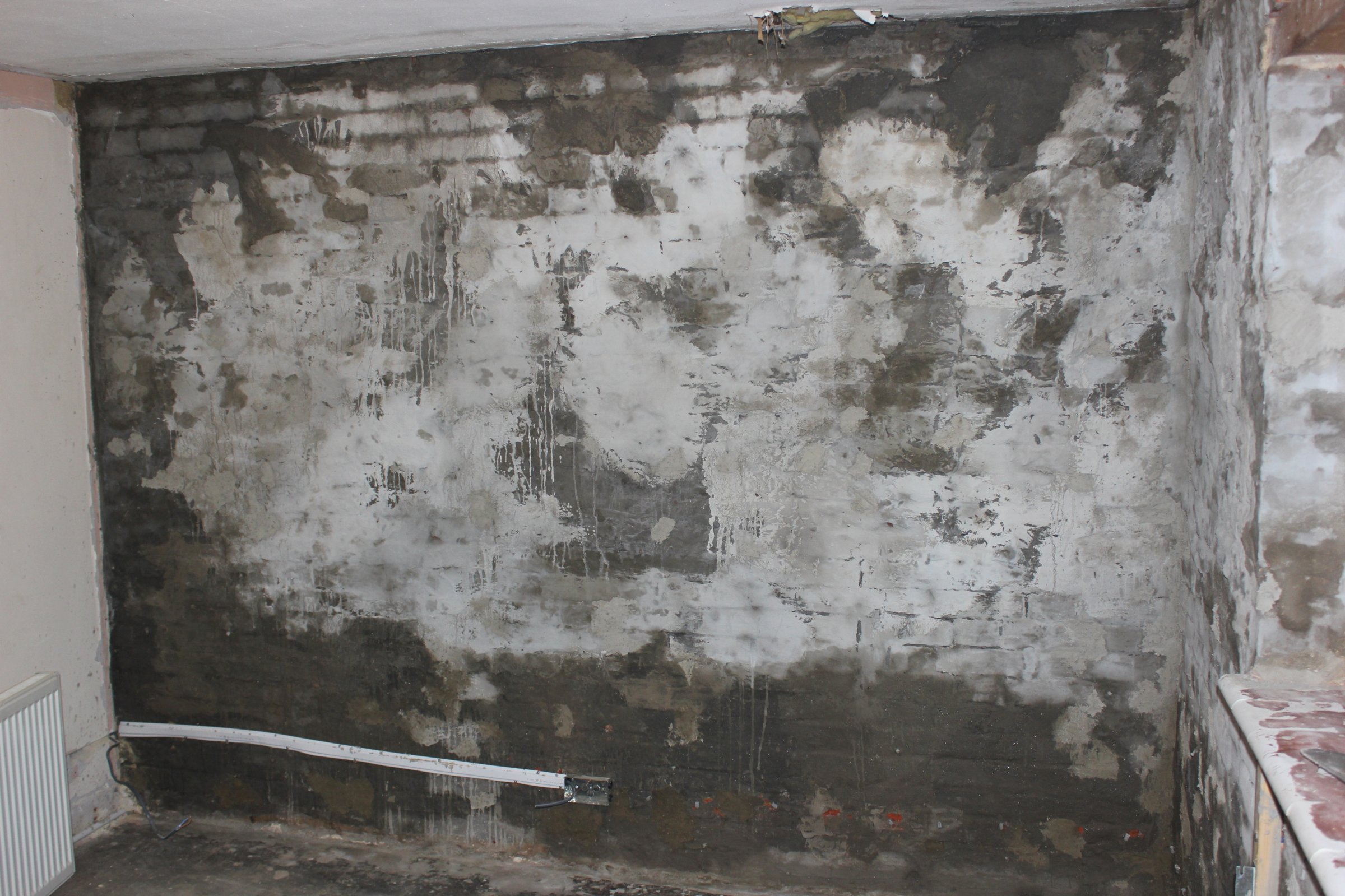

Anyway the walls appear to still be very damp still as can be seen by the pictures, although hopefully it is just condensation or very slow drying out process as the room does not have any natural ventilation (old window with no vents) or heating at the moment. It is also worth noting though that my little STIHL wood moister meter (On its bricks/mortar/plaster mode) is reading a over load when used on the damper and darker parts of the walls.
Also not sure what products have been used where, but pictures of those are also attached, All pictures at bottom of post.
Anyway, Just really want your guys advice and to ensure that everything has/is being done correctly.

Worst Wall:
[GALLERY=media, 97178]Worst Wall by eveares posted 23 Feb 2016 at 3:37 PM[/GALLERY]
Another view of the worst wall:
[GALLERY=media, 97179]Another view of the worst wall by eveares posted 23 Feb 2016 at 3:37 PM[/GALLERY]

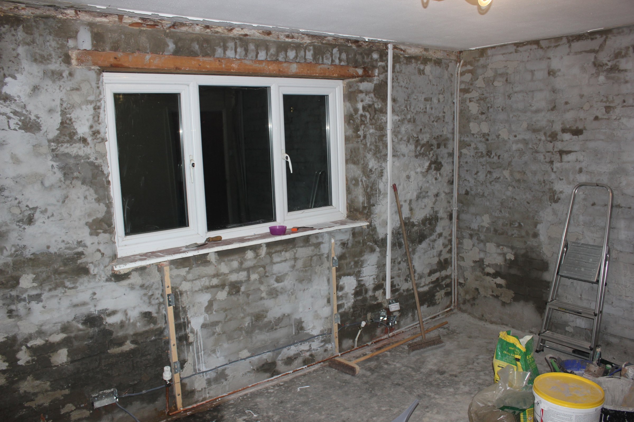

Window Wall:
[GALLERY=media, 97180]Window Wall by eveares posted 23 Feb 2016 at 3:37 PM[/GALLERY]

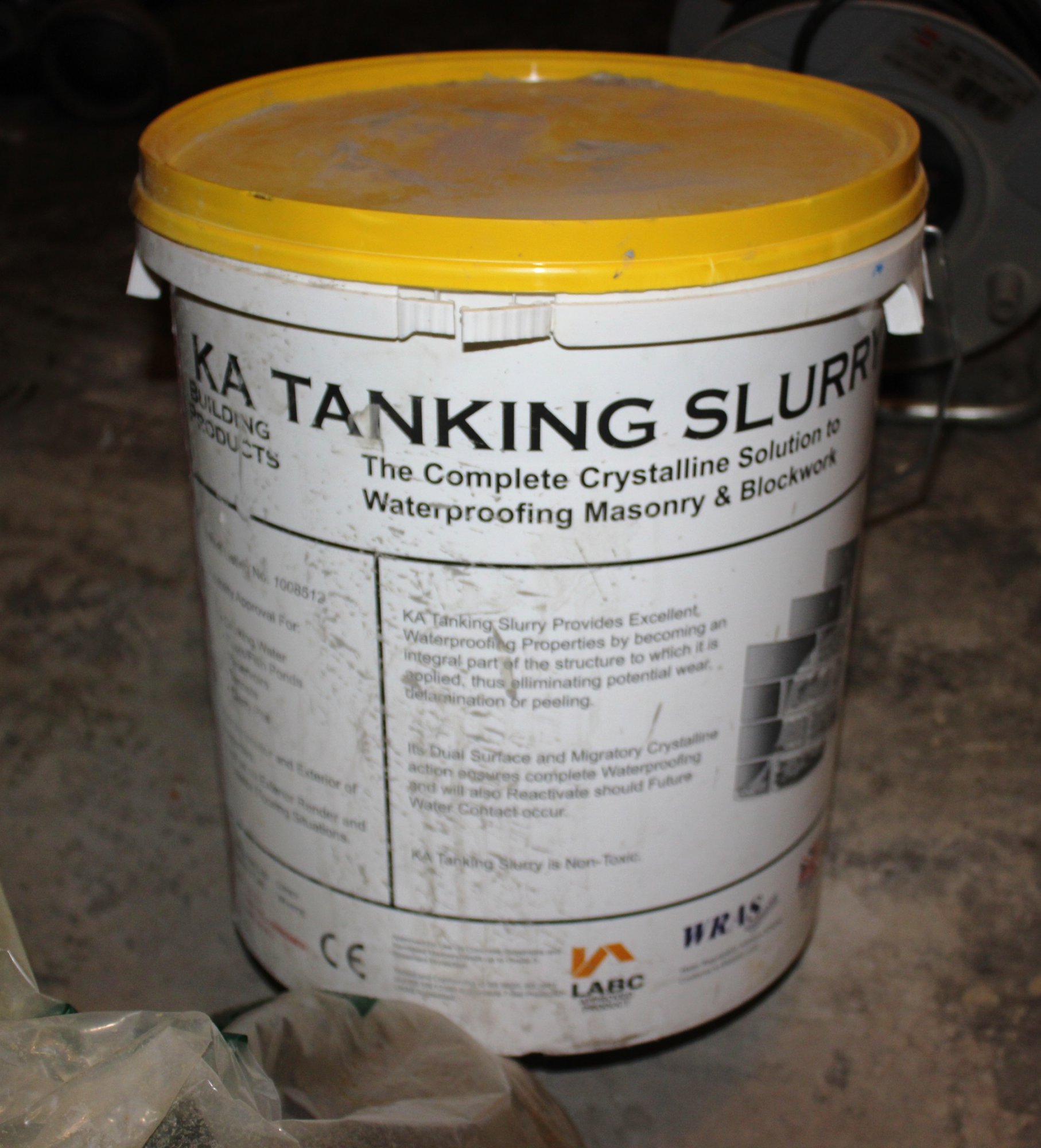

Tanking Slurry:
[GALLERY=media, 97182]Tanking Slurry by eveares posted 23 Feb 2016 at 3:37 PM[/GALLERY]

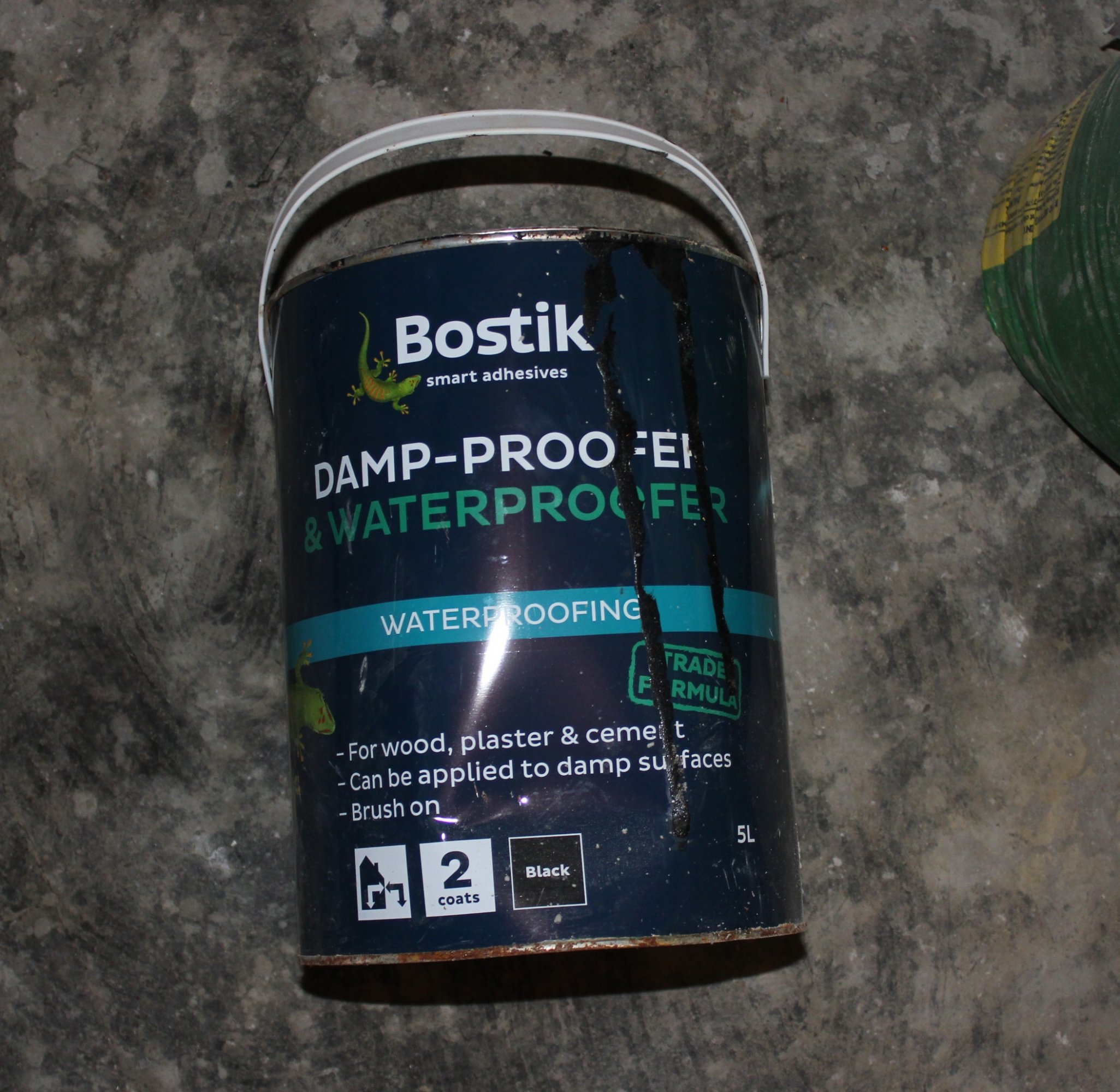

Water proofing solution:
[GALLERY=media, 97183]Water proofing solution by eveares posted 23 Feb 2016 at 3:37 PM[/GALLERY]

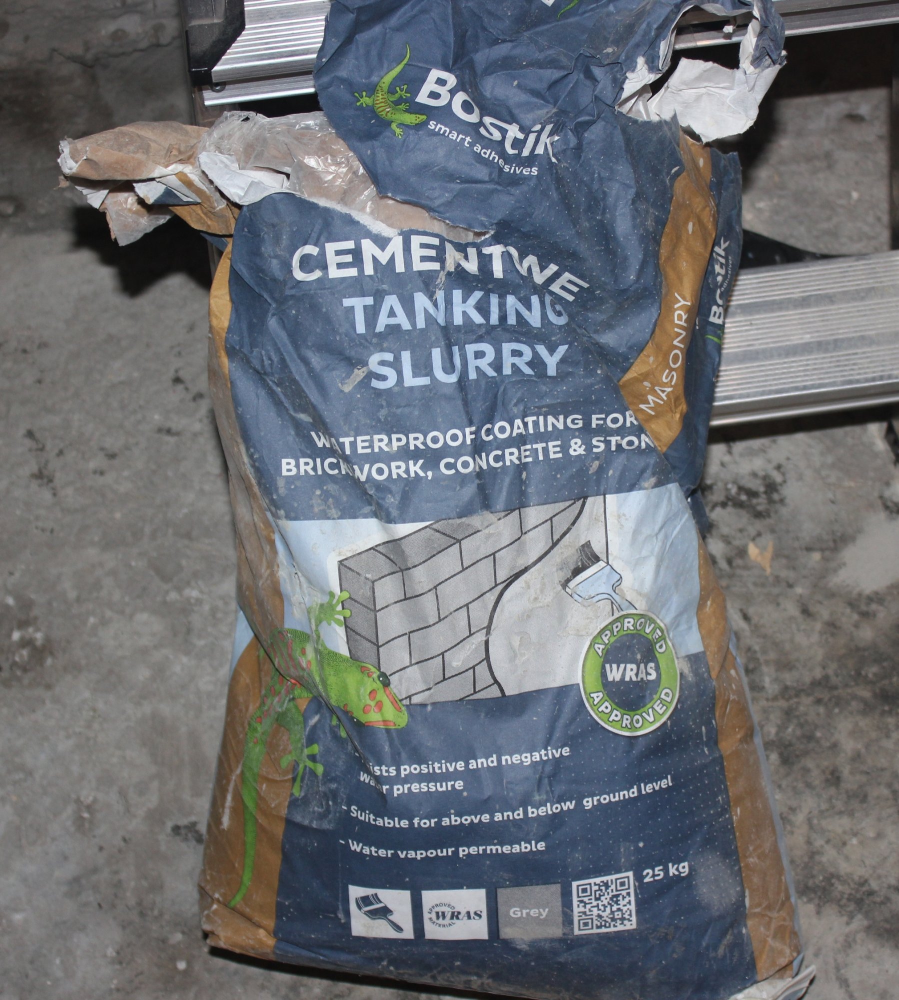

Tanking Slurry Cement:
[GALLERY=media, 97184]Tanking Slurry Cement by eveares posted 23 Feb 2016 at 3:37 PM[/GALLERY]

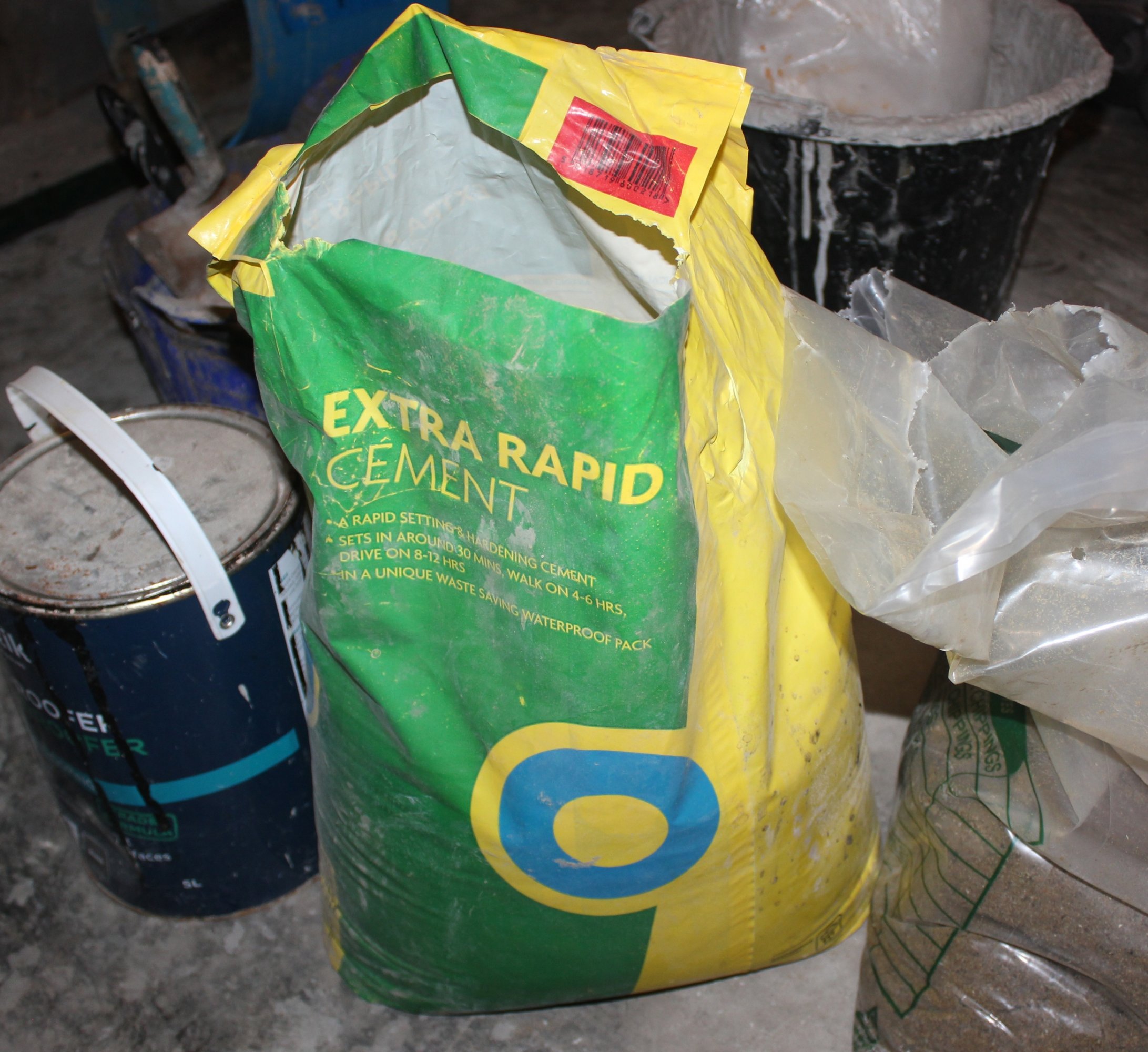

Rapid Cement:
[GALLERY=media, 97185]Rapid Cement by eveares posted 23 Feb 2016 at 3:37 PM[/GALLERY]

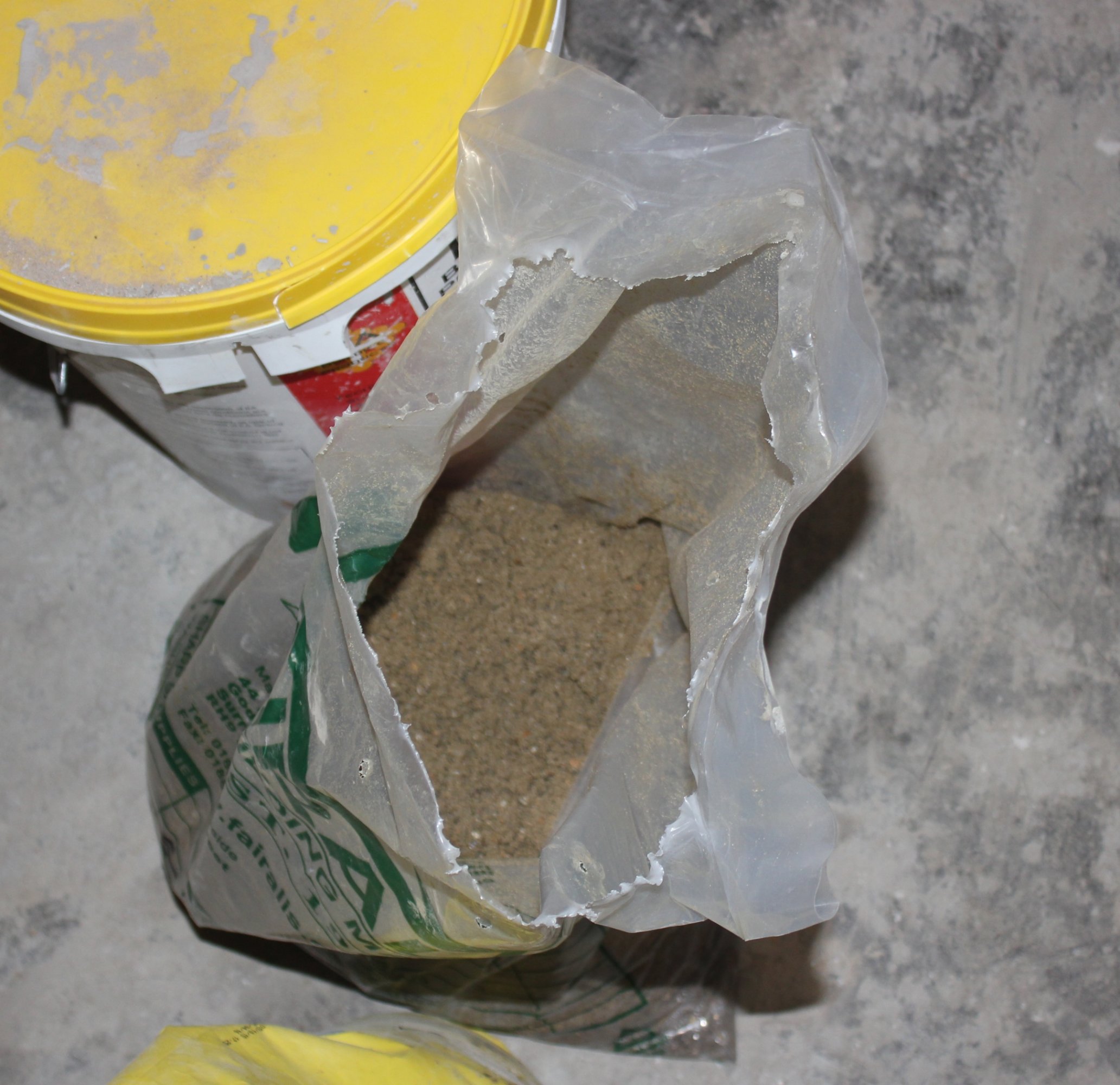

Sand from builders yard:
[GALLERY=media, 97186]Sand by eveares posted 23 Feb 2016 at 3:37 PM[/GALLERY]
