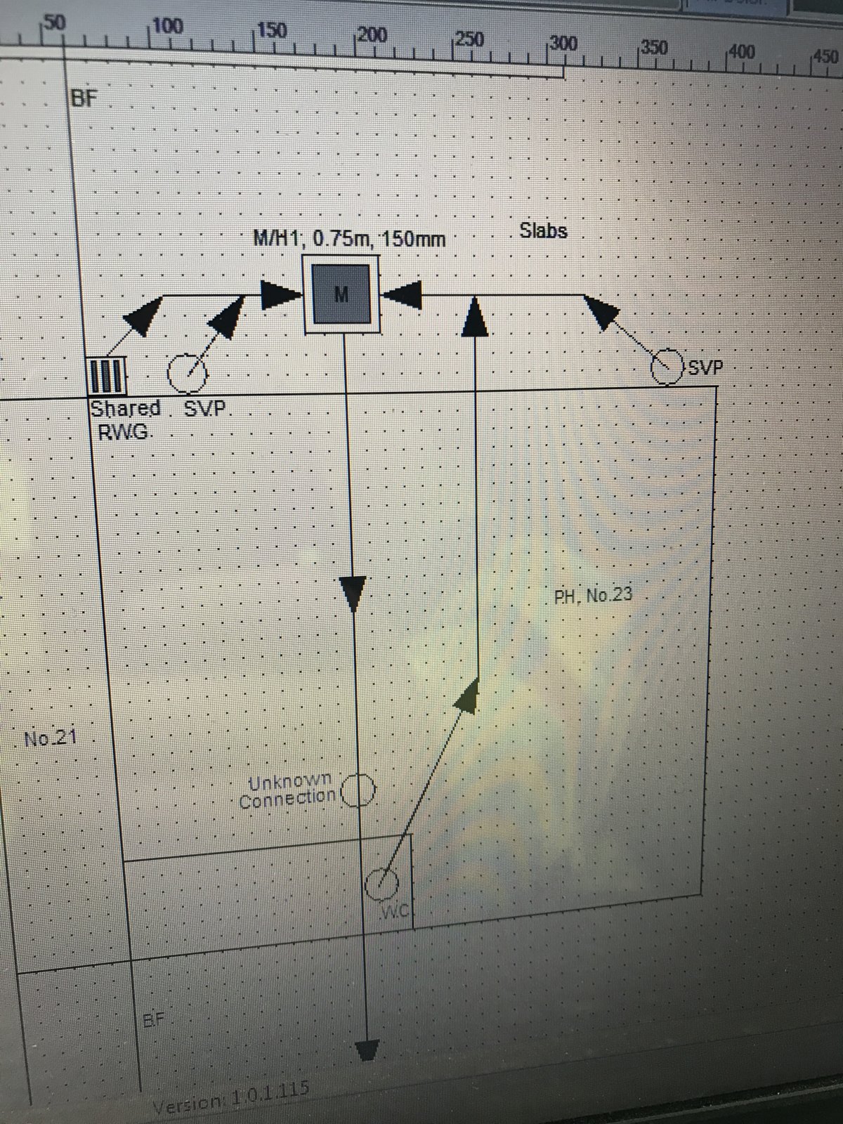

Hi
I have had plans for a two storey side extension accepted which was great until i saw two conditions appear. The conditions are:
Condition 4 - No development shall take place unless and until details of the full detailed drainage and sustainable urban drainage design including all relevant documents to limit the proposed peak discharge rate of storm water from the development to meet the requirements of the Councils Level 2 Hybrid Strategic Flood Risk Assessment (SFRA) have been submitted and approved in writing by the Local Planning Authority. The development shall not be brought into use until such works, as approved, are implemented in full and they shall be retained and maintained to a standard capable of limiting the peak discharge rate as set out in the SFRA and FRA thereafter.
Condition 5 - No development shall take place until details of flood resilient measures are to be submitted to and approved in writing by the Local Planning Authority. The development shall then be constructed in accordance with the appproved details and retained thereafter.
I feel like i am going around in circles with this as I don't know exactly what the council are expecting. I have spoken to and emailed the planning officer but he says it's not his area of expertise! I have spoken with the guy who drew the basic house plans and he said "google companies that do it"; which i did.
I have had varying responses from, that seems excessive for a small extension to £1650 + vat to draw plans not including any site visits, tests, requests for info. £1650 + vat for someone to draw something to say the water from your new roof goes here or there!
I get that i need to show the extension will not increase storm water into the mains drains and will need to show if i can use a soak away (doing infiltration test next week) or if i need rain water harvesting but how "detailed" do these drawings need to be to satisfy the conditions?
Has anyone experienced these conditions and what exactly is required? Is it detailed like CAD drawings or a simple diagram? Should the guy doing the building regs do this? Basically what will satisfy the conditions?
Cheers, Chris.

Ian H - A ground/drain survey that was done on our property in 2010 before we bought it (included in the paperwork from the solicitor) shows a rough layout of the storm drains and I know where the foul drains go as the sewer grid is at the back of the house about 3 metres from where the soil pipe comes down (had blockage a year ago and lanes for drains opened the grid). To me it all seems rather straightforward to be honest, it seems that some people over complicate things! I'm in Urmston, Manchester which i think is classed as Greater Manchester/Lancashire.

The professional drawings are pretty crap anyway, mine look like this and the ones I've seen from DynoRod and others are not much different. Just symbols for gullys, soil stacks and manholes and basic info on depth and size of pipe within the manholes.
That all does sound massively over complicated, I can't imagine Urmston is a flood risk.
Once you have done you percolation tests I can't see why the design needs to be anything more than a gully, 5mtr run of 110mm pipe then a square labelled soakaway. I'd have a go yourself.
Whoever did your plans should have done this as part of his design work.
Anyway, its a very basic drawing showing the drain runs and connections (new and old) and you say what amount is going down the new drains.
You state that rain water from your new roofs is going into a soakaway (1m3) and thats it. No ground tests required. You then just add a sentence or two about the water perculating the ground and dispersing.
Read the council's flood risk policies, pick out key phrases and items, and just refer to these and how your work complies. Nothing lengthy or involved.

Those drawings do look quite basic (i'm sure even i could do that :)). Urmston a flood risk; i know right! We had to have a flood risk assesment done as a part of the planning process because we are in flood risk zone 2 mainly due to us being "close" (not that close, maybe 3/4 mile-1mile!) to the Manchester Ship Canal. These were the drawings from that survey in 2010 - i've added the red comments.
