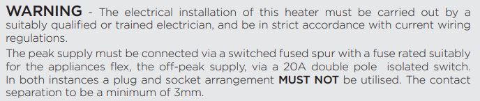

I have old storage heaters in my house that are all properly connected to off peak E7 supply via there own fuse box.
As the heaters are old, arnt cost effective and have little control, i was looking into changing over to the dimplex quantum range.

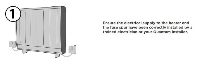

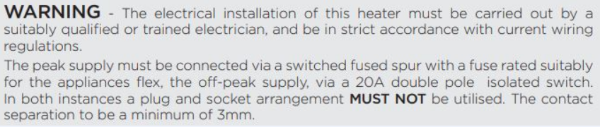

I have noticed the quantum range has an off peak connection and a peak connection.
Can the peak connection be connected to a 13A plug and plugged into a wall socket?
The off peak isnt a problem because its already set up.
If the peak connection cant be plugged in to the wall then I guess new spurs will have to be wired into every room? (Which I dont really want to have to get done).
If thats the case can anyone recommend a storage heater that has the control and efficiency of the quantum but with just the off peak connection.
Appriciate you reading this and any help / responses
