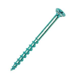

4.0 to 4.5mm x 40 to 50mm chipboard or flooring screws (I tend to use collated flooring screws as I have a collated screw gun which can be used standing up ). I always go 150 to 200mm centres, which is maybe belt and braces, but I don't believe in skimping. You need to ensure when screwing the boards down that the boards don't "jack up" off the joists. An impact driver helps with this, as do flooring screws with an unthreaded top section of the shank, although they do cost a little bit more than fully threaded chipboard screws:What screws do you fix 3/4" ply down to CLS with? @ what ctrs?

Yes. You need to ensure that the board doesn't jack up off the joist, so the more weight you have near to the screwing point the better. The faster you drive the screw the better, too, which is why tradesmen use impact drivers (typically 2800 to 3600rpm) as opposed the cordless drills (typically 1200 to 2000rpm). Make sure that you drive the screw heads in flush first time - if you need to back the screw out and redrive it, reposition it a couple of millimetres away as half the time it won't flush properly second time round

An SDS is too big, too clumsy and too slow (at about 900rpm). You really do need a at least a half decent cordless drill/driver to do a floor, preferably a (faster) impact driver. You can get by with a slower drill/driver and a combined drill/countersink bit (such as a trend Snappy), but you may find yourself having to drill and countersink every hole in the chipboard before driving the screws and that makes the 60 minute glue advisable as it is going to take a while to drill/countersink then screw down. Can't you beg or borrow one? You have a lot of screws to drive - 50 per sheet (on 200mm centres) to 63 per sheet (150mm centres) - and ideally you need to get as many screws as possible in before the glue cures, especially as D4 glue expandsMy cordless batteries are getting on a bit, but have a 240v SDS, would that be ok?
