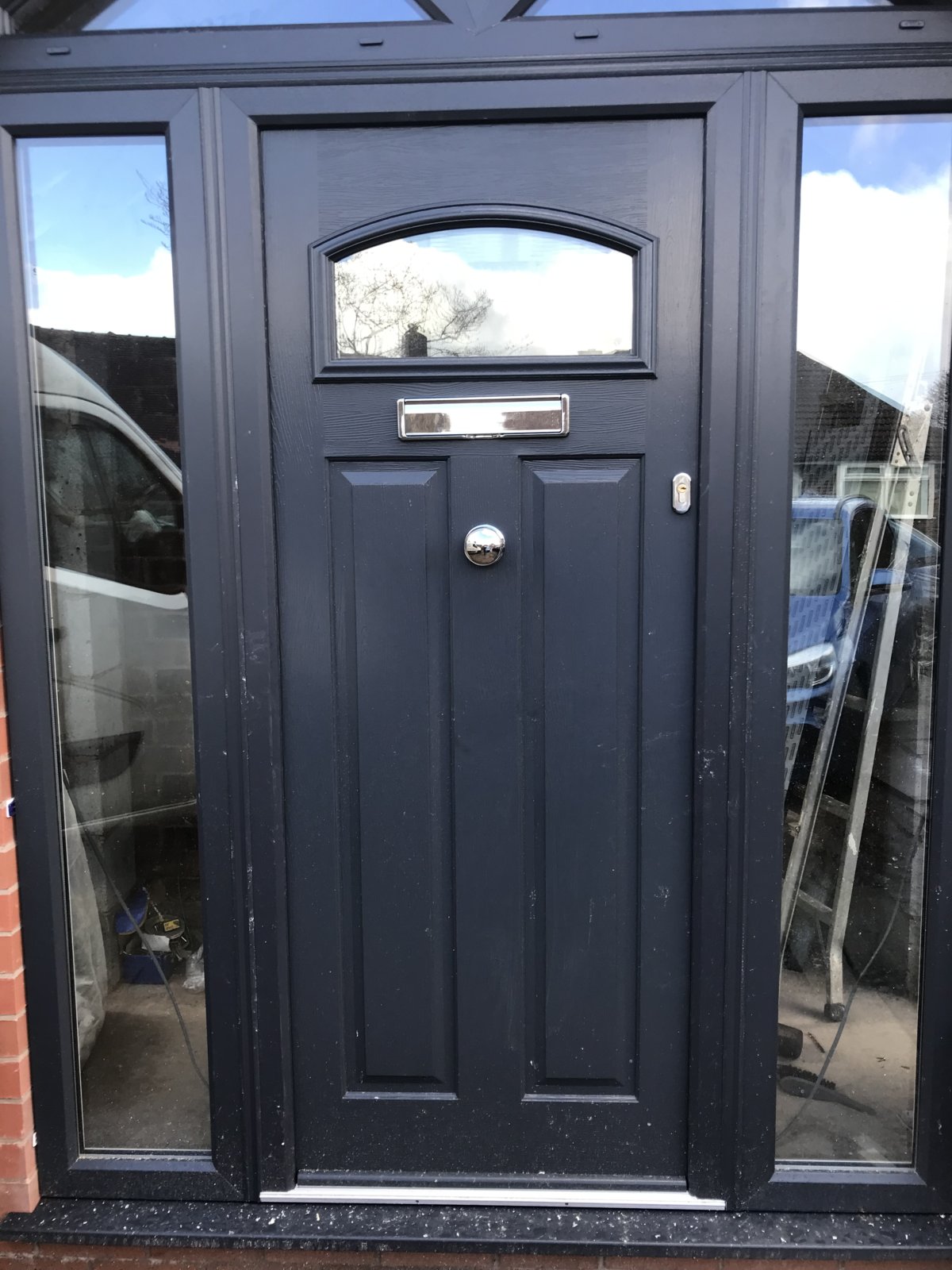

A centre doorknob is for pulling the door shut. It does not operate the lock or latch.
On an older house with a panelled door, it adds to the grandeur
for example
the door in the picture does not have a keyhole or external handle, it cannot be opened from the outside.

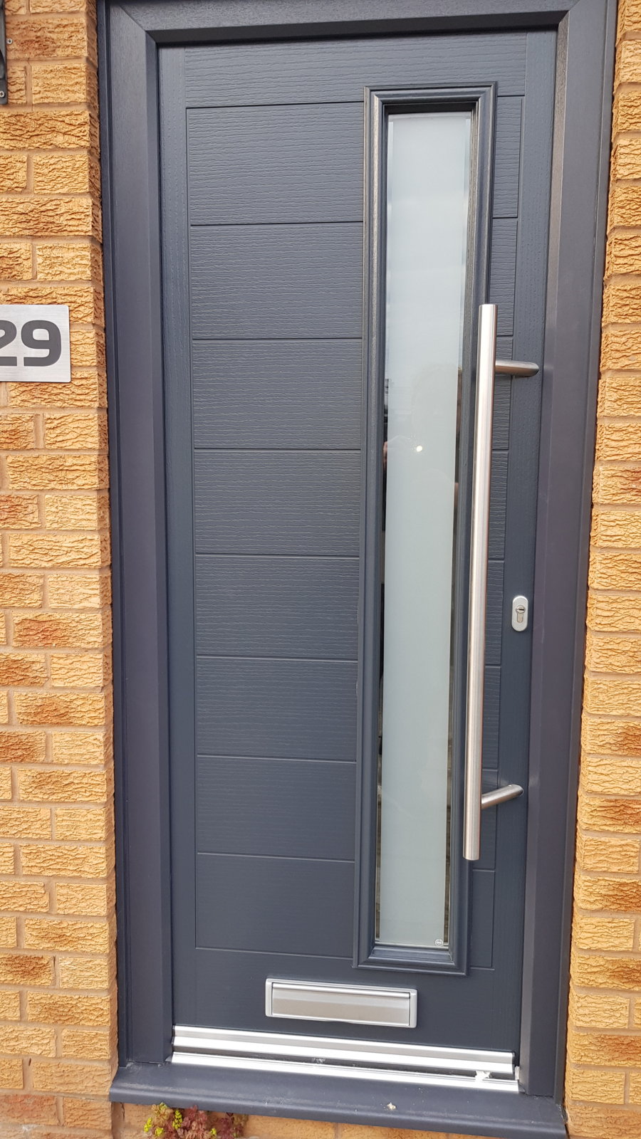

You must have one of those fancy slam locks too, what's your thoughts on them, good bad indifferent? I have one on my composite door as it's got a 1200mm pole handle, I'm impressed on how it works

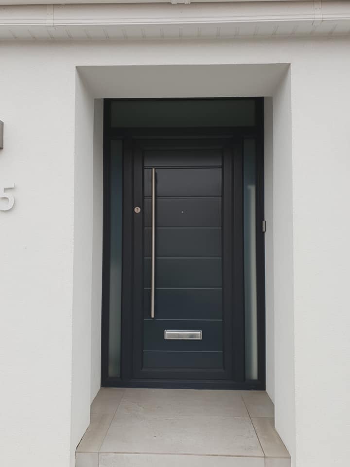

I think it’s a Winkhaus.
I like it, but, I haven’t locked myself out yet. I have gone to answer the door and forgot to take the key which I find anoying, i’m going to swap the lock for one with a thumbturn on the inside.
Yes I have thumbturn on mine, and yes it's winkhaus as well, AV2 I think, you can get them in remote control, push button code and key fob too
I see the letterbox is conveniently close to the lock, which will save effort for anyone wishing to operate the thumbturn with a simple home-made tool.
Yes but there’s another door after that which would be harder.
Yes it is, that’s how it came but I haven’t bothered to look how it’s fixed yet.
I have the same sort of setup, with the same lock.
I'm not a massive fan in the end. The door has needed endless adjustment, and still isn't right. A push from inside, or a pull from outside is required to get it to unlock easily, or you are fighting with the end of a thumbturn.
Also unless you slam it shut quite hard, it doesn't fully catch, and you then need to lean on the bar handle to get all the points to 'click'.
Also, as it's anthracite, things get worse when the sun has been on it for a while.
Kicking myself for not spending more and getting an aluminium setup.
Ah none of those latching issues on mine, wonder if because yours is a PVC door with an infill panel its flexing more without latching, where as a composite is more solid. Mine is directly south facing too
More likely because of the sidelights and toplight? The frame has steel in it, but I guess as it's not welded in there its of little help. I can flex the frame if I push on it, so that could be the issue. I really wish I'd gone ali frame now, lower profile too!
