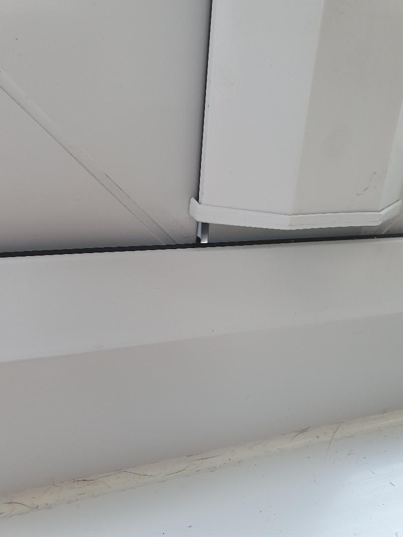

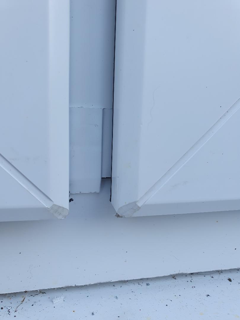

I am looking for some help (Thanks in advance) fixing my draughty uPVC patio door. It is draughty from the bottom centre and daylight can be seen through the door, however I am not sure what I needs to done to stop the draught. These pictures are of the bottom of the door:
Pic 1: Inside Looking Out (door shut)

Pic 2: Outside looking in (door shut)

Looks like the door needs adjusting. Now problem here is it could be the master door or the slave door that needs adjusting, and it could be just adjustment on the hinges or maybe the door glass hasn't been packed ( toe and heeled) properly.

If the glass is not packed properly ( toe and heeled ) it can cause the door sash to drop. Toe and heeling is exactly like a diagonal brace on a wooden door...designed to keep the door level
Looks as if the door isn't square with the frame. Is that gap still there when you lock the doors (push the handle up)?
Thanks for the responses, however it has prompted a few more questions. What adjustment is required (assuming it isn't toeing/heeling)? And how do you actually make it seal, I.e. not draughty
The adjustment should be on the hinges , and when both doors line up correctly there will be no gap... however full compression on the door seals will only happen when the locks are fully engaged.
You may need to post pictures up of the hinges so you can be advised how to adjust. If there is adjustment on the hinges then try that first, if the door sash moves and you get a repeat problem then I would be thinking it would need toe and heeling . Another thing to check is the physical condition of the hinges, eg are they broken , coming away from the frame etc

Thanks roonicabers. Pictures below of the hinges and doors from the outside:
Well they are fairly easy hinges to adjust. Open the door and look at the hi ge from inside and you should see a screw holding the cover cap on. Under screw and carefully prise the external cover cap off the actual door sash . Once fine you should see some Allen key adjustments
. Before you do adjust them though , with a pencil mark where each door is sitting in the frame. This gives you a point to return to if everything goes wrong!. Never adjust more than half a turn at a time and normally the centre hinge won't need adjusting. Your biggest problem is working out which door has ' dropped ' and which to adjust. Are either of the doors catching on the bottom of the frame?
Thnks again for your help. I Managed to have a look at the Doors post xmas and measured the distance from the glass on all corners and as expected the door does not appear to be sitting square in the frame, so looks like I need to make some adjustments.
My only questions is how do these doors actually fully seal so that there is no draught and they are air tight? Looking at my pic 2 in my OP there is a gap underneath the shorter piece of plastic (on what I believe is a mullion) that looks like it would still not be there if the gap at the bottom is removed or am I missing something.
