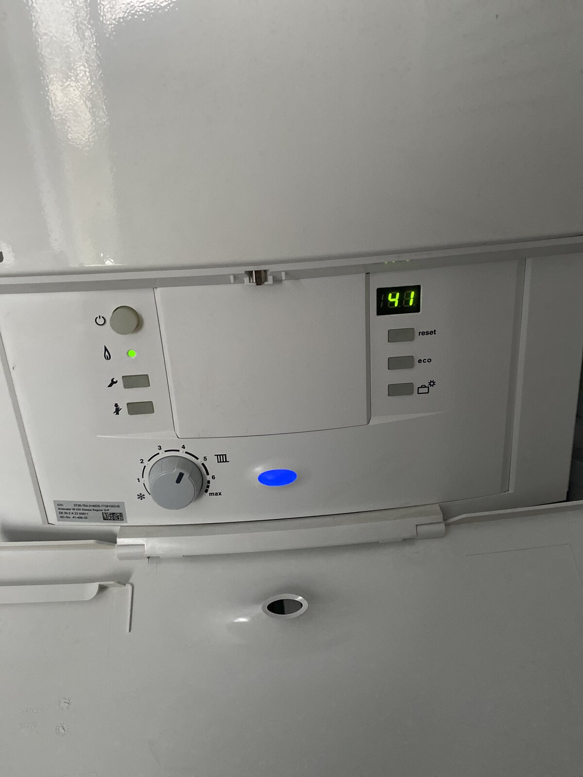

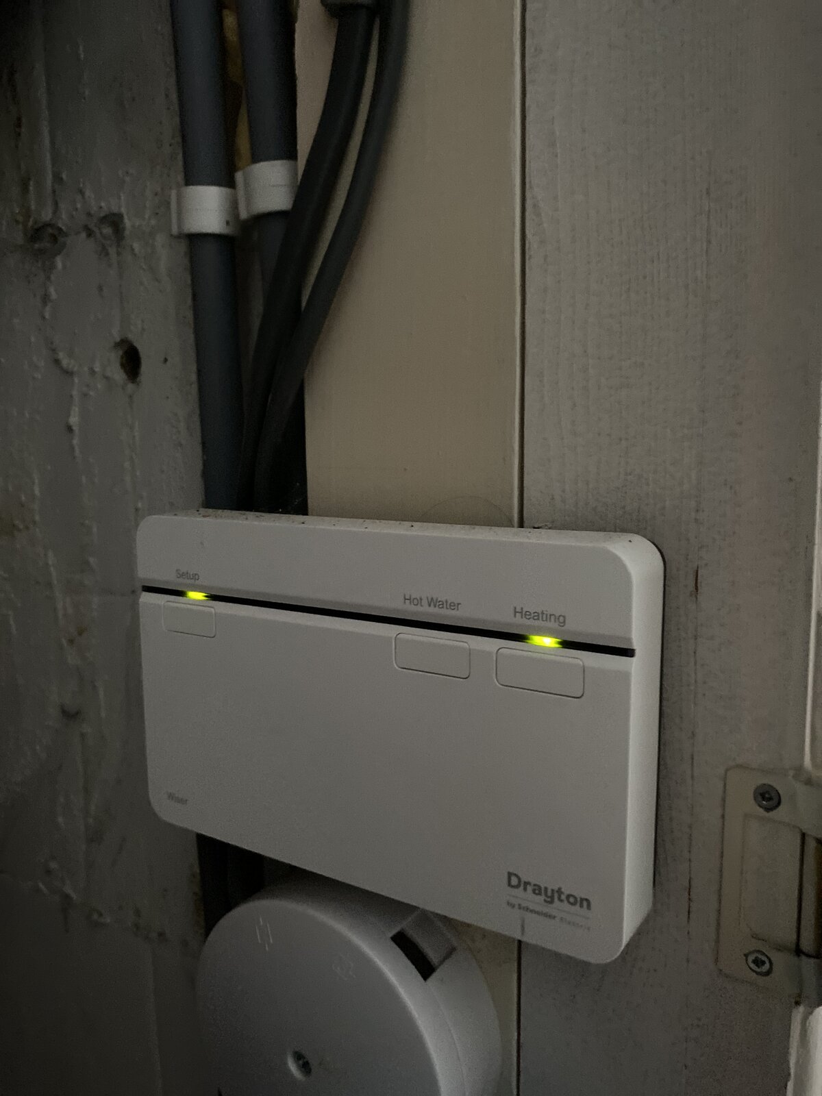

This is what I'm observing....
Wiser starts calling for heating, boiler starts up, burner indicator is on. The heating circuit solenoid is open, and water is circulating around the radiators.

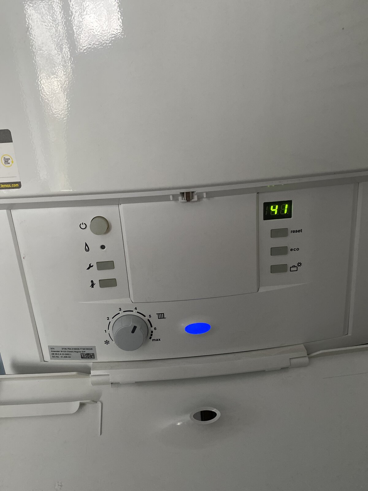

Then after 2 minutes, Wiser stops calling for heat (Heating light on Wiser control unit goes out) and the burner light on the boiler goes out.
As you can see, the water temp hasn't risen in the 2 minutes the burner light was on.
The boiler continues to 'operate' for another 2 or so minutes, I guess in some kind of post-cycle cooldown. The pump is still operating (the solenoid has closed on the heating circuit, so during this post-cycle phase the boiler is just pushing water around a short loop via a divert valve).
Then eventually everything goes quiet again!
Then ten minutes after the boiler initially kicked in, it all happens again.
I tested what would happen if I increased the demand for heat (by setting a room thermostat very high) - the first two minutes of the boiler starting up is identical, but then there is an audible change in the burner where it clearly ramps up the burner and the water temperature starts rising as you'd expect it to.

SP is set point. It may not show that on your display when you turn the rotary dial but looking at the setting, probably ~ 60/65C.
If you mean the heating zone ("solenoid") valve has closed then this is not right IMO as this is controlled by a roomstat and should only close when the room temperature exceecs the roomstat SP (setpoint) temperature.

Thanks. I think the Wiser unit is acting as the room thermostat in this instance, though, so essentially when the Wiser stops calling for heat that is the same as a room thermostat reaching temperature. So I think the solenoid closing is probably right in this case?
It’s the hubr that calls for heat based on what the room or radiator thermostat is detecting the room temperature is. I think the hubr uses the information from the thermostats, mixes this info in with what it thinks are the room characteristics and then decides to fire the boiler or not.
