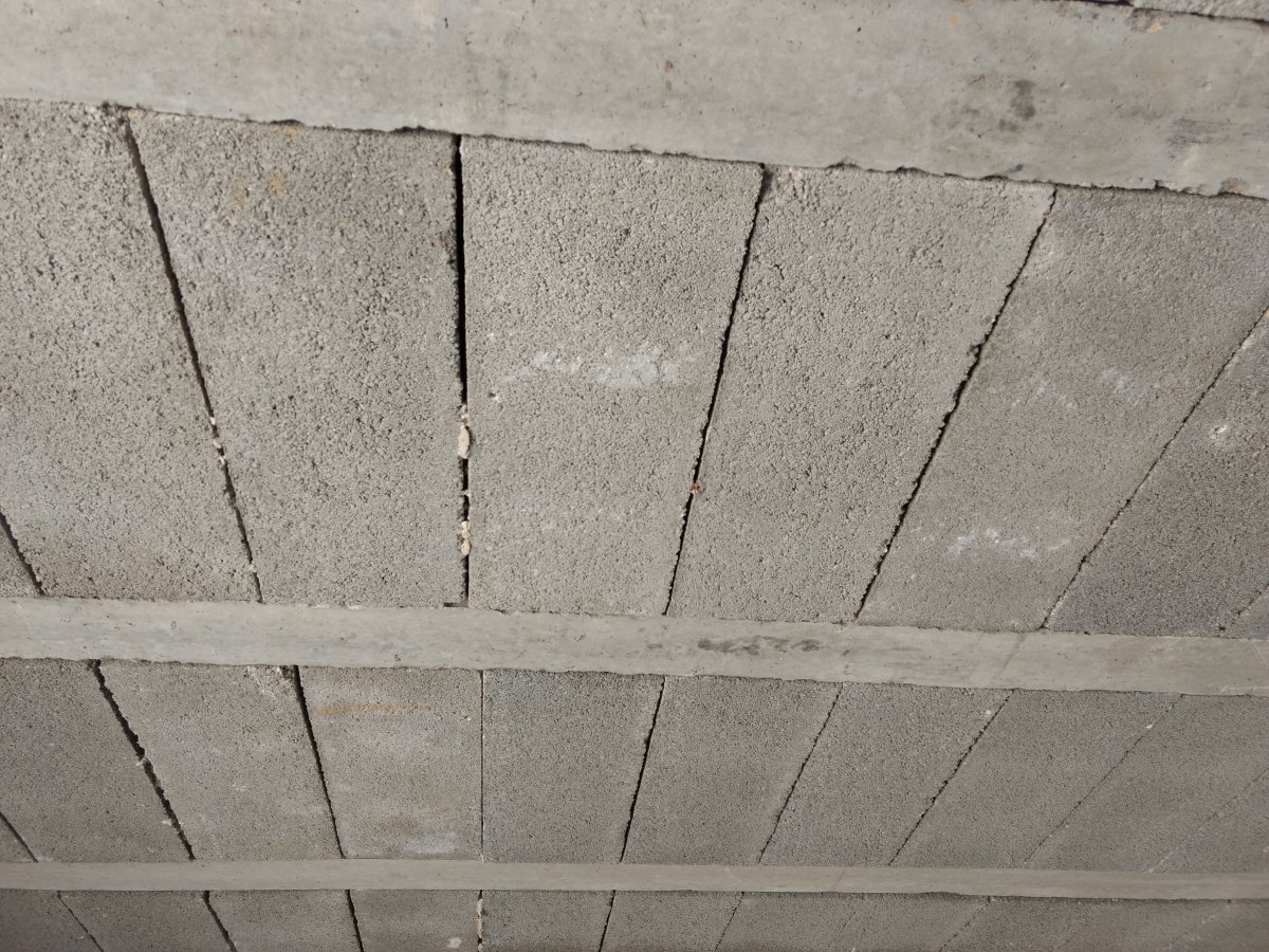

My garage has a beam and block ceiling. To make it 'nicer' I plan to install a plasterboard ceiling under it. With it being so big (roughly 8m square) I'm not sure how to go about it.
The two options I see are:
1. Wooden battons screwed to the beams, then attach plasterboard to those. I'd like room to run some LED spots though, hence battons would be 5cm to 6cm thick.
2. Some sort of metal framed plasterboard system (British Gypsum offer one...no doubt there are others)
Is one solution better than the other? Or is there a better way?

With regards to ceiling have you got a picture of the ceiling area, as I do not know what is meant by block/beam, is this a solid construction? That would require masonry fixings?
I'll post a picture later today. Here's how it works though: http://forterra.co.uk/structural-precast-concrete-flooring-stairs/beam-block-flooring
It's comprised of re-enforced beams tied into a steel 'belt' at the edges which runs around the entire property. Between those beams are concrete blocks like breeze blocks but designed for the job. A slurry is put on top follozed by a 10cm screed.
It's very solid and would require masonry fittings.

Here's a picture of the existing beam and block ceiling under which I want to put a more aesthetically pleasing one.

It's a garage, and if you intend to keep it like that, then insulation above the plasterboard isn't necessary. There's not much risk of fire from the LED spots, and certainly not of anything getting through the beam and block floor. If you use wooden battens to fix the plasterboard through, then you just need a few notches etc to get the cables across the ceiling, and the battens would hold the cables up better prior to plasterboard going up. The only problem with the using battens, is working out where the spots are going to go, so you don't pu a batten in the wrong place. Supsended ceilings give more flexibility though.
You can fix the battens quite easily using concrete screws, and just drill into the blocks using an SDS drill.

Thanks for the replies. I'll be going with some sort of metal framework for the ceiling. Lafarge also make a good looking one I've become aware of and with fitting that fit between the ceiling blocks - no drilling required, hence even quicker.
As for why the downlights....I don't need a 60m2 garage. But I wouldn't mind a games area and maybe even a small 'bar' in there! :)
It turns out Lafarge make a galvanised steel suspended ceiling system designed for beam and block. The + is that rather than having to drill (aside from the rails around the walls) all ceiling fittings are simply hammered between the existing blocks thereby making it much easier.
