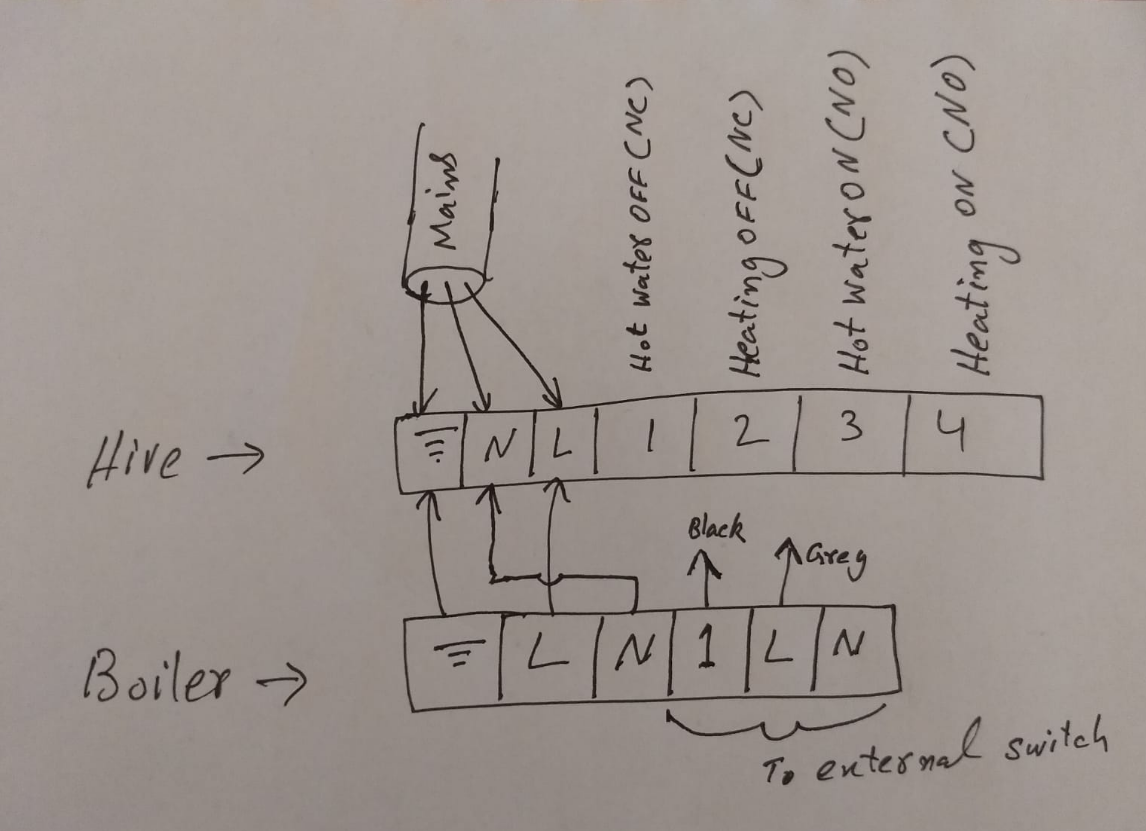

Hi all,
I have Vitodens 100-w and its combi boiler. But, I have got hot water and heating version of hive. Main supply lines were coming directly to old thermostat and then were going to boiler main supply, I have kept it same in the diagram below.
Please guide:
Where to connect 1 and L from boiler to hive?
Thanking in anticipation

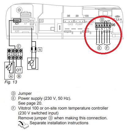

However, your boiler does have 230V control, so the Dual Channel can be fitted, however the hot water functions whist present at the Hive, won't actually do anything. So personally, if it were me, I would exchange it for the Single Channel version, that doesn't include the separate hot water control.

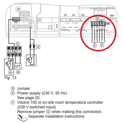

The 230V supply for the Hive (N) & (L) comes from the boiler (N) & (L) terminals included in the group marked with the 'F'
Hive terminal (4) 'Heating on' connects to the terminal marked (1) included in the boiler terminals marked with the 'F'
I assume by "external switch" you are referring to the existing room thermostat, that should be disconnected. The jumper 'D' is not required and will have already been removed when the existing external controls were added.

Boiler is “Vissemann, Vitodens 100-w, WB1C 26 kw – combi boiler”
To access boiler wiring terminals, I just have to open front panel attached with two screws. The panel is not sealed and just have soft pads on the edges.
Yes, existing thermostat is been removed so the jumper ‘D’.

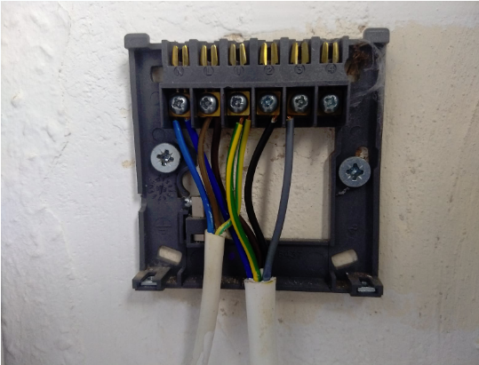

This was my old thermostat connection.
A 5-core cable is coming out of the boiler (I haven’t removed it yet):
- Brown is connected to L on group E on boiler
- Blue is connected to N on group E on boiler
- Yellow is connected to earth on group E on boiler
- Black is connected to 1 on group F on boiler
- Grey is connected to L on group F on boiler
As in the picture, the power to the boiler and the external thermostat is common. Can I power Hive the same way (earth will go on parked terminal on Hive)? If yes then where the black and grey will go on Hive?

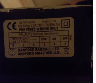

What make / model is the existing thermostat?
Whilst the backplate is 'universal' the way they are wired varies from thermostat to thermostat (as you can see if you compare the dual channel hive with the single channel hive)
Also where does the 5 core cable go? There appear to be two 3 core cables at the thermostat. Where do they go? Is there a junction box somewhere where all of the cables terminate? Earth wires should never be connected to the live backplate terminals of the thermostat, so my guess is that they are not actually connected to earth at the other end.

Don’t remember name of the old thermostat and I am not home to confirm, sorry if its inconvenient in anyway. Connections on the old thermostat are like this:

...I intend to do it the way I have drawn in the first diagram in the post and don’t know where to connect black and grey on Hive.
Thanks, that clarifies the thermostat, but also where does the 5 core cable you refer to go? There appear to be two, 3 core cables at the thermostat, making 6 cores.

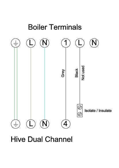

You won't need to use the black wire with the Hive dual channel, if connecting it to the existing thermostat wires connected as you describe.
EDIT
Regardless of that, if you can achieve the below using the existing thermostat wires, then you are sorted.
The reason the black wire is not used here is because it provides a live, and in the case of the existing thermostat wiring, this has already been connected to the L at group E, so there is no need for a second L from group F.

Was writing the reply to your first question and in the mean time you posted the solution. For benefit of someone in similar situation, I will still answer to your question "where does the 5 core cable you refer to go" and answer is:
"3-core is main power supply directly coming to old thermostat. 5-core joins from old thermostat and goes into the boiler (taking the lead from old thermostat joints N, L and E) (same as very first hand-rawn diagram above)." Also, in picture it appear to be 6-core but actually it is 5-cofe.
