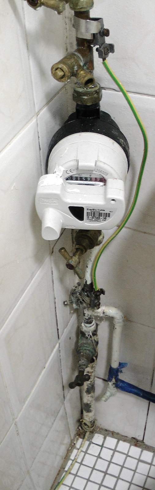

We recently had a water meter installed by the stopcock where the water supply enters the house. The installer cut the original earth cable that was attached and replaced it with a thinner one. The original cable came from under the floorboards and presumably was connected to the consumer unit. The new earth bonding doesn't actually go anywhere (see photo). I emailed the water company and they phoned to say this is correct. Is it?
