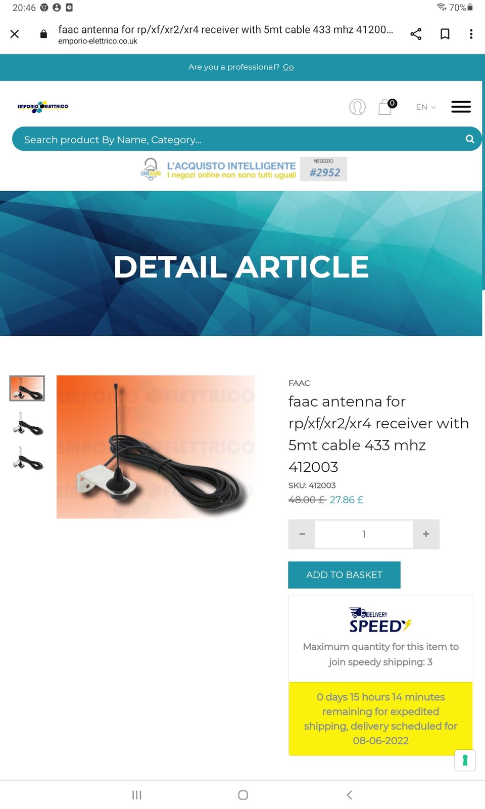

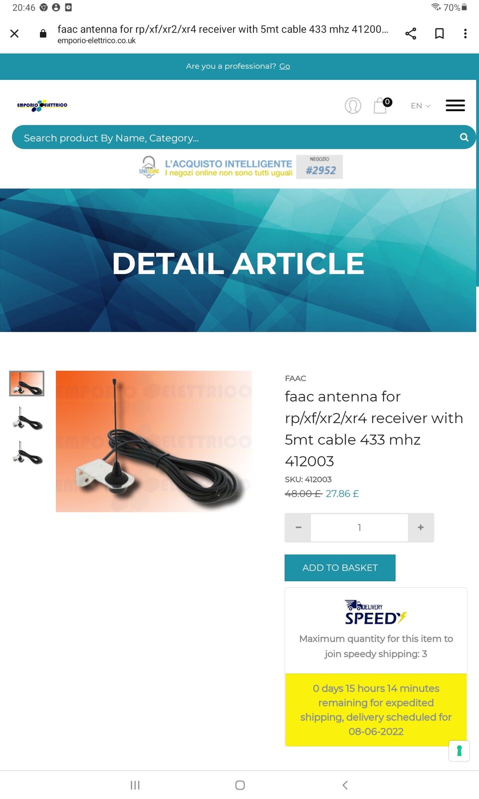

Screenshot_20220606-204622_Chrome.jpgcheck compatibility with your receiver, you could always piggy back another receiver and transmitters onto your setup.
View attachment 271515check compatibility with your receiver, you could always piggy back another receiver and transmitters onto your setup.
I don't have an external aerial, and I did see that receiver you posted, so that was going to be the end solution, if I could make it all work with a length of wire. I want to first check there isn't something wrong with the control boards, which would be odd in two different units i..e two gates
