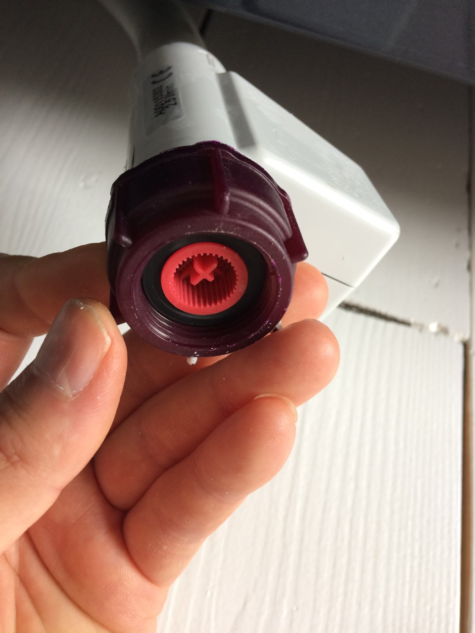

Thank you eta. I get hot water almost instantly. And it's for a dishwasher not WM, but guess that won't make any difference. The outlet is short too but I know how to extend that as I already have done so on my WM.

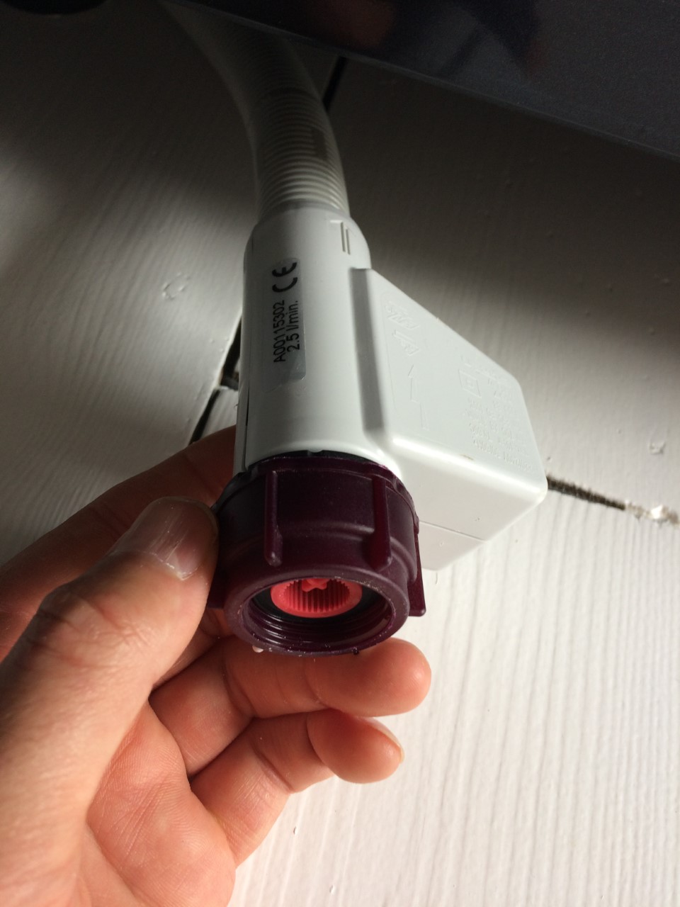

Sounds like the water supply hose has an anti flood device . Can you post pics of it here ?
Yes ,it is as I thought. You can still connect it to " normal" supply hose as you are considering. That would however ,to a degree, make the anti flood device partly redundant ,as its purpose is to close off the water supply should the hose inside it fail / leak.
The hose that you are introducing to extend would have no such protection .
You could consider extending the plumbing to a position where the dishwashers supply hose would reach.
Thank you terryplumb. So its' a good news and bad news. Unfortunately I can't extend the plumbing as there's no access to do so other than under the sink. Kitchen and the dishwasher are already fitted in.
In reality ,if the extension hose never fails or gets damaged ,you will never have a problem ! There are probably many tens of thousands , or more, appliances that do not have those anti flood hoses in use daily. I personally have never came across one of the standard hoses that has failed ,but I am sure there must have been some instances.
Any one else ever come across a failed hose ?????
My WMs never had any anti-flood device and neither has the new one. Never failed. But as they say... never say never! This anti-flood thing is new to me and I have never seen one before. I guess, as I have very limited options with the dishwasher, is to go for the straightforward extension.
Thank you for your advice.
The antiflood sensor is probably built into the base of the dishwasher and will shut off the water inlet valve in case of a leak.
I've been to some serious floods from washing machines (the drain hose came off the drum on one...and the machine attempted to fill for the best part of a day!).
Check the orientation of the inlet valve....AFAIR they should be vertical to avoid strain and the electrical connections becoming wet.
