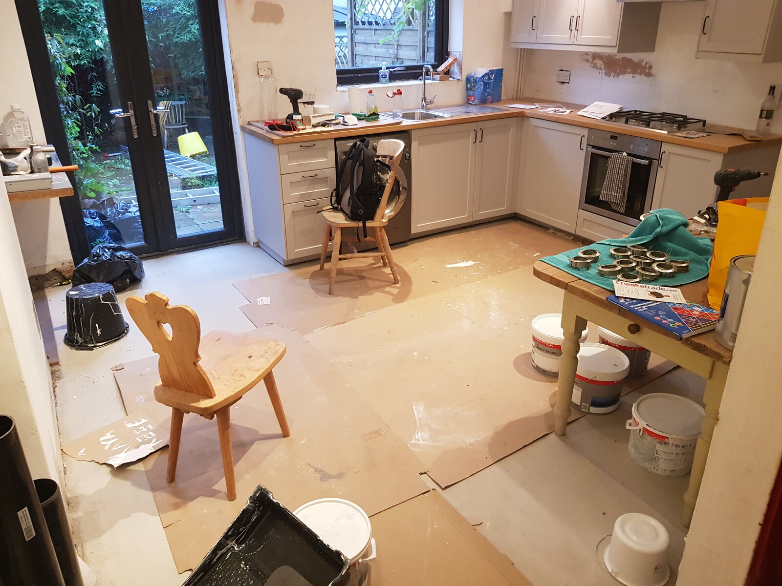

Hi
I fell out with the guy who was meant to fit my karndean floor in my kitchen. He said my floor couldn't be made flatter, and it had 8cm undulations. I levelled it with fibre self levelling compound from mapei, and now it's much better.
I have karndean opus planks. They reccomend using their adhesive. But Screwfix has a mapei one with good reviews, I'm guessing this will be fine?
My main confusion is how to lay it all out correctly, to look right and minimise waste. I've never done this before.
Any tips? Do I start from one side, or draw lines and start from the middle. I just can't really work it out.
The planks will go parallel to the worktop by the window and door in the photo.
I've never laid them, but from what I've read you might want to consider the optical effect. The room will tend to look longer in the length direction of the planks. Also, consider the visibility of joins, bearing in mind that the main room lighting will normally be daylight from the patio doors.

Thanks yeah uv looked on YouTube but not found anything great, especially about planning it out before sticking. Maybe I'm overthinking it!
The planks will look better laying towards the light source as the light will run down the length and less likely to show any cupping of the surface of the board. For a plank design, its common to center the design in the doorway looking forwards, for a tile design, center in the middle of the room and work towards the edges of the room.

Start down one wall. Cut in 4 rows then glue them in and keep going like that to the other side of the room.

Ok great thanks. I got a special roller to activate the adhesive once they are down, hopefully will help
Try and plan it so you don't have small slithers near the edges anywhere?

Have you checked the self leveller is flat? Mine had little bobbles from air bubbles I had to sand off
