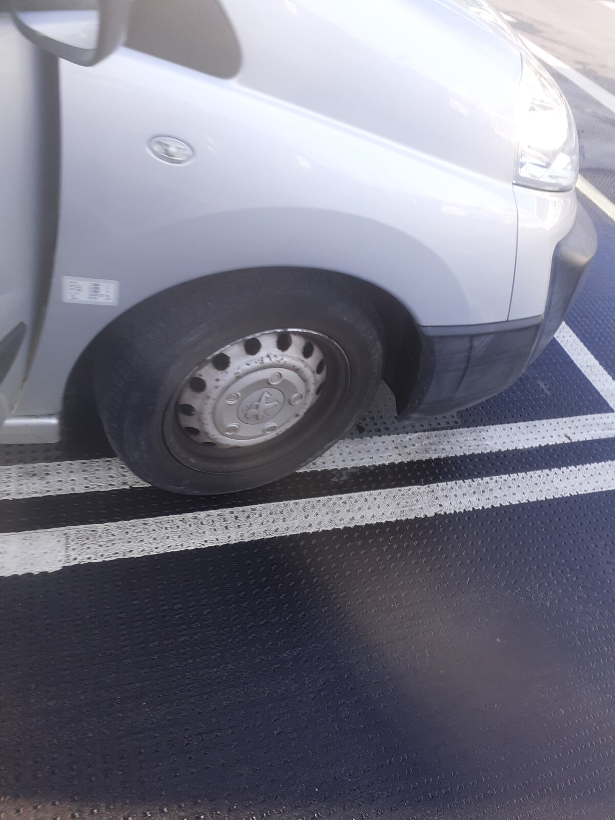

Pumped up my front right tyre a week ago to pressure 35 ,it looked flat so went to garage and it was 8. Slow puncture? Anyone recommend a mobile pump? My cigarette lighter isht working but maybe hook up to battery
Yup, slow puncture, or tyre not seating on the rim well and letting air by, or valve letting air by? I would spend your money on getting a local tyre fitter to sort it. You might be able to test the valve by getting a mixture of washing up liquid and water, dipping your finger in it, taking the valve cap off then wetting the top of the valve to try and form a bubble to see if a bubble forms and gets bigger. Have you hit the kerb with this tyre recently? Can you see if there's a nail in the tyre? How old is the tyre?

Check the valve then fit the spare wheel if the valve is ok......don't let the tyre go down to 8 psi there's a chance of rolling the tyre off the rim.

Very good advice B. If the spare looks a bit ratty or it's a space saver (narrower that the normal ones) you really have to get this sorted ASAP or it could be dangerous using the spare for anything but getting you to the tyre fitter (if the tyre is the issue).
If it’s started losing air only since you pumped it up, there’s a good chance you’ve pu,ped a bit of grit or dirt into the valve which is stopping it sealing. Check the valve first as others have suggested, pump it up then let some air out of the valve and that should blast any dirt off of the valve seat. Make sure you fit the dust caps - that’s what they are there for as well as being a secondary seal.
It looks like a Peugeot Partner or Expert so should have a spare wheel.
In a rusty cradle under the back, with a seized and rusty hook holding it in place. Brilliant!
I bet the spare is flat anyway....!

The wheel doesn't look very old and rusty. Examine the edge of the rim for dent damage. Leaky valve or puncture is easy to find, use a garden sprayer of water and WUL and look for bubbles
You mustn't drive on it flat.
A scrapyard may sell you a steel wheel and tyre for a very modest price.
If it has a spacesaver under the boot you will be able to fit a standard steel wheel. Oil the threads on the bolt before you start as it will be rusty and seized.
