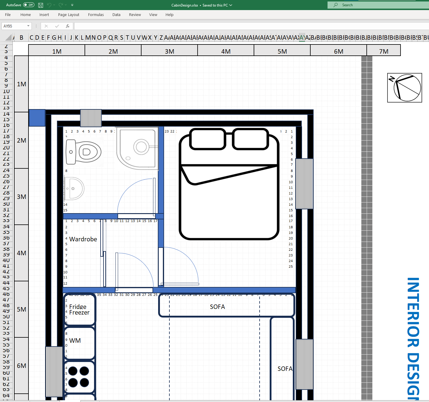

Mate, I am nothing anywhere near a pro builder and this might sound crazy but I use excel. I am probably going to get ripped to shreds for posting this but I don't care. I have built many things, designed in excel. This is my biggest yet.
