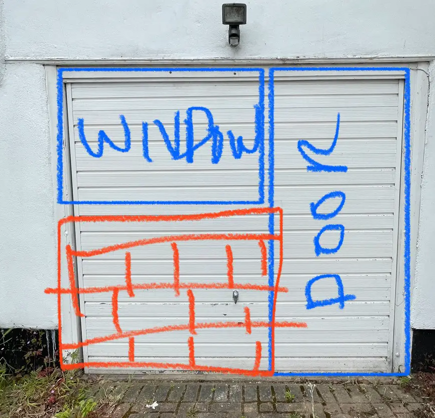

D da3533 Joined 16 Sep 2014 Messages 141 Reaction score 5 Location Essex Country 30 Jan 2024 #1 Hello i understand a 1m or so foundation is needed under a wall... but what about under the door... do i need to dig out a trench for the whole width even there is not much load under the door? see pic.
D Diver Fred Joined 25 Apr 2016 Messages 2,531 Reaction score 582 Country 30 Jan 2024 #2 Yes, dig to same depth and width; foundation needs to be continuous.
D da3533 Joined 16 Sep 2014 Messages 141 Reaction score 5 Location Essex Country 30 Jan 2024 #3 when filing with concrete, do I have to do it all at once … can’t it be in sections? Lot of work to mix it all
