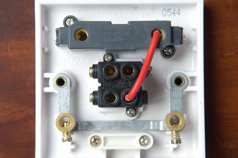

I need to wire up an appliance to a fused socket (on a ring circuit) in Hong Kong (see photo). We have the same wiring and electrical standards here as in the UK.
Currently, the 2 mains blue and brown wires are inserted into the the N and L 'IN' terminals. I assume the blue wire from my appliance inserts in into the L LOAD terminal at top left (ie the grey bar). I assume also that the brown wire from the appliance inserts into the L In terminal at top right. Then the earth into the relavant earth terminal. My question is: what happens with the red wire running currently from the L IN terminal to the L LOAD terminal? Do I remove it or does it share L IN terminal with the brown wire?
Thanks for any help.
[GALLERY=media, 45769][/GALLERY]

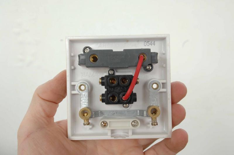

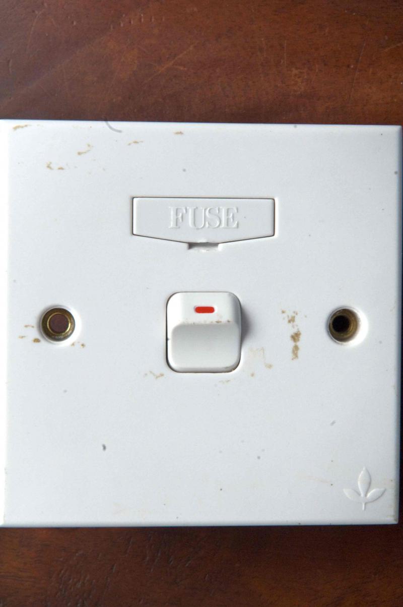

Not sure what the proper terminology is for these things, but its what my (Chinese) electrician called them so perhaps something was lost in the translation. I'll attach a photo of the front which should make it clear. Also a higher res photo of the back which will hopefully show the various markings. I have already installed a couple of these things without problem but they are another brand and are configured differently (among other things, no red wire).
I am of course not an electrician but the number of choices here is limited and attaching a couple of wires to a terminal is not exactly brain surgery, so I'd prefer to do it myself rather than pay someone 50 quid for a 2 minute job. Many thanks for any help. [GALLERY=media, 45786][/GALLERY] [GALLERY=media, 45787][/GALLERY] [/img]

On your central switch block, incoming live and neutral to top pair of connections, outgoing cable live connected to left hand fuse connection and outgoing neutral to bottom left on switch block. Earths connected to either of the earth terminals.
