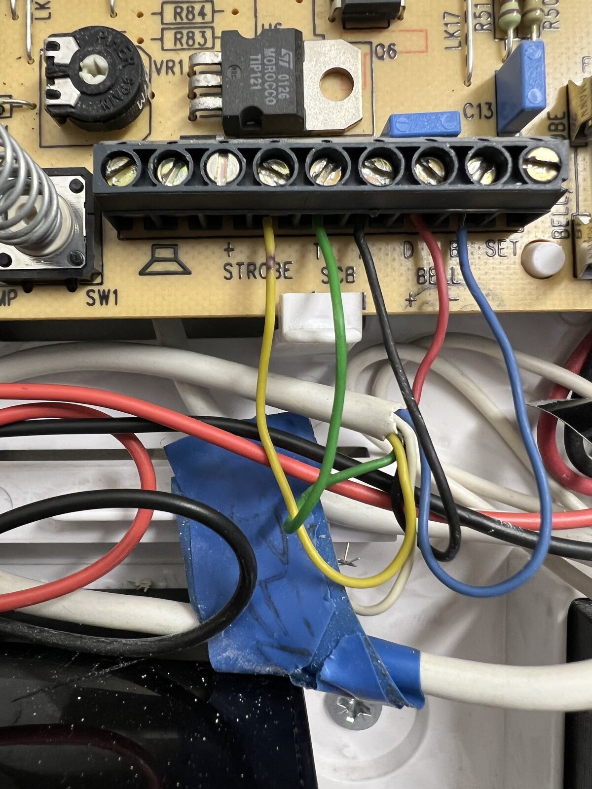

Hi there,
I've fitted a Deltabell X G3 to my Accenta G3 Mini.
I'm having a problem with the Tamper.
The bell box works perfectly well when the alarm is triggered using a door or PIR. But if you open the front cover to the alarm panel for example, the sounder in the key pad goes off but the bell box doesn't.

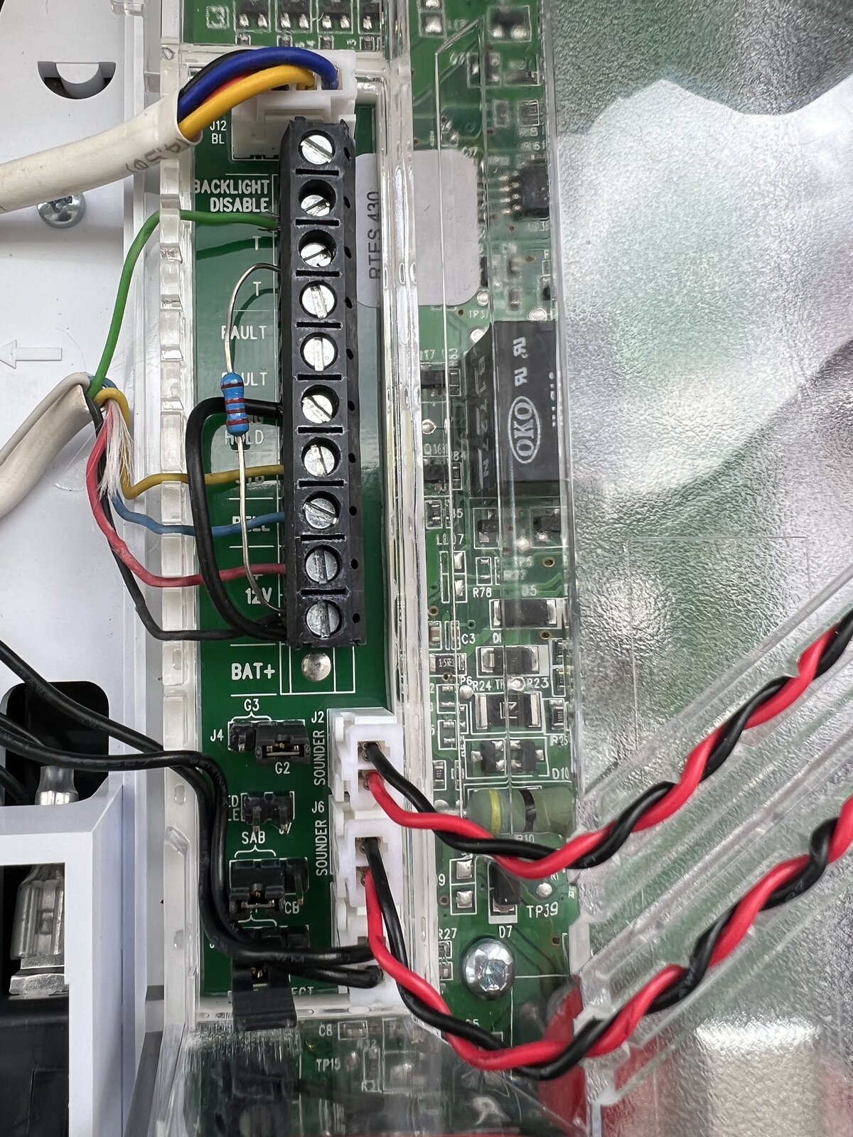

I recently fitted a Pyronix Deltabell X G2 to my parents house which works no problem, but the Delatbell G3 has an extra 2 "Fault" connections and I'm not sure if there should be a link or maybe a resistor ???
Can anyone shed any light on this for me please ???
Thanks in advance
Craig
The connections in my Accenta G3
The connections in my Deltabell X G3
The panel front tamper isn’t related to the bell fault connections.
like most panels the panel lid tamper does not trigger the bell box unless the panel is programmed for such.
so I would check that in the manual first.
Ahhh, ok.... I'll have a look in the manual....
Many Thanks for you help (again) :-)
Remove the link ??? I thought that stopped the bellbox sounding when you open the lid and the panel is in engineers mode ???
Craig
Didn’t see that in the photo until I zoomed in thought it was a shadow ….need my eyes testing or stop using the phone.
For the bell to know that the panel is in engineers mode, then it would need to be wired to an output on the panel that changes state when in engineers mode.
you can manually stimulate this if you don’t have a dedicated output by moving the connection in the panel. Not many use it as a result.
It should not be permanently wired as you have it as it would be a conflict between normal operation and engineers hold off.
Then I will have it removed.
Much appreciated guys, enjoy the rest of your weekend.
