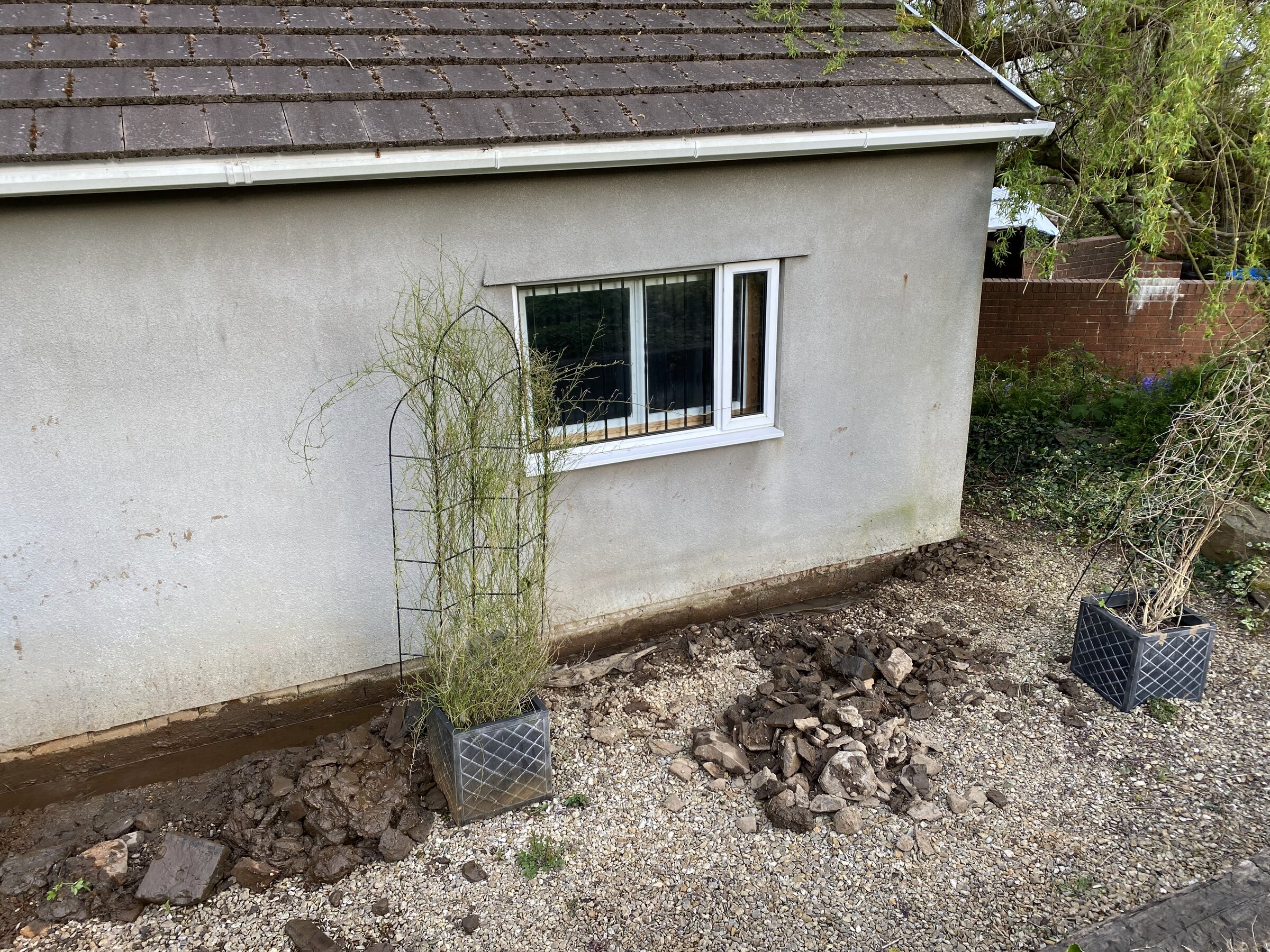

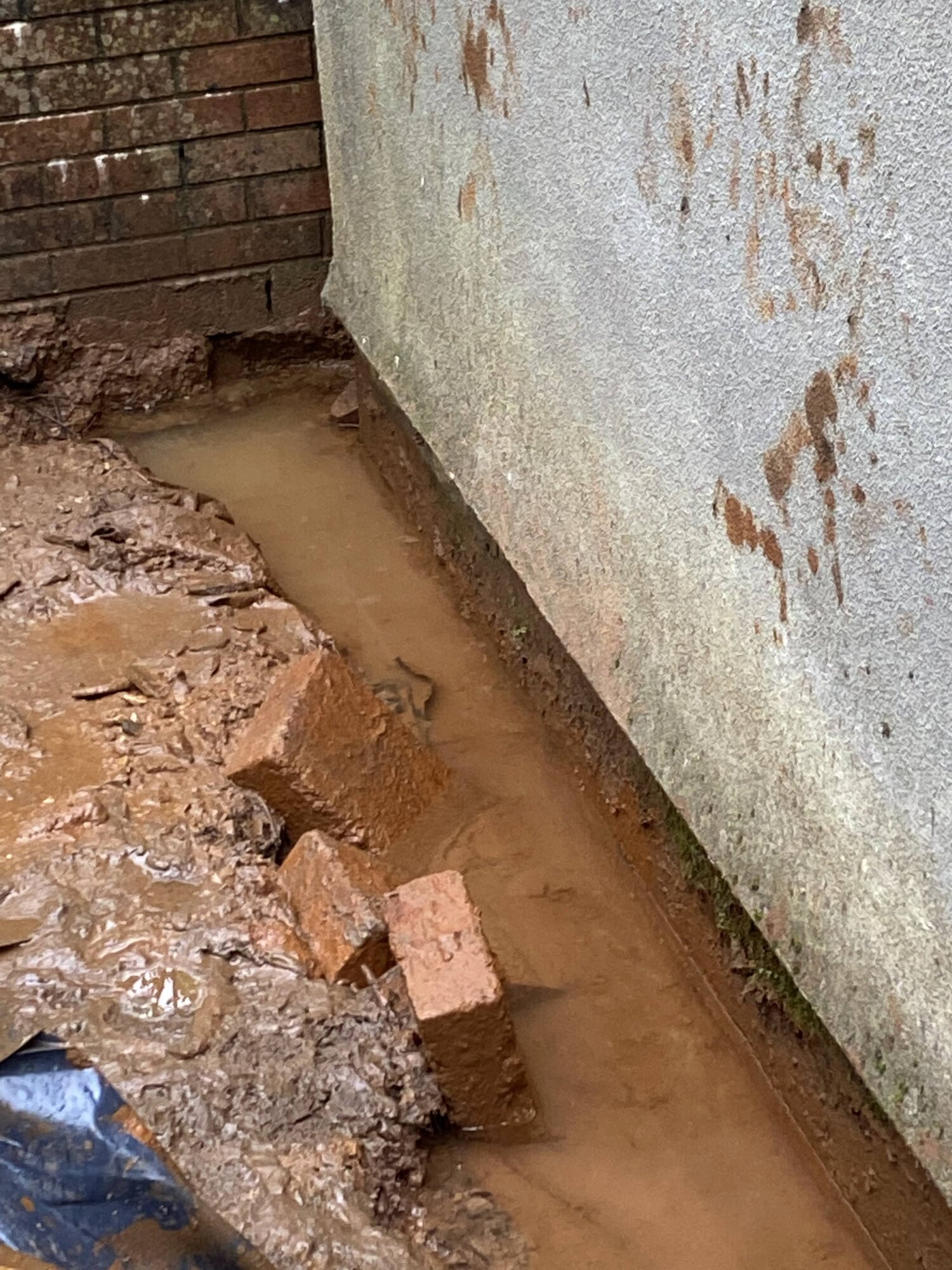

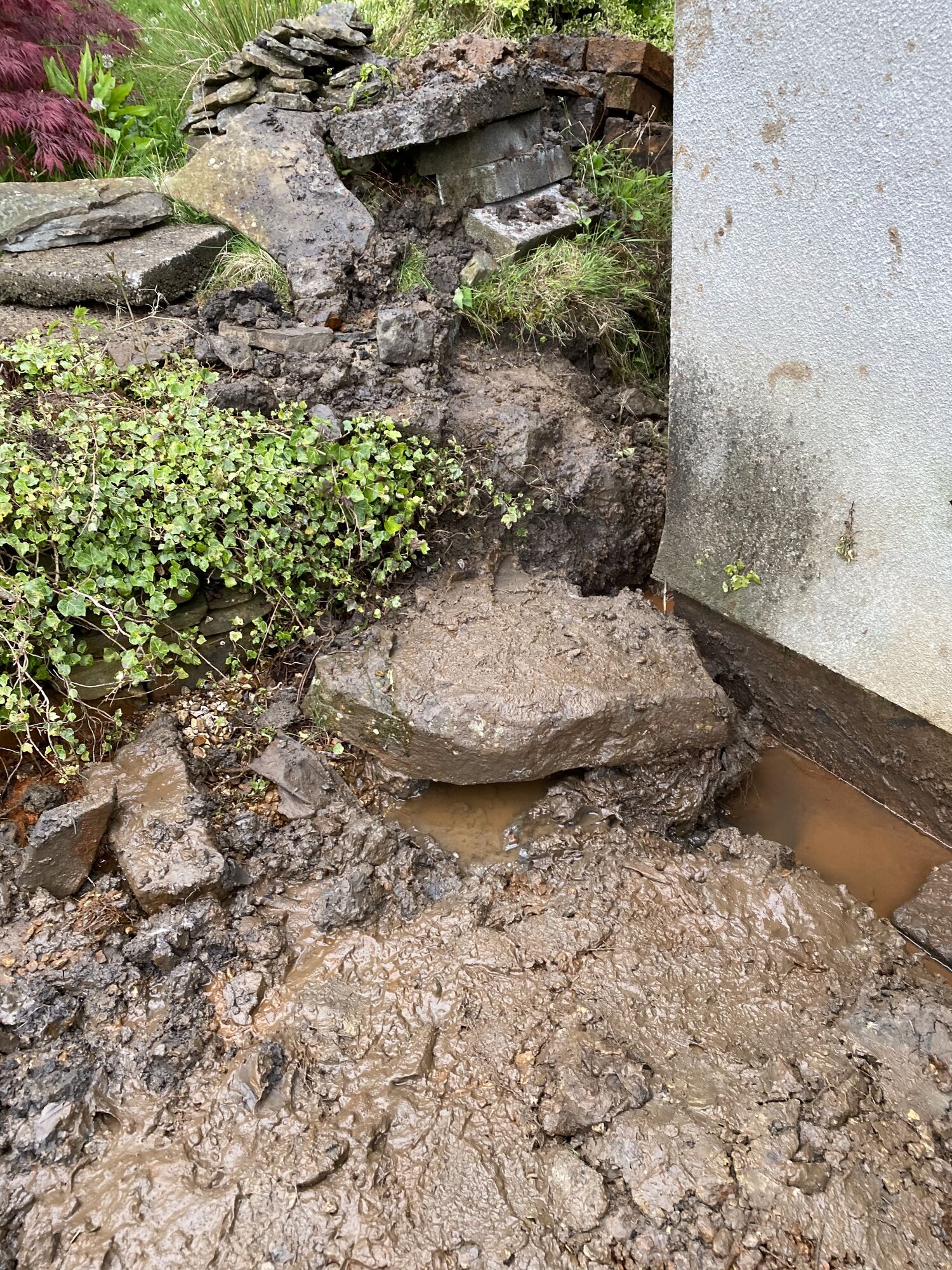

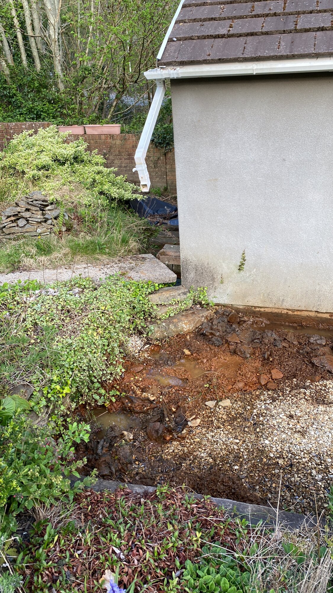

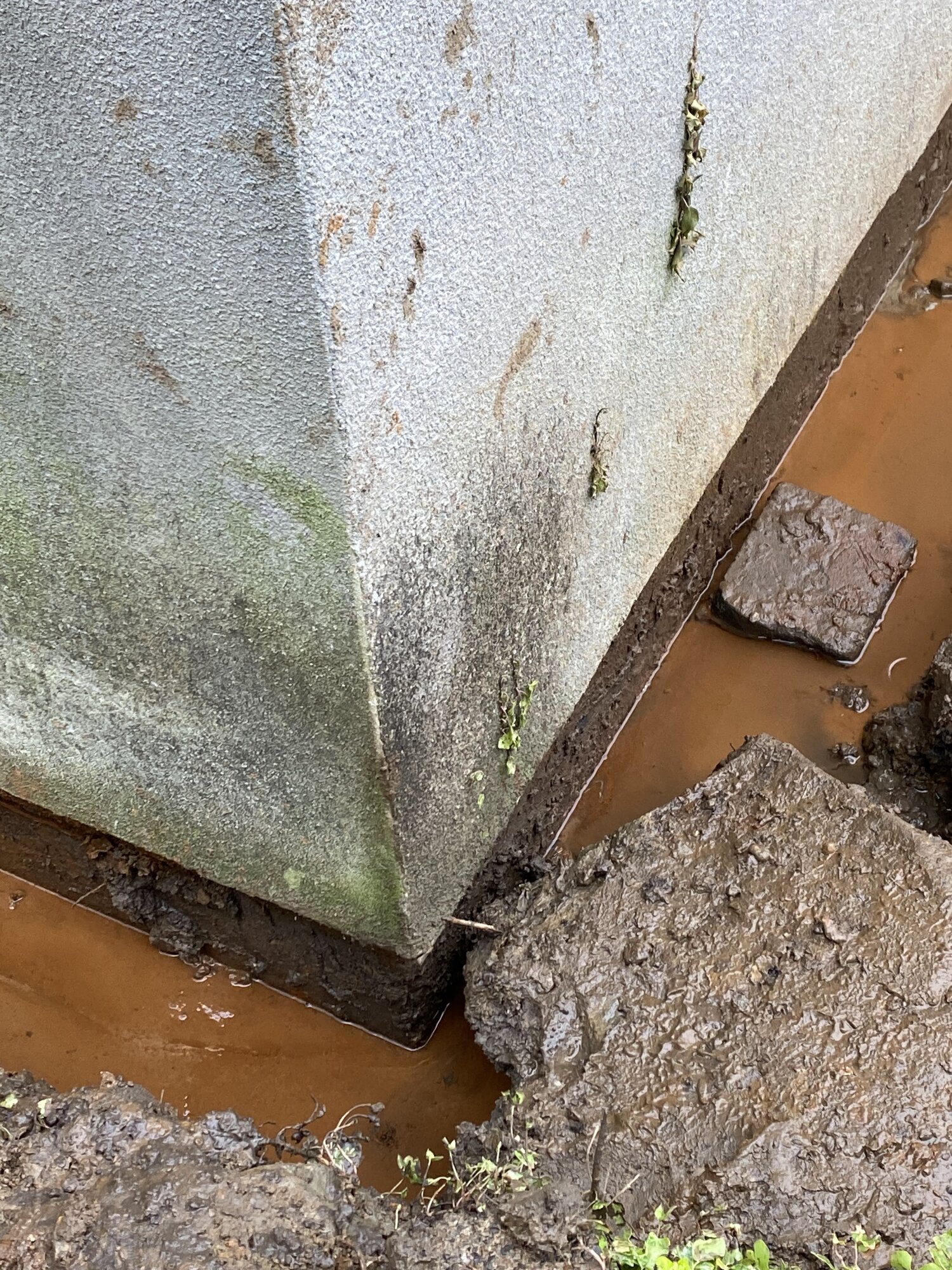

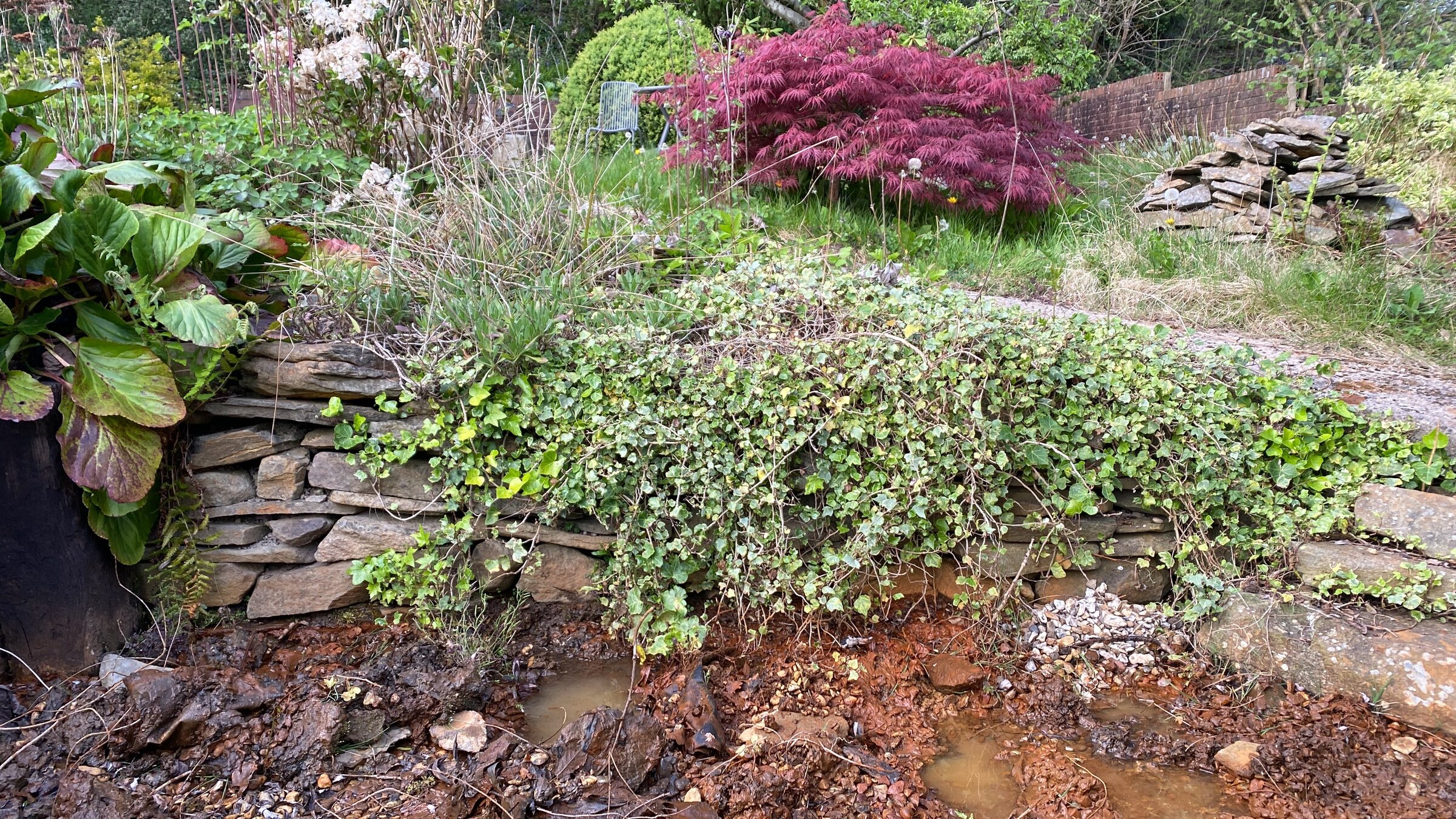

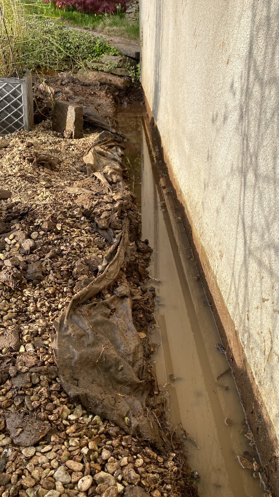

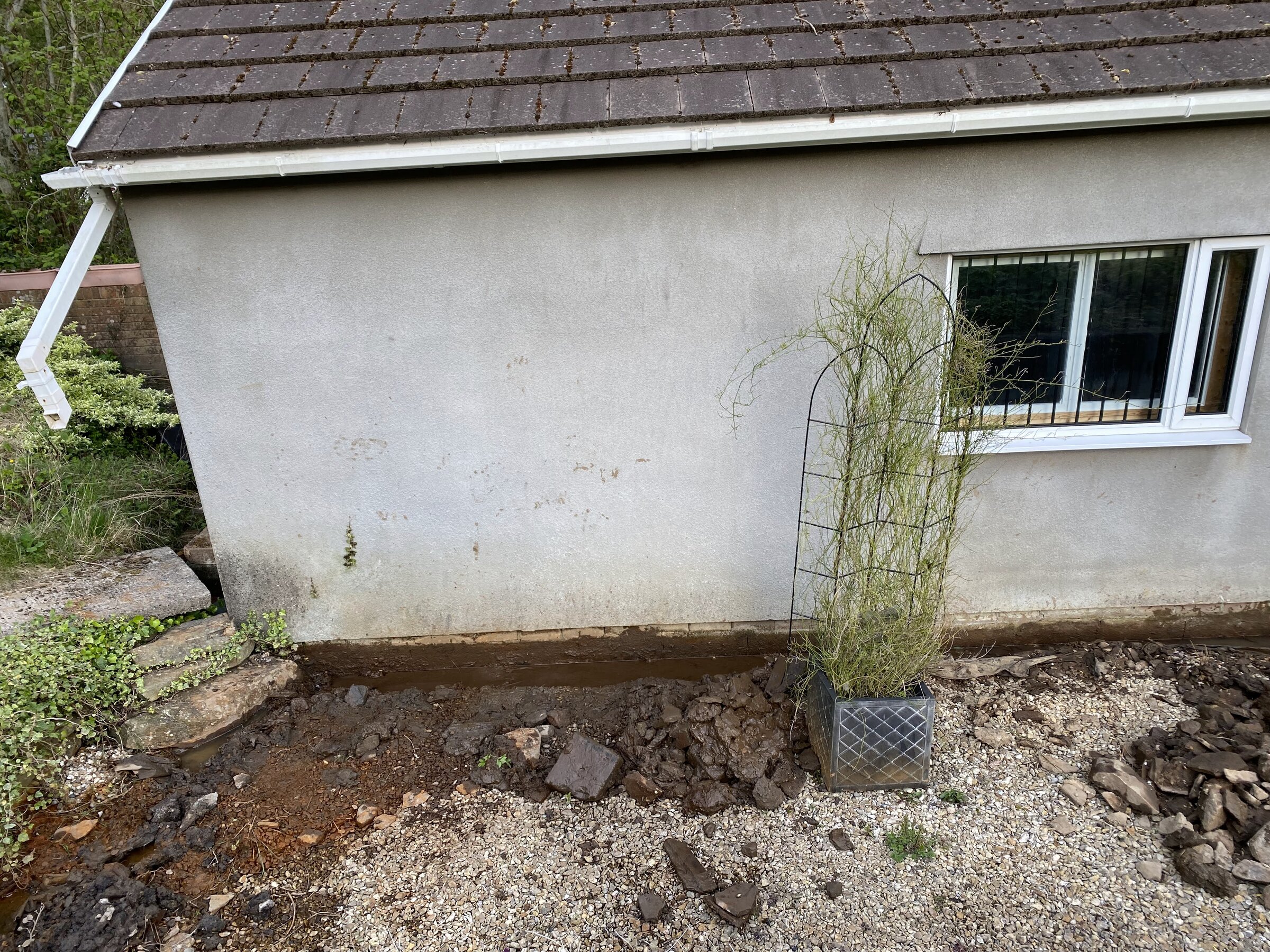

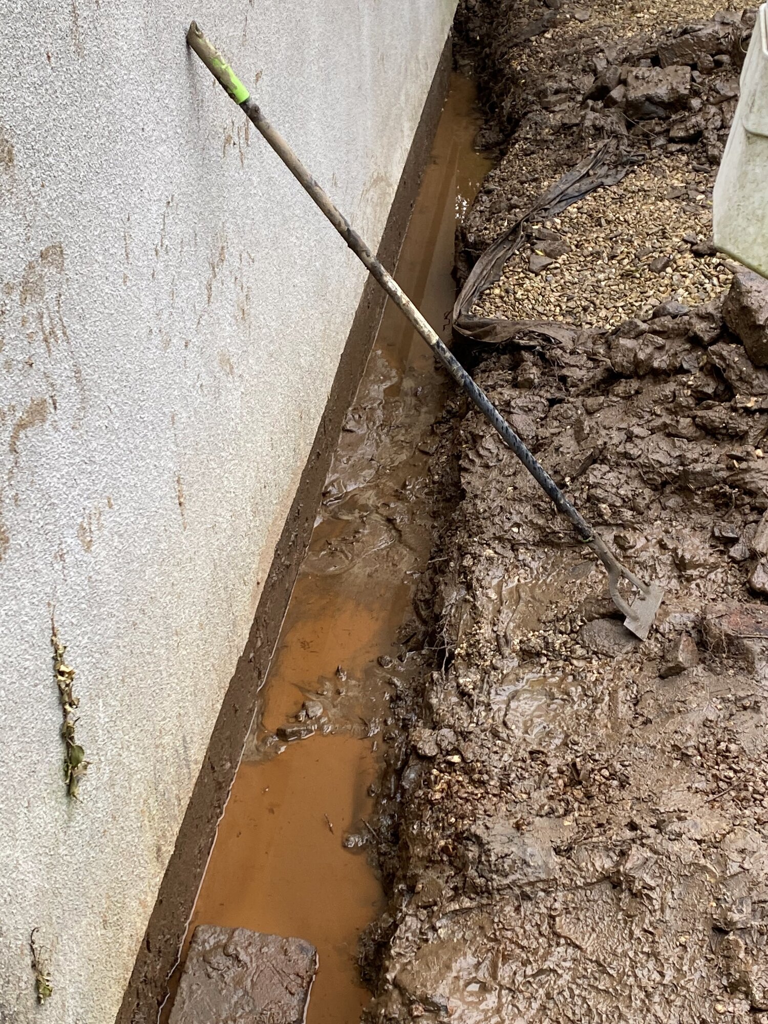

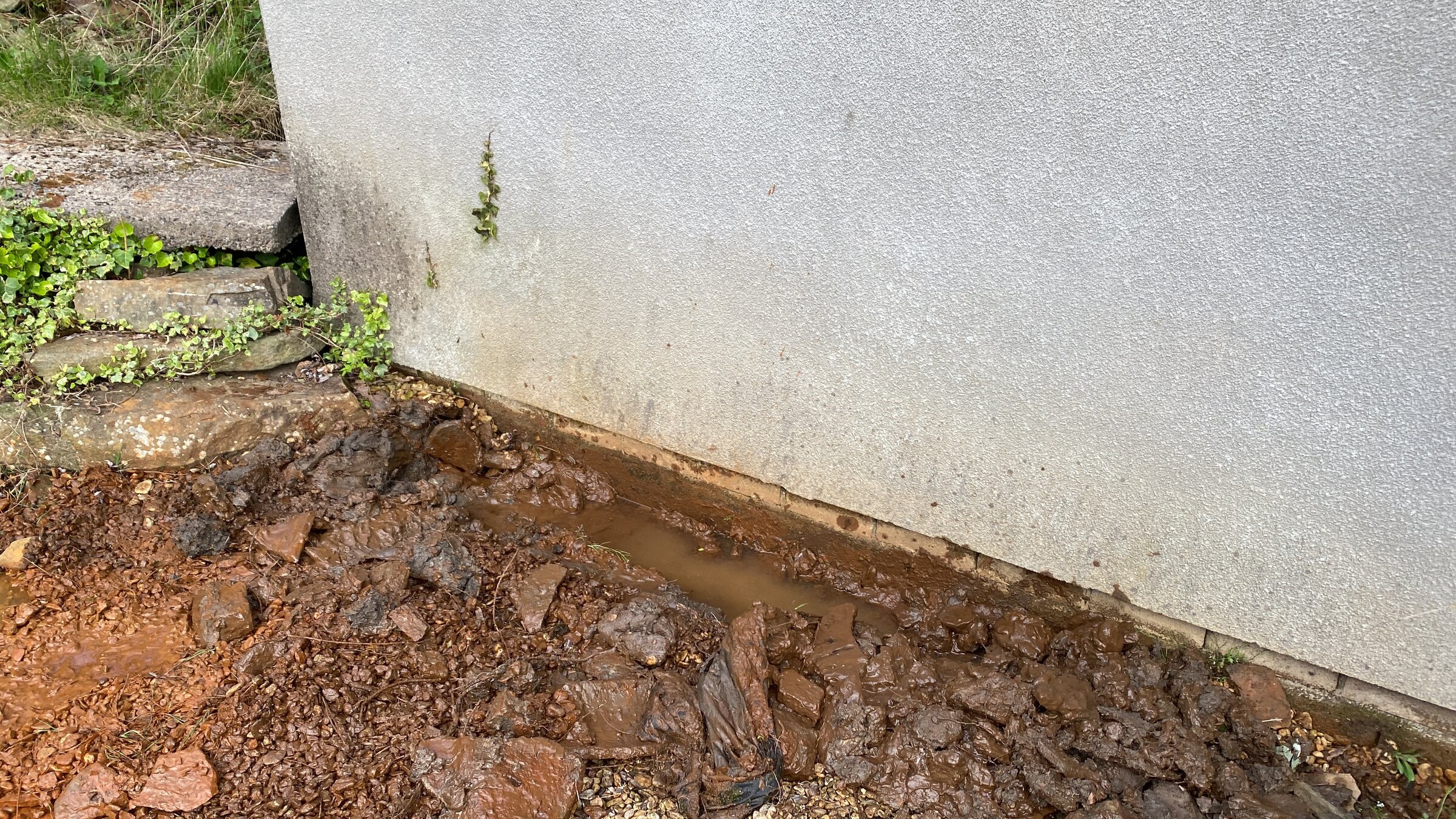

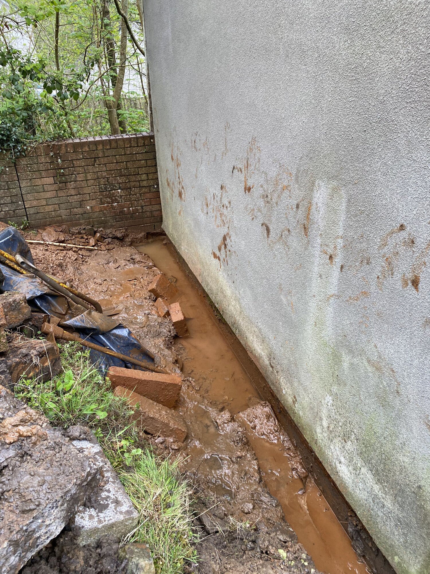

We have a buidling in the garden that my ASD son uses when relaxing. However, the previous occupants of the house seem to have neglected the drainage.
I have dug down into the gravel that is alongside the perimter of the building and can see that I'll need to do more; namely put in some drainage below the ground and make sure there is an adequate fall to move the water off the property and into a nearby stream.
I'm thinking about a french drain constructed of:
1, PVC perforated pipe
2. Round gravel of adequate size
3. A non-woven, perforated membrane.
My question is related to the soil and membrane - based on my apparent soil type should I be concerned about clogging? Will clogging lead to the drain failing with me having to dig it all up again?
http://www.landis.org.uk/soilscapes/# tells me that the soil in our area is apparently soilscape 6 - loamy.
http://www.landis.org.uk/soilscapes/soilguide.cfm
That said, the soil seems like clay when digging. And as we live in an area where there was once a mine, I think the orange soil is a clear sign of iron pollution.
I've been researching french drains on youtube but there is disagreement about plastic perforated pipe vs pvc, and also on the use of membranes. I have even read some people debating gravel (angular vs round).
Has anyone faced a similar issue with standing water? How did you tackle the issue?
Thanks in advance.
Edit: please ignore the drain pipe. It is only there temporarily. I'll also put in a proper downpipe and dedicated pipe to take that water away - it won't be left to fall onto the ground directly to add to the surface water.
