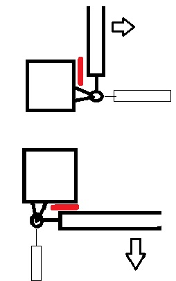

Just a quick question. I am about to source a 5 bar gate for my drive and want to fit an electric opener to it.
If using gate automation, is it better to hang the gate on the face of the post in line with the gates or on the face at 90 degrees to the gate i.e. on the back of the post. The gate needs to open just over a right angle e.g 110 degrees. I was going to use a cantilever opener rather than a ram similar to this unless anyone advises against these.

That told eric ! On the rear a larger opening plus you can get your 110 degree depending on operator type

May be not a qualified professional but a person experienced in ( or able to evaulate ) the dangers that powered entrance gates create. Crush zones next to the hinge being one of the most often overlooked dangers. The crushing force at the hinge end of a gate is many times the force at the far end of the gate where the "maximum safe" force is calculated.
Totally agree but isn't the magic eye beam across the gates the safety interlock which is supposed to stop this happening. The gates should not close if the beam is broken by an obstruction such as a child?
