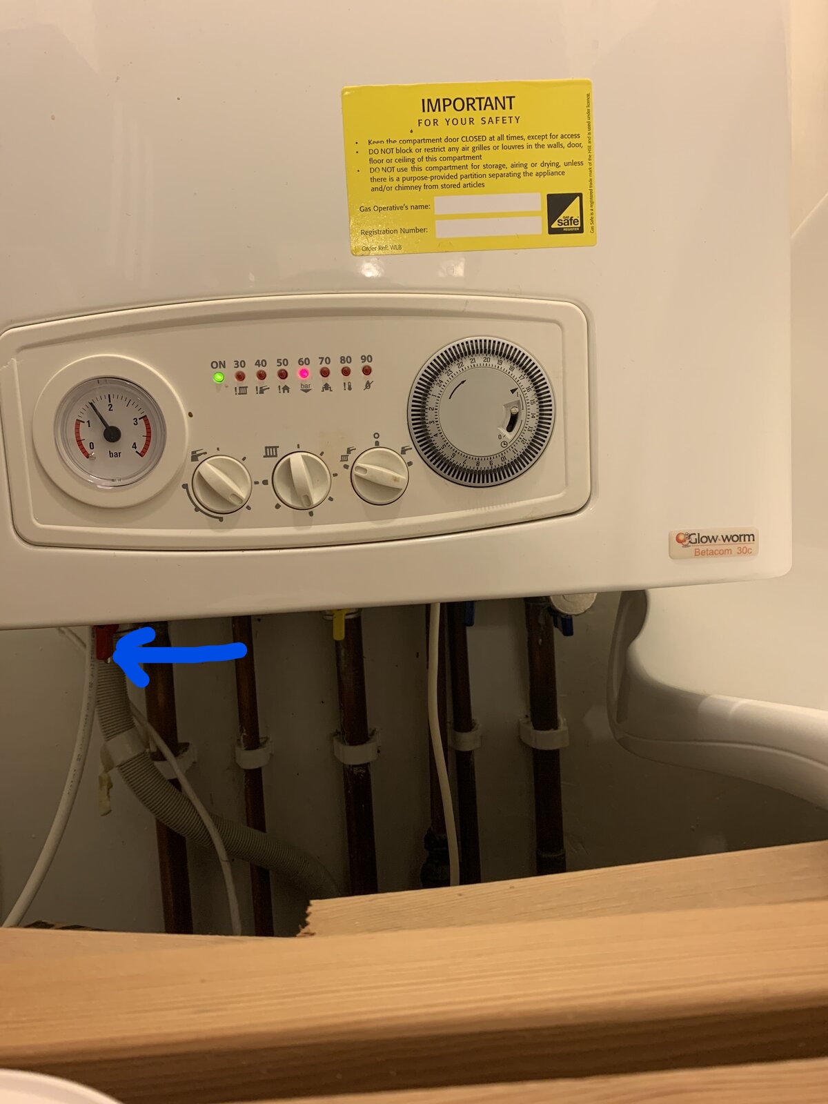

Catalin16 Joined 1 Nov 2021 Messages 3 Reaction score 0 Country 1 Nov 2021 #1 Put pressure up to 1.6 ..still doesnt’t start . 60 bar light keeps going on and off Any help please ?

ianmcd Joined 15 Aug 2010 Messages 29,100 Reaction score 17,156 Location Livingston Country 1 Nov 2021 #2 Turn right hand control knob to 0 (12 oclock position) then tirn back to CH and HW position, does it now reset ?

ianmcd Joined 15 Aug 2010 Messages 29,100 Reaction score 17,156 Location Livingston Country 1 Nov 2021 #3 That looks like a water drip there on the System flow isolating valve, if it is, then probably why your system pressure dropped in the first place

Catalin16 Joined 1 Nov 2021 Messages 3 Reaction score 0 Country 1 Nov 2021 #4 I have reset it and still nothing happens. The dripping was minor …really small .i dont think it was enough for the pressure drop . The drip is gone . What else should i try? By the way thank you very much for the reply.

mcmoby69 Joined 19 Jun 2011 Messages 8,011 Reaction score 3,593 Location Lancashire Country 1 Nov 2021 #5 If you've been topping up often, the pressures sensor will be full of crud and not telling the pcb the correct pressure.

Catalin16 Joined 1 Nov 2021 Messages 3 Reaction score 0 Country 1 Nov 2021 #6 Iast time i did top up was at least 2-3 months ago
ianmcd Joined 15 Aug 2010 Messages 29,100 Reaction score 17,156 Location Livingston Country 2 Nov 2021 #7 try taking the cold pressure up to 2 Bar when cold and see if the boiler resets, you can lower the pressure again by releasing pressure from a rad bleed valve or drain point
